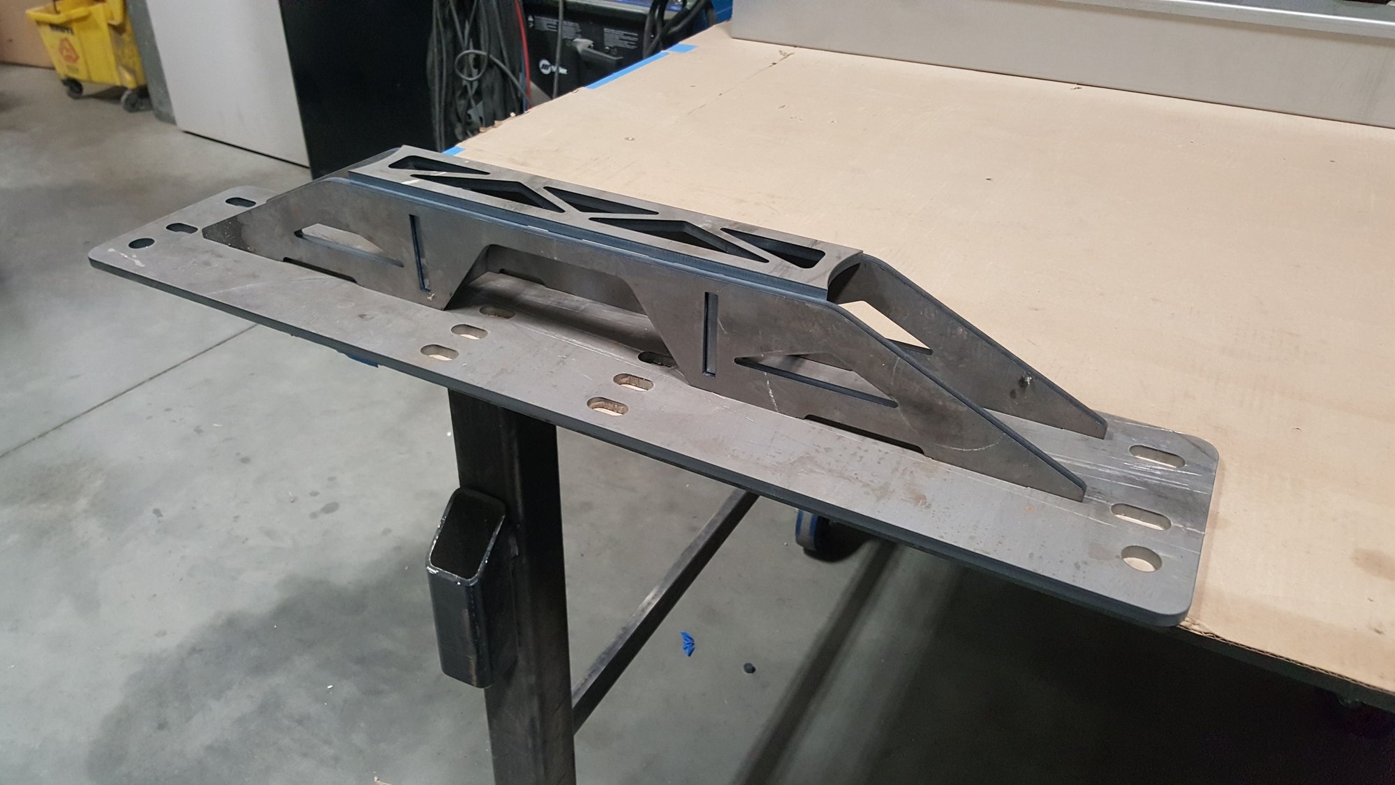

The start of Flatbed V1.0. I drew it all up in Solidworks, and cut it on our Laser, and formed it all on our pressbrake.

Got the hitch all welded in.
Airbag mounts on.
And of course, we have to test out the airbags right??? Rougly 6,000lbs of Garnet (sand) on there.
Headache rack done and welded on.

Then, to get back onto the flatbed, I wasn't happy with the hitches "backbone" so I remade it. All 3/8" steel plate, keyed together and mig welded. Needless to say, way unnecessarily overkill!

Then I built an extension for the flatbed. Specifically so that I could fit our 2 seat Can-Am x3 on the back. It slid into the receiver and then 2 bolts at the top located it. It worked well, but was very heavy and a 2 man job to install.
Redesigned my lower airbag mount to utilize the u-bolt spring plate. Made the lower half be the u-bolt plate, and then a top half captures around it, supplying the mounting flange for the airbag itself.
