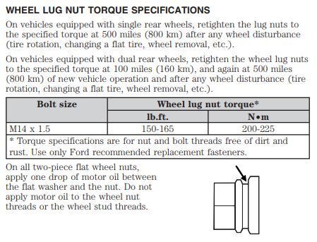

Years back had a casual conversation with mechanic at Costco. I said that when I rotate tires I take a damp rag with WD-40 and clean my threads prior to installing and torquing lug nuts. He explained that even WD-40 acts as a lubricant and the specific TORQUE specs are for metal to metal. Telling me in am over torquing due to the lubricant.
Any others think about this?

yes
nuts and bolts have different torques for dry vs lubed threads.

Yep, no lube on lug nut threads.
It is ok to put a drop of oil between the nut and washer though.
This detail was in the manual for my 2004 Super Duty, but I cannot find it in the manual for my 2020 Super Duty. Is this no longer necessary, an oversight in the newer manuals? I still apply the drop of oil.
