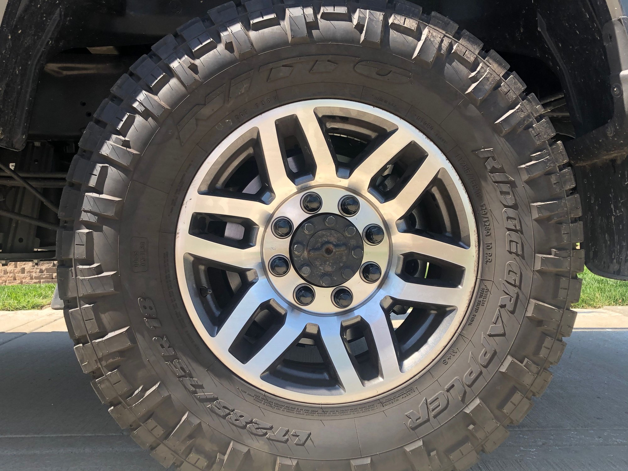

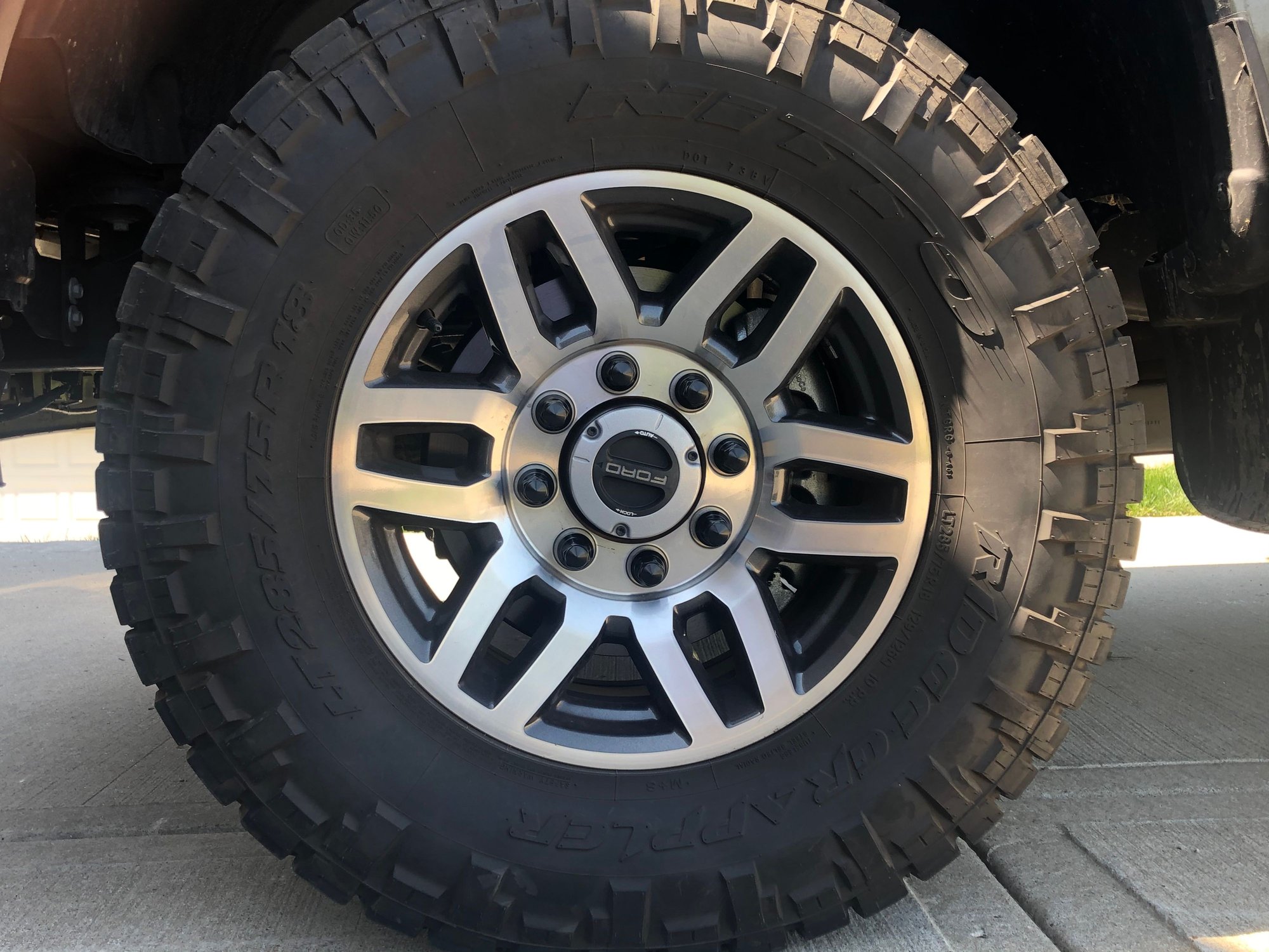

https://www.coyoteaccessories.com/lugs/lug-nuts/86k848
I got a set of these in black for my 2019 F250. These are damn nice lugnuts. And they look better than the big chrome center cap to me.
Old Sep 4, 2020 | 07:11 PM
  #34
jjmoberg's Avatar
jjmoberg
Joined: Jul 2016
Posts: 80
https://www.coyoteaccessories.com/861148blk
Those are what I have in the above pictures
I like the way this looks. I have the machined cast 20s. It doesnt look great with the stock lugs and no chrome hub cap... But almost. Yours look right with the black lugs. Funny I just rotated Thursday and almost left the hubs off after banging hell out of one front one that wouldnt go on all the way. I dont mind the way the hub caps look but they suck to put back on. I rotate at 5,000 miles and did 3 rotations since new. The stock clad lugs are holding in there but the 13/16 socket is tight. Each nut is a pain to get loose from the socket. They are crap but I dont torque them down with the air gun.
I snug them with the gun then torque them with a torque wrench.
[Post Edited by Maxium 4x4]
Hopefully I can find lugs made here... Ill hold out until my lugs are trashed.
By the way your wheels look great without the hub caps. Next rotation Im leaving mine off too...
Not worth the black and blue pinky...
