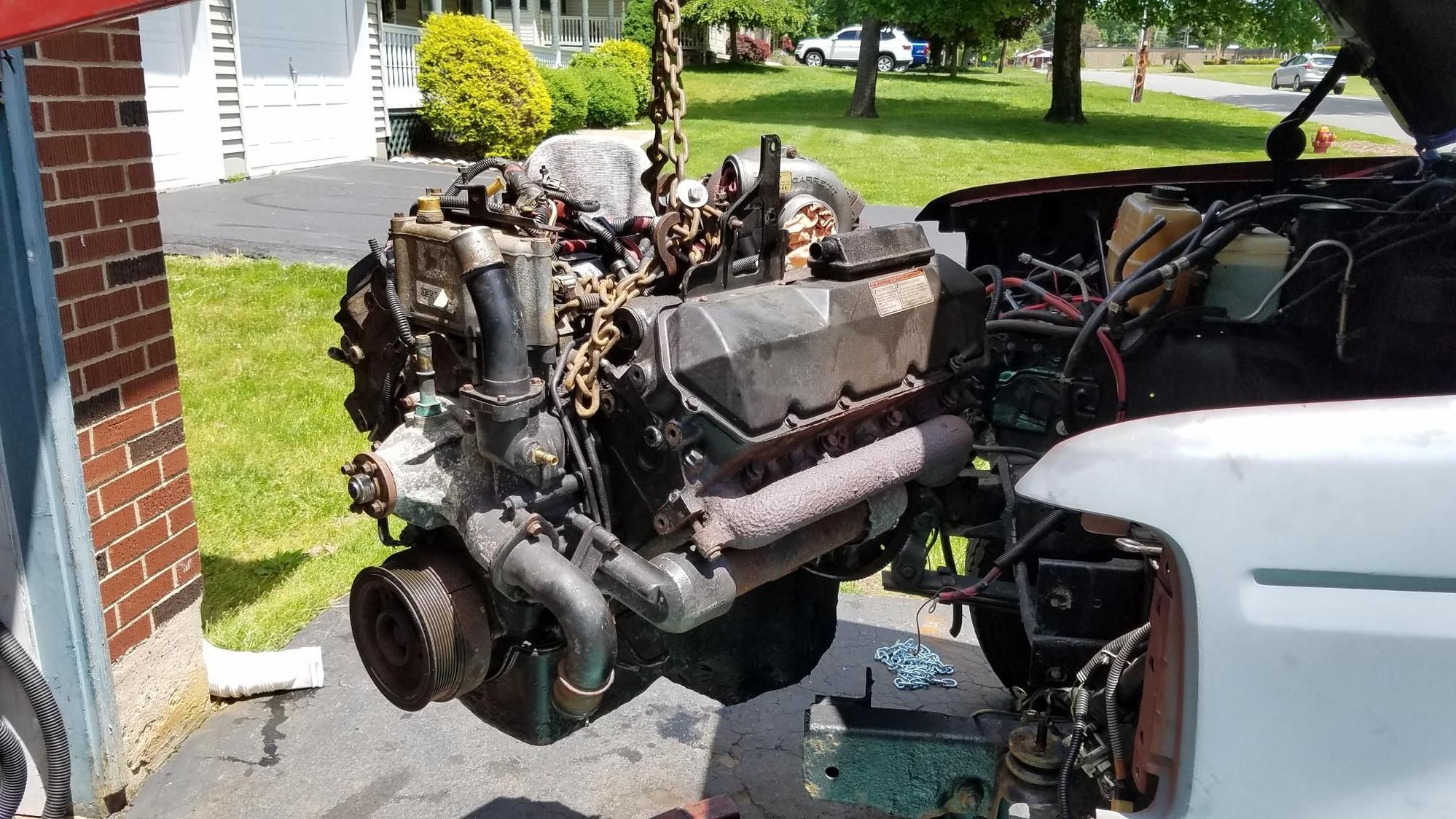

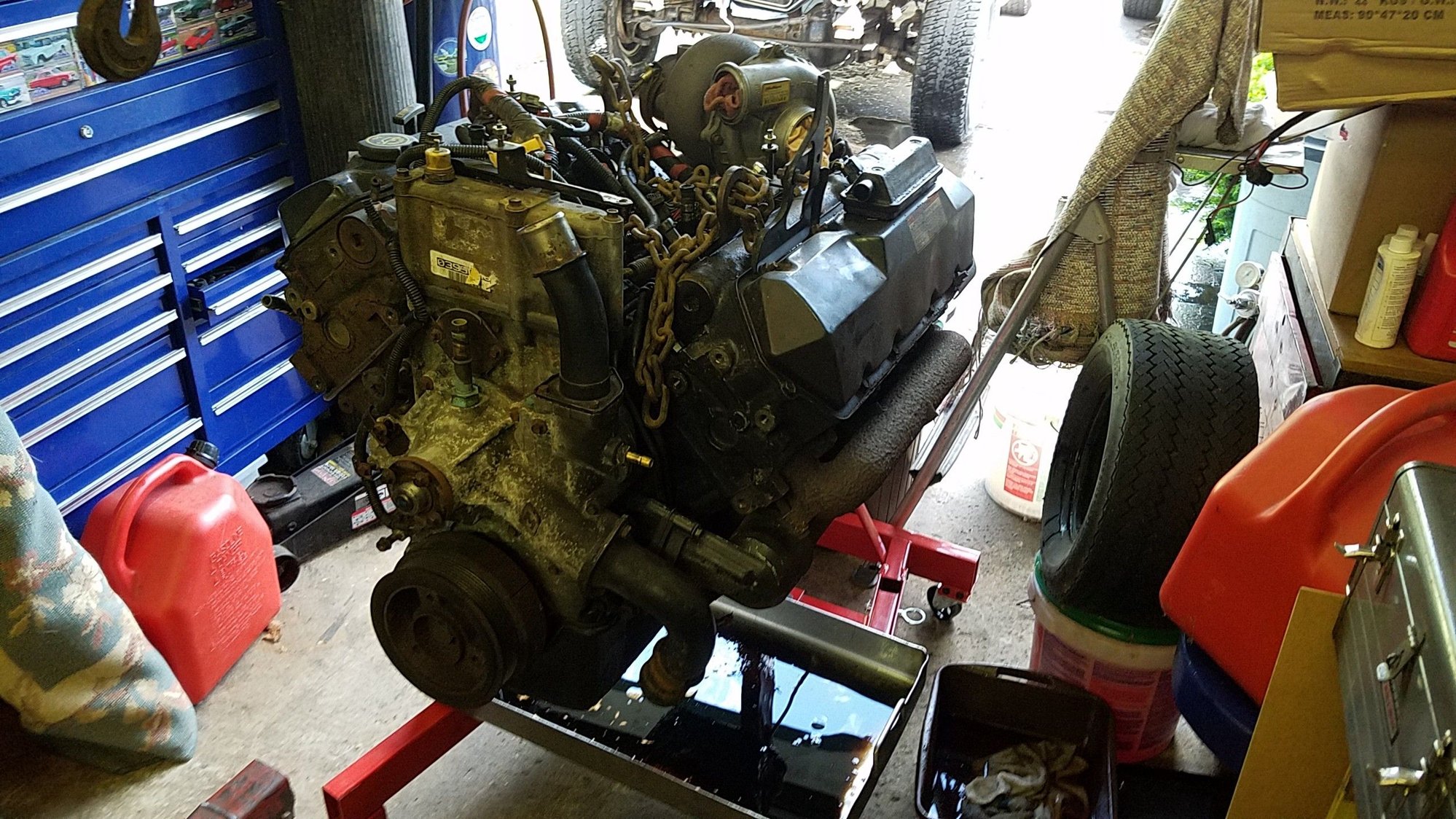

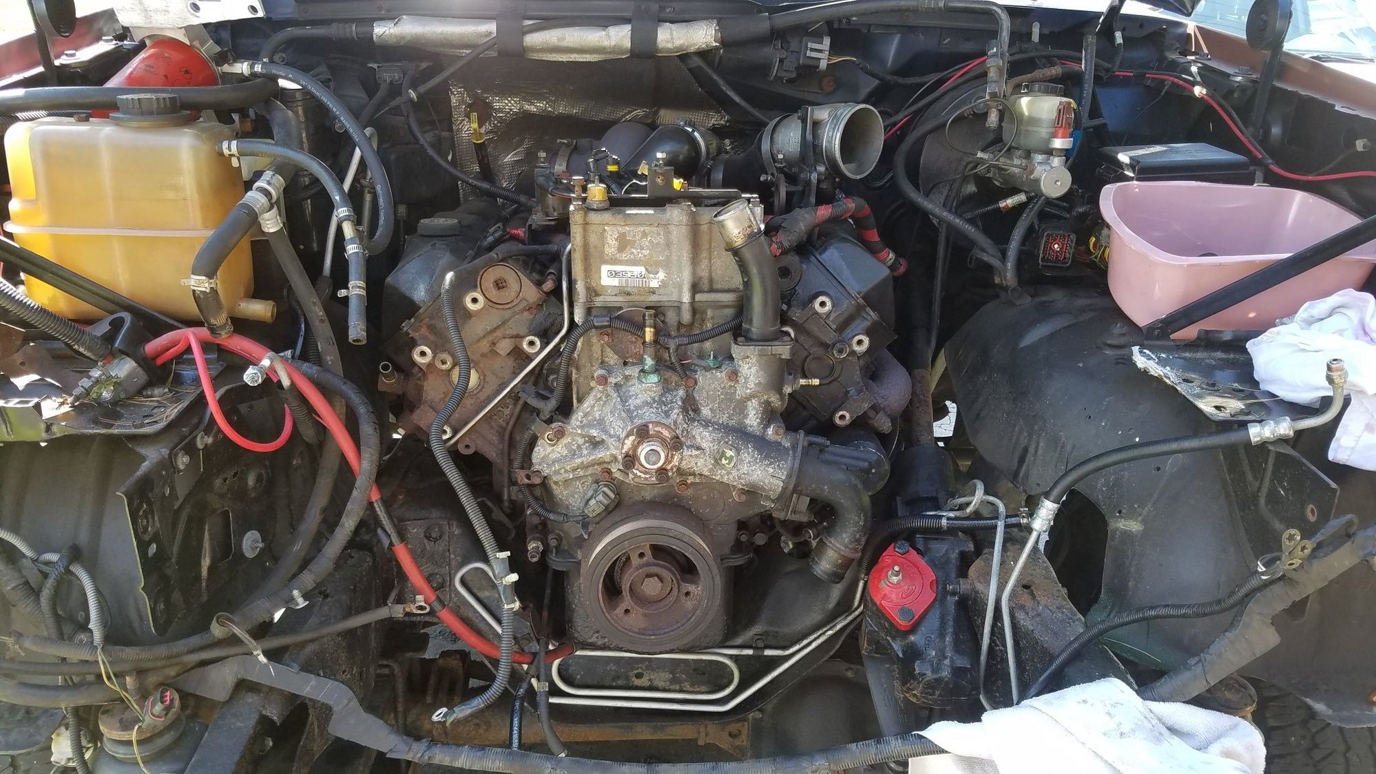

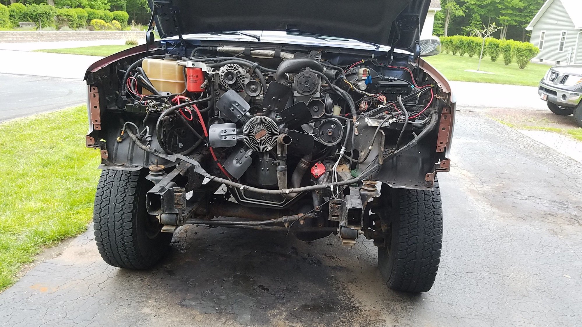

Hey guys,
Well we finally decided to pull the engine out to fix the darn oil pan before we put some paint on her. Trying to do a full reseal, up pipes, turbo mods and efuel.
Should be fun! Some beginning pics:
