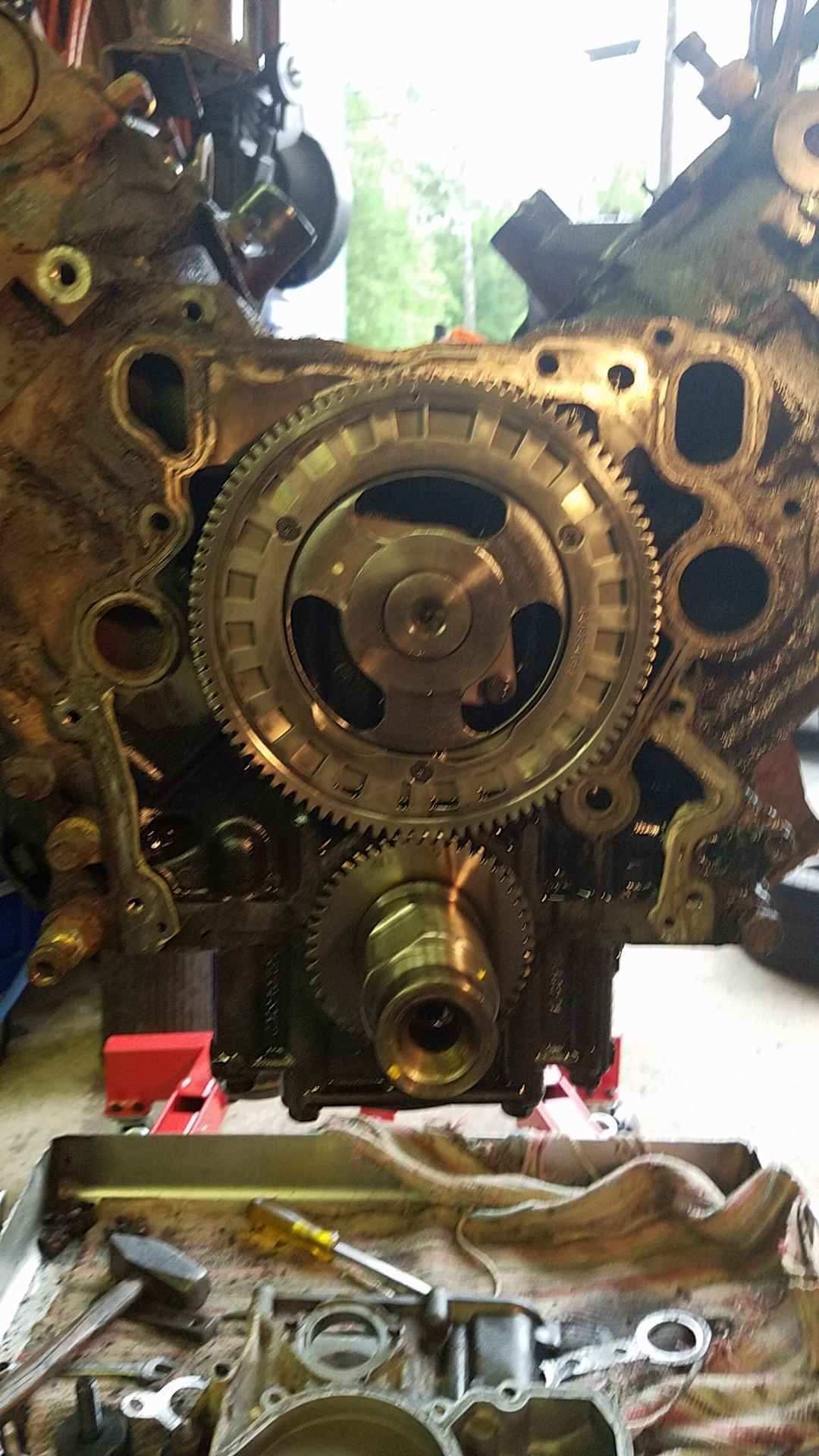

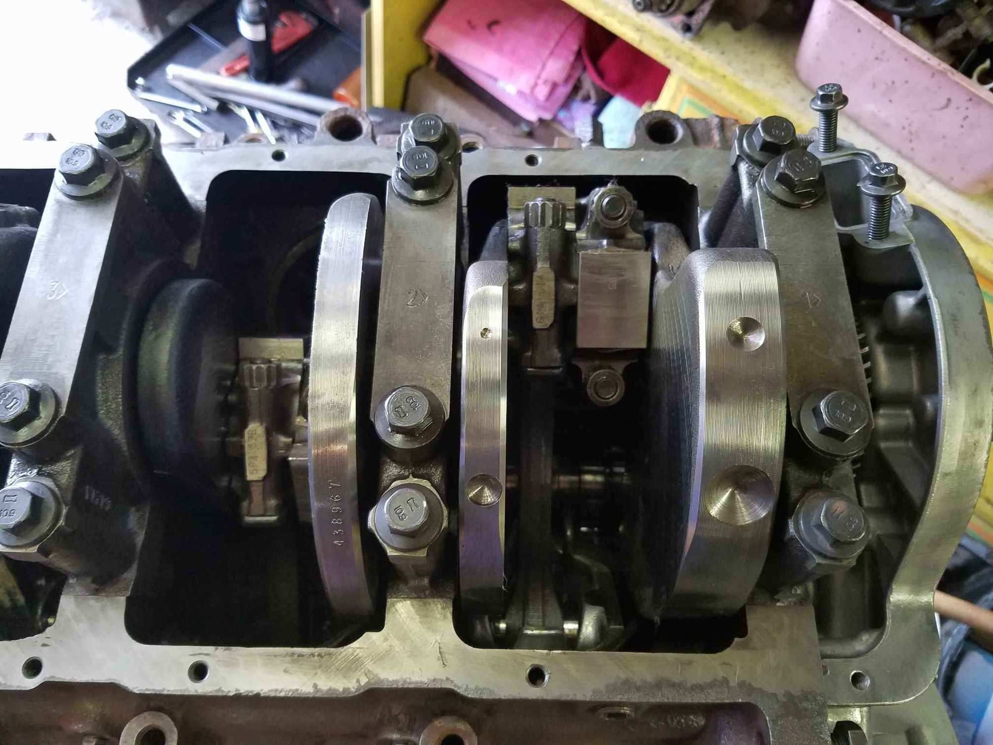

Just dropping in some pics for fun

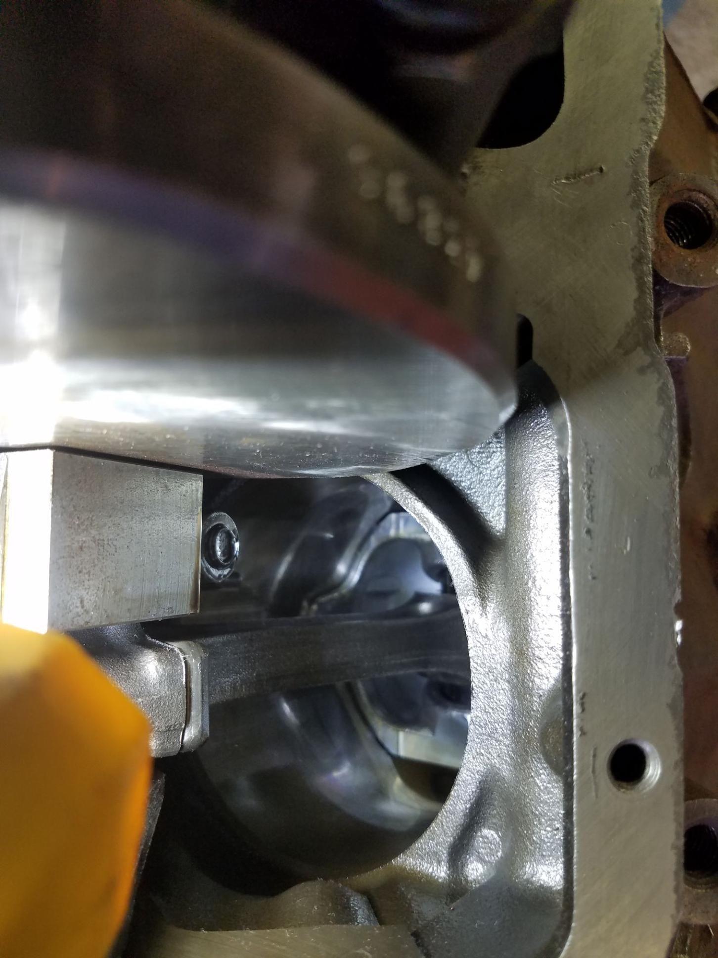

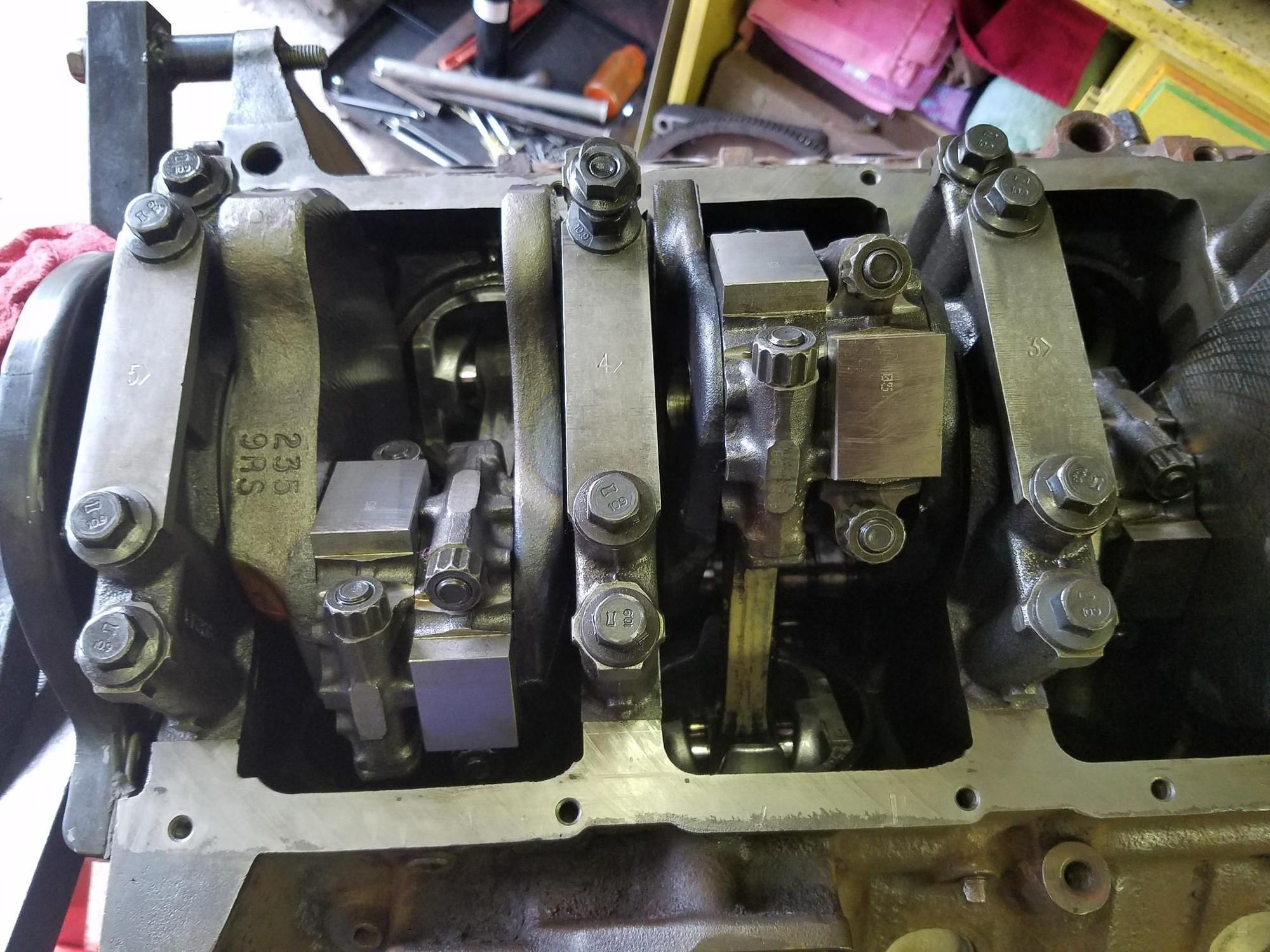

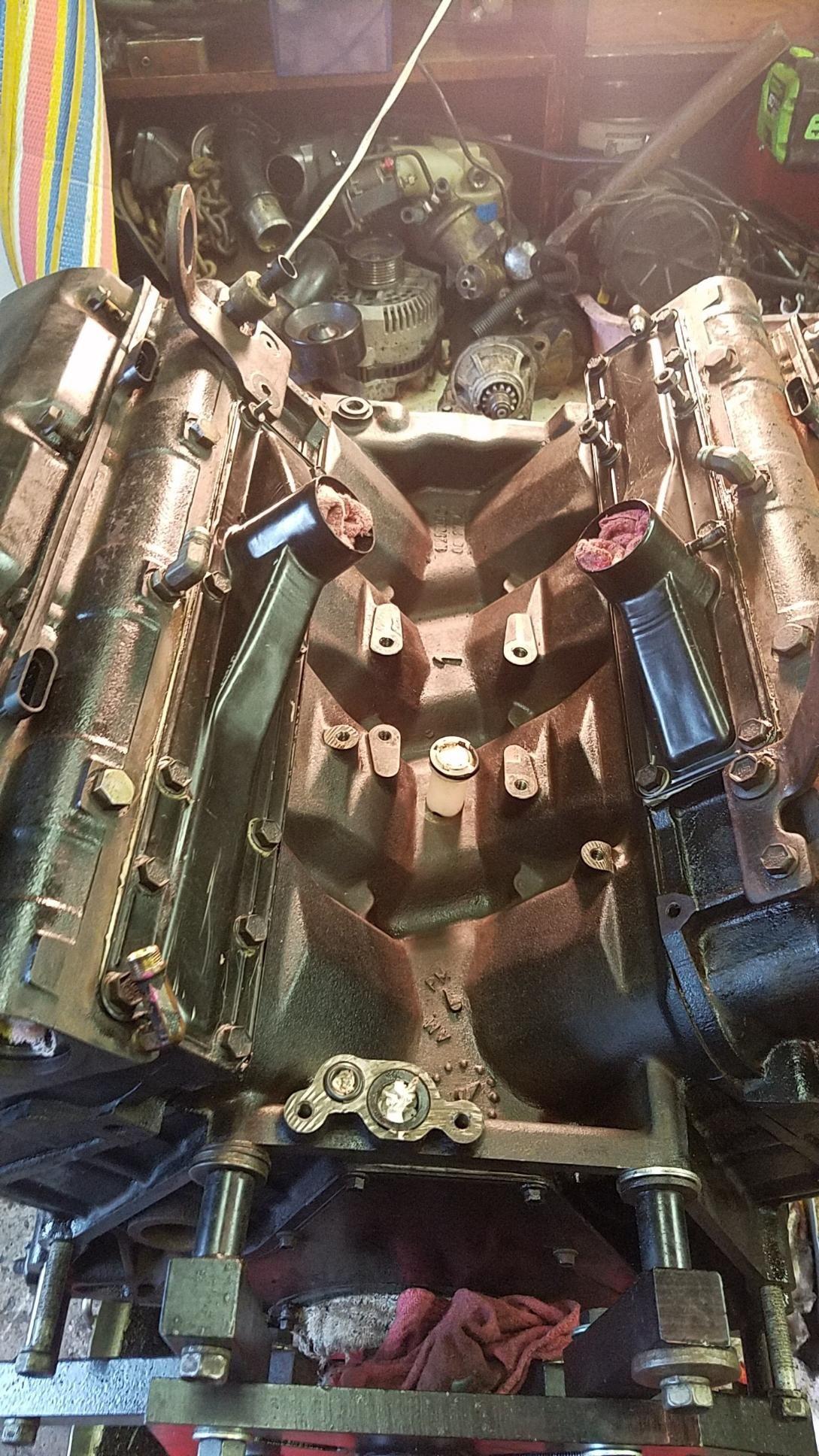

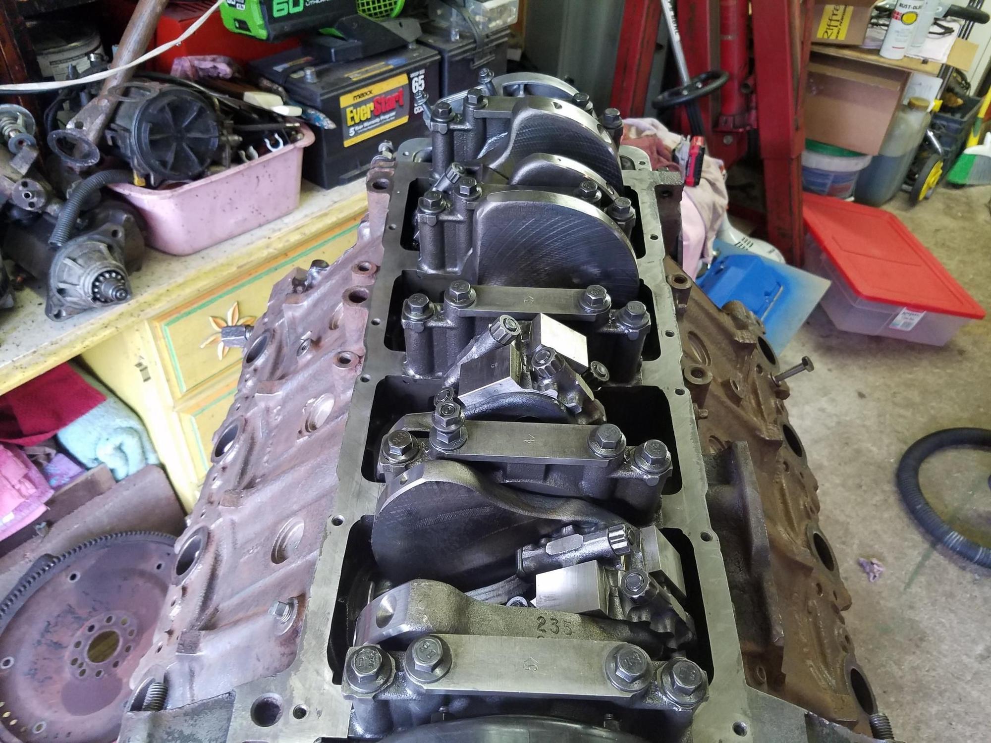

Just updating with a few pics, flipped her over and will be putting the pick up tube back on and get the pan sealed.

I would take the time to look into the scores in the cylinder wall in the last photo, run your fingernail across them, how deep are they

Im not sure I could put it back together knowing those scratches were there
