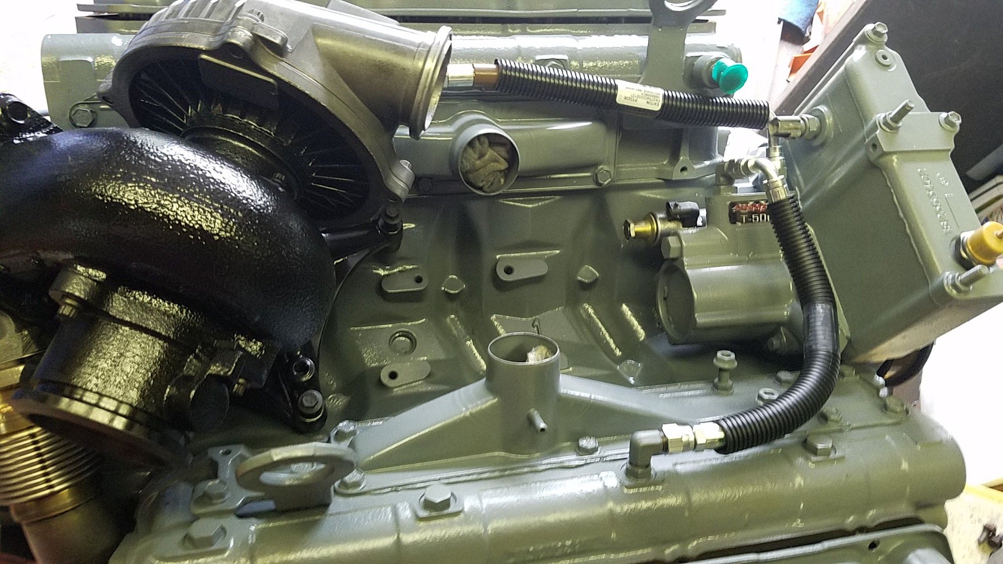

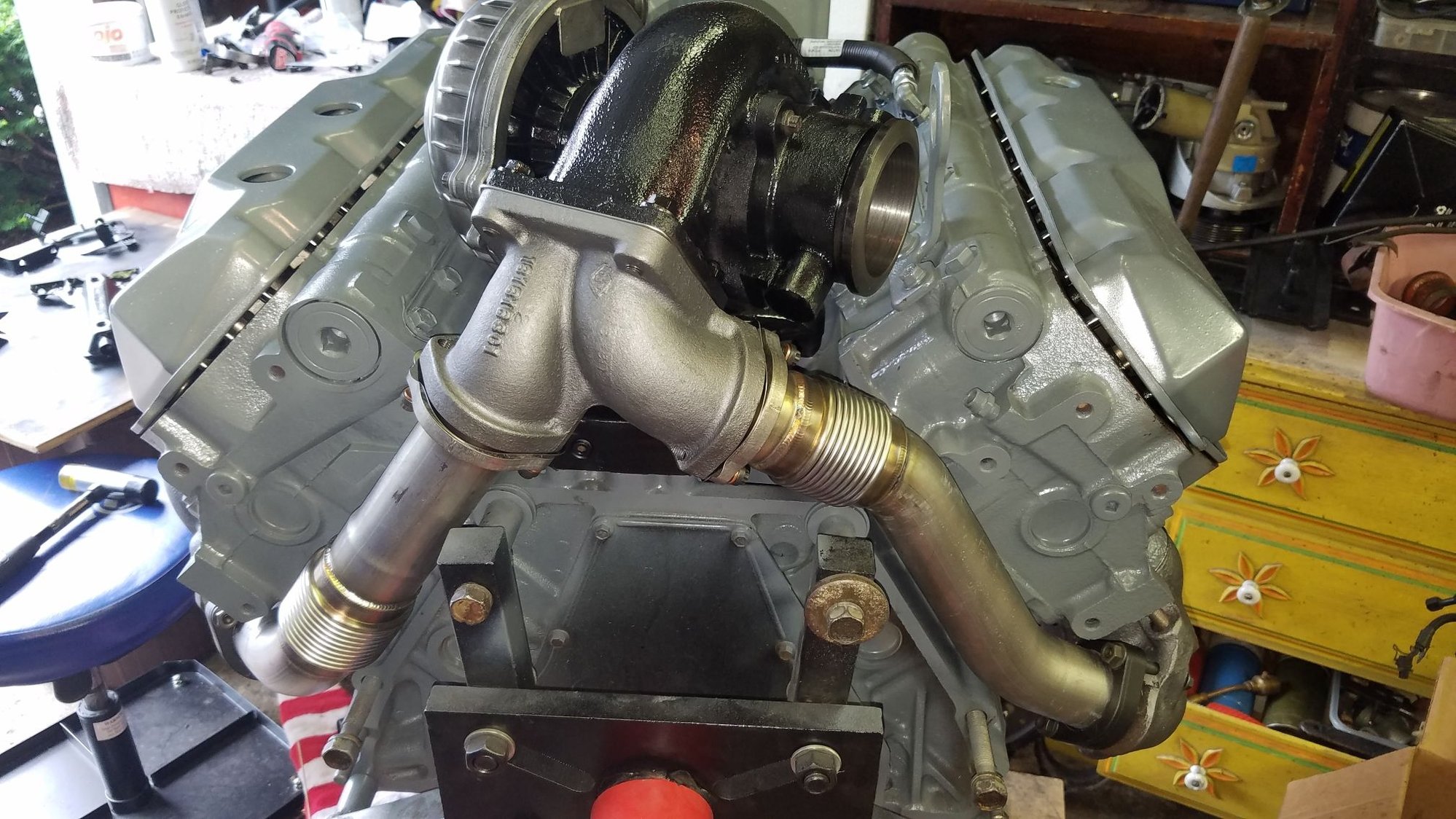

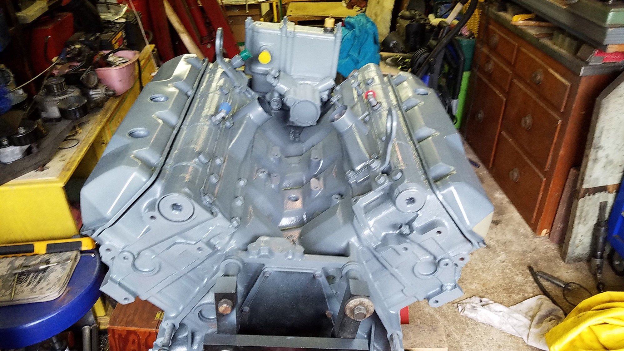

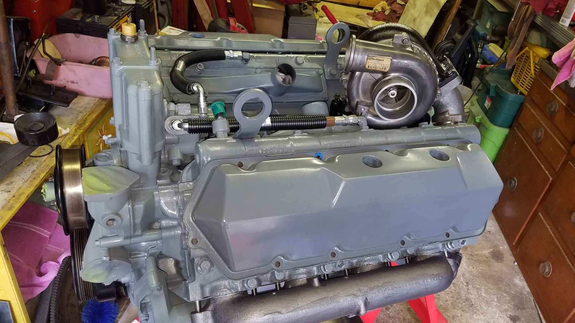

Heads are done and the turbo is back on. Time to focus on the engine bay and get things ready to bolt her back in.

Few updated pics

Should have done oil galley plug o-rings, would be my luck as soon as its back in they start leaking
They were all done. Oil rails reOringed and the ends have the new version plugs from RR in them!

those uppies look nice installed
OEM UVCH or convert to SD style?

Thanks, nothing is tight yet but they do look sharp! Hopefully I won’t have to worry about them for a while.
OEM on the harness for now
