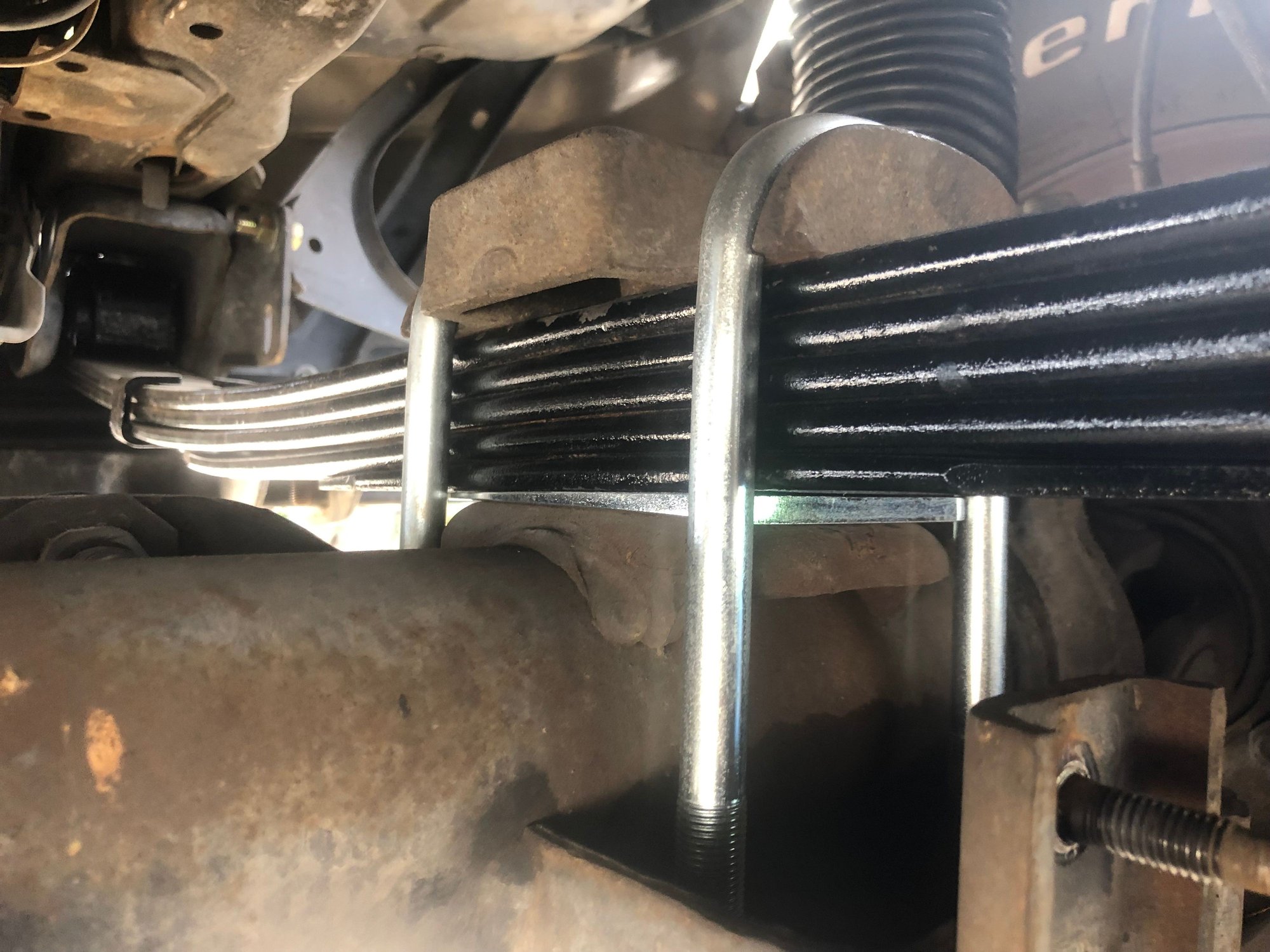

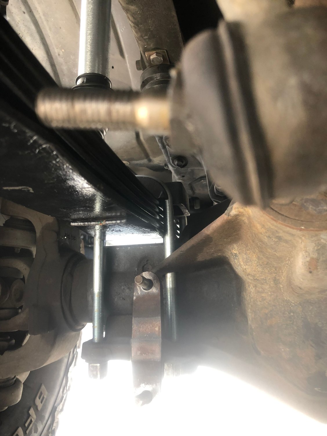

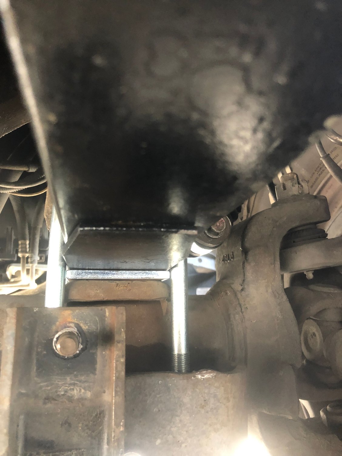

Driver side thick end the wedge
Passenger side from rear you can see thicker end.
Pass side fat side to the rear
Update on the install. I went back and added the 2* shims to my springs to add positive castor. There's significant improvement in self centering. My truck already has new ball joints, tie rod ends, and a Red Head box. It didn't have the "wandering and skittish" issues. It would go wherever you pointed it...….and keep going that way until input at wheel the changed it. Now there is a modest resistance as the steering will come back to center on it's own. Just enough road feel. A thumb and Index finger affair. All sway bars are disconnected. I'll drive it that way for while.
Old May 25, 2019 | 02:13 PM
  #109
agsmv1's Avatar
agsmv1
Joined: Feb 2015
Posts: 1,394
From: Loveland,CO
Where did you install the shims? Pics my man..pics!!

I need clarification on the shims. The fat side goes on the front side of the leafs for both the front and rear springs right? Thank you.
NO.
front axle. you want to increase Positive caster. to do that you want to roll the pinion down which would require the Fat part of the wedge to face the rear of the vehicle.
rear axle depends on which type of drive shaft you have.
for a Non-CV type you want to make the pinion shaft parellel with the Tcase output shaft so roll the pinion down by putting the fat part of the wedge facing the front of the vehicle

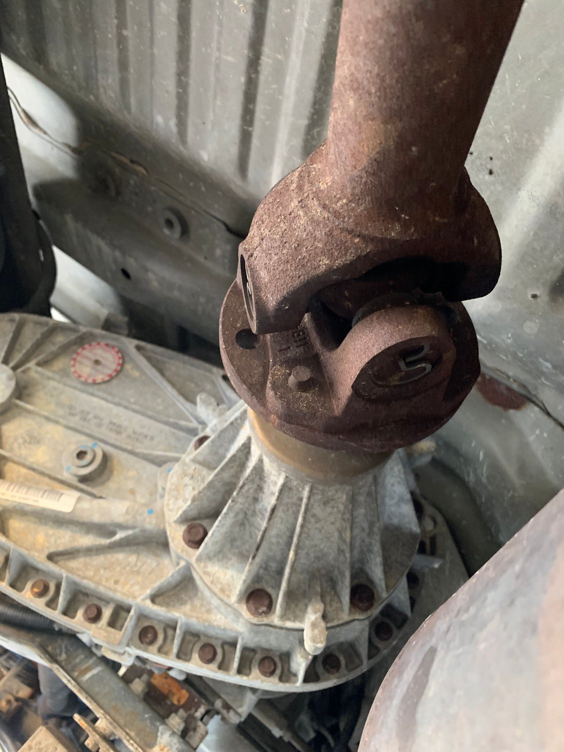

This is what the Double Cardan U joint looks like on the Ex. (CV) This is the front of the driveshaft at the Transfer Case

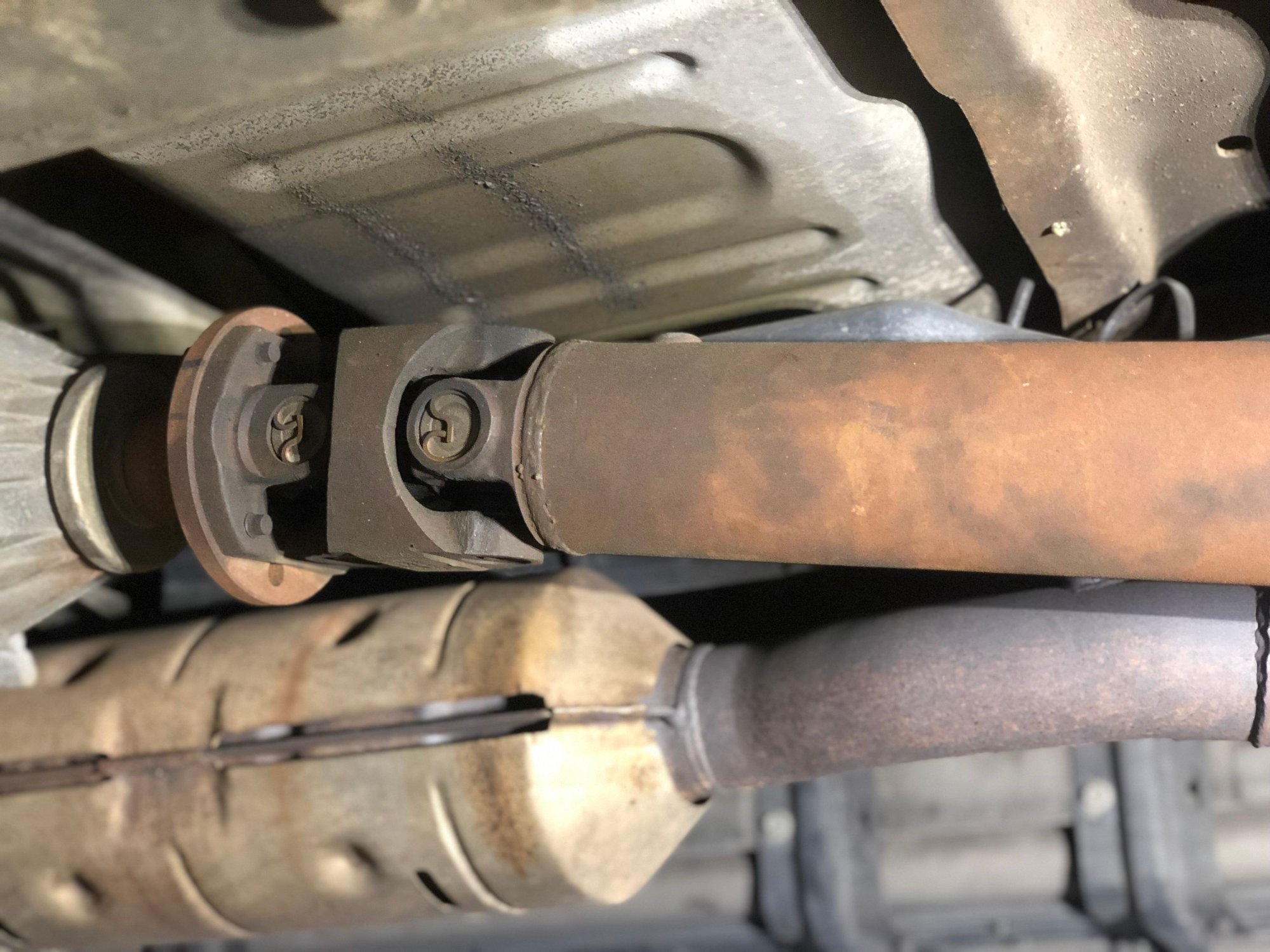

The is the rear of the driveshaft at the Diff. Notice the straight working angle.
I’m going to say non CV right?
correct. non cv or just “single joint both ends”
So is that driveshaft backwards, mine has that joint at the transfer case.
Old May 28, 2019 | 06:04 PM
  #118
bluovl's Avatar
bluovl
Joined: May 2011
Posts: 855
Likes: 40
From: SoCal
No that driveshaft is not backwards. The Double Cardan(CV) is at the output of the T case, and the single u joint is at the Differential. From what I understand Ford switched to this configuration sometime during production. I don't know what years. Maybe someone can tell us.
