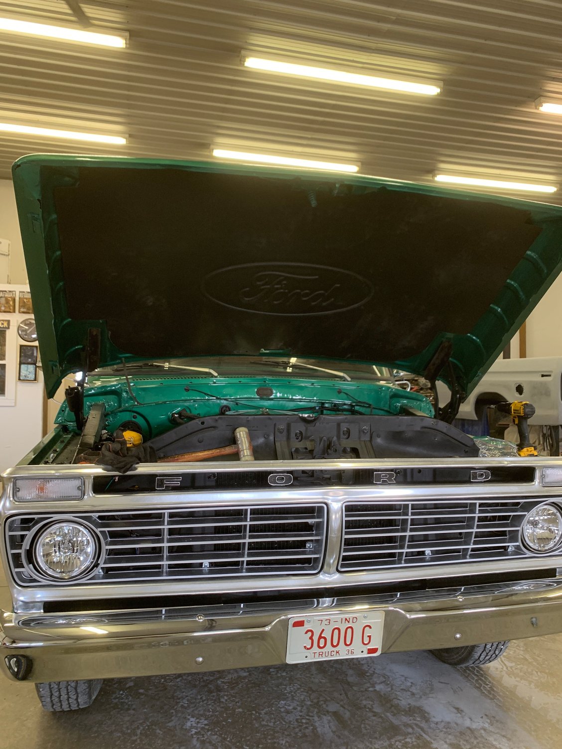

More progress
About to finish the hood insulator/plastic liner piece today. Next step is to find some high heat white enamel paint to outline the ford logo and then move onto installing the rest of the headliner electrical
