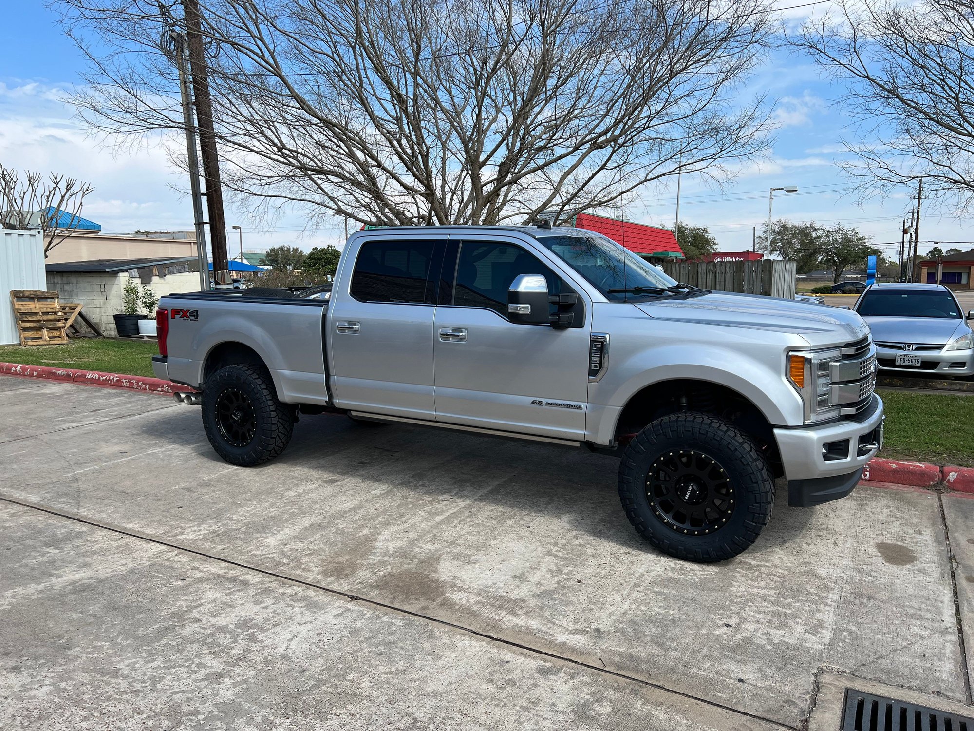

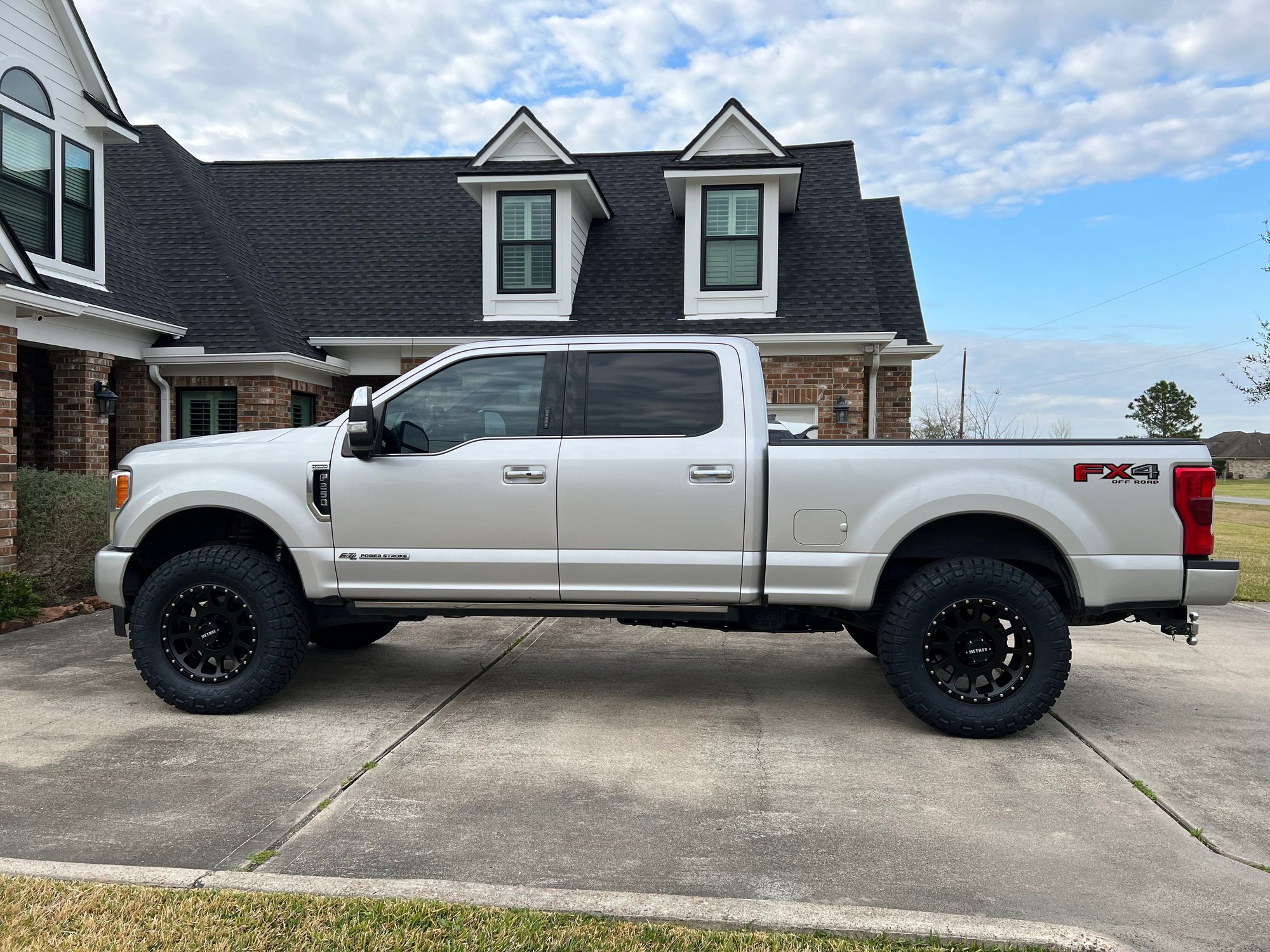

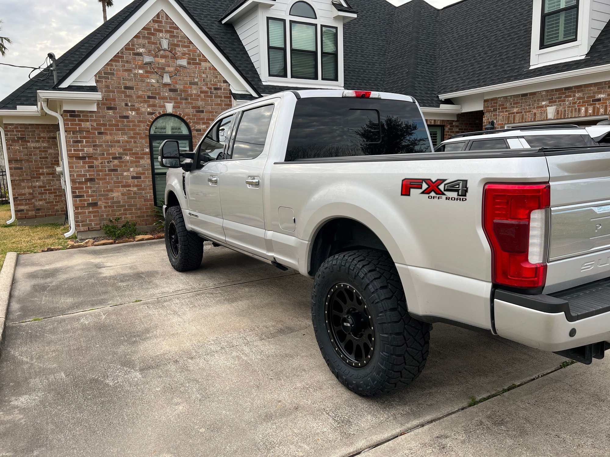

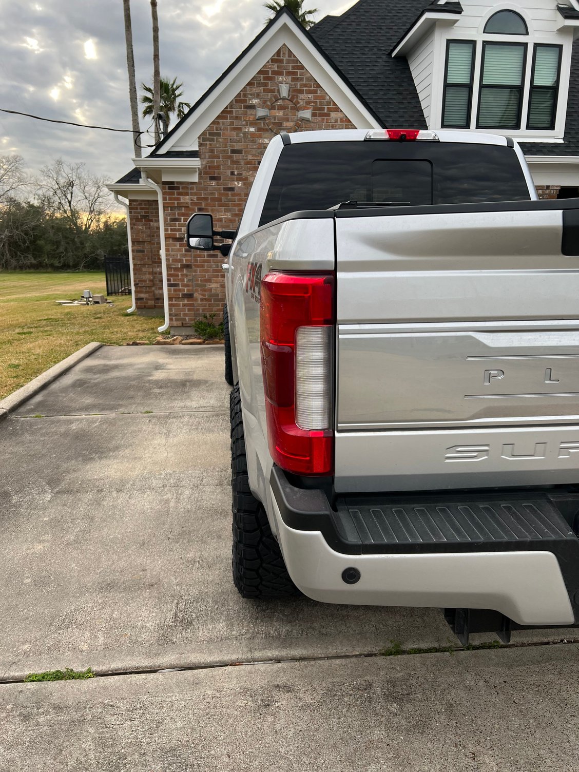

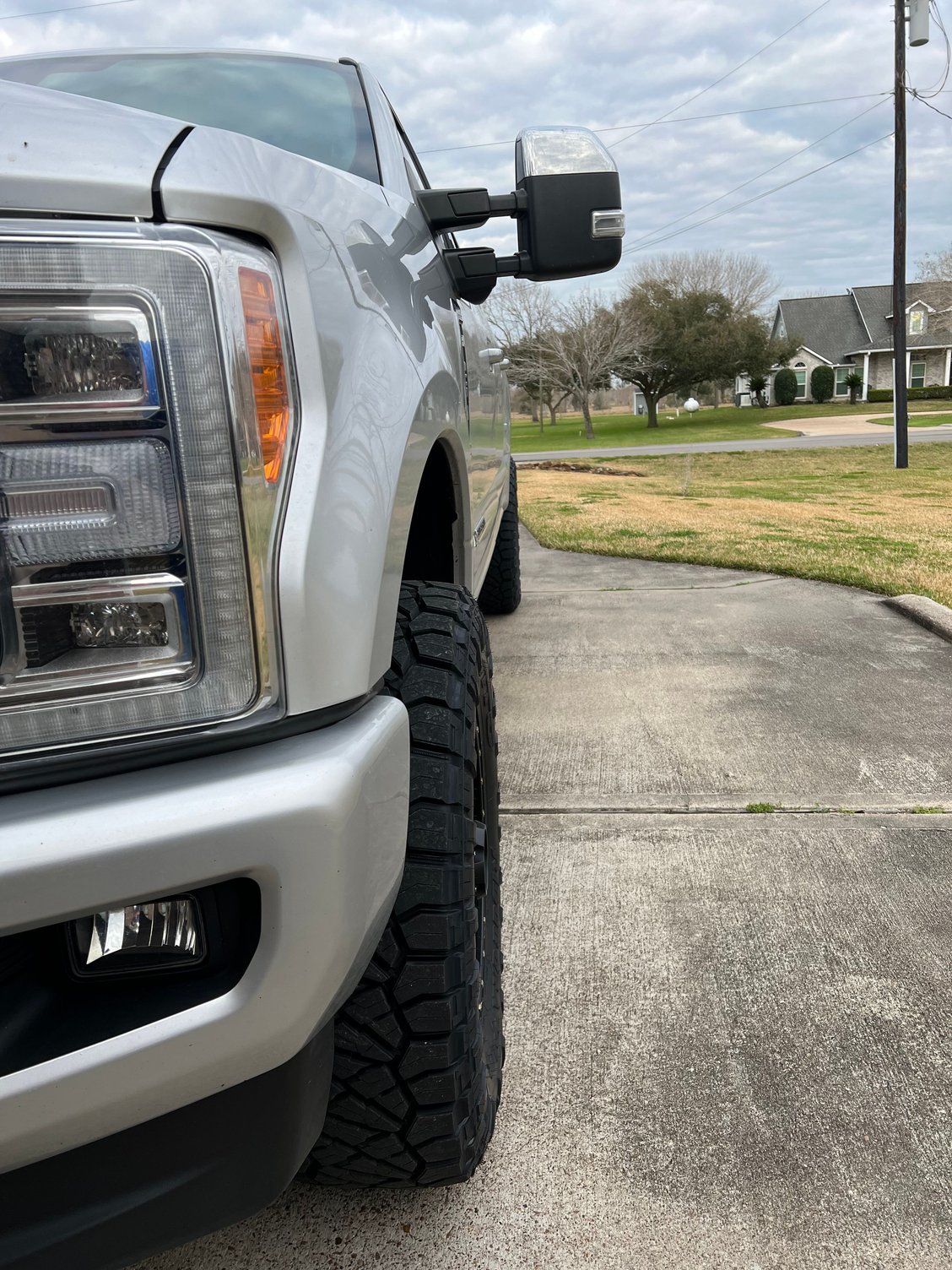

Old Mar 9, 2022 | 07:08 PM
  #158
porkchoptx's Avatar
porkchoptx
Joined: Feb 2022
Posts: 7
Made the switch today. Couldn’t find any decent pictures of the wheels I really wanted and felt a 17” wheel would look off to me personally. 20” Method NV with 37x12.50r20 Ridge Grapplers.
truck feels a bit “floaty” for some reason. Assume it’s just because the tech put 70psi in each tire.
Also no rub as far as I can tell. Definitely feel the change in shift points with the larger tires. Wouldn’t mind getting it calibrated for correct speed but don’t want a CEL on all the time.
