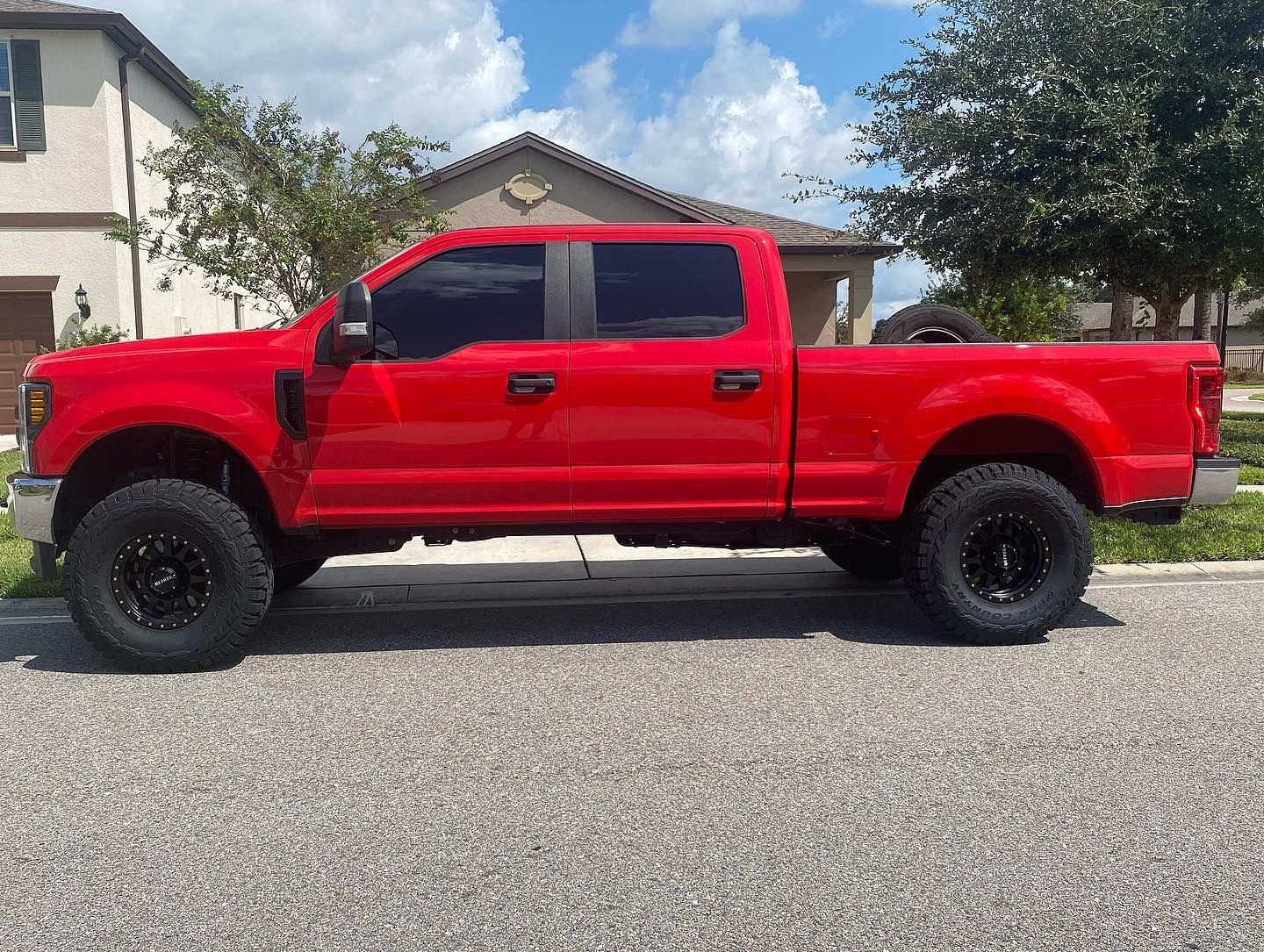

37/13.5/R17

your truck looks amazing! - how do you like your suspension set up??

it is a Carli 3.5 back country and it rides night and day different. So much smoother on and off road.

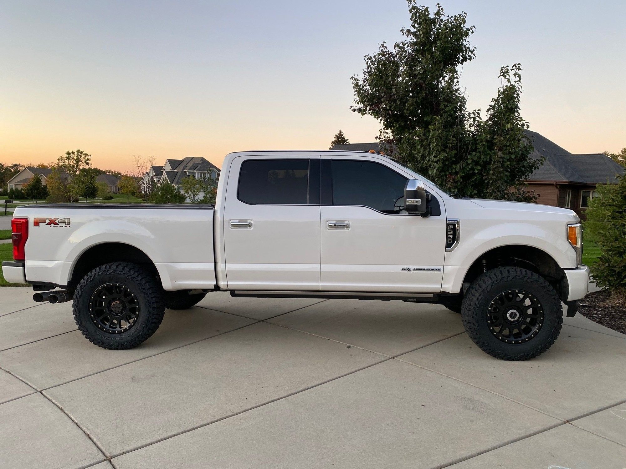

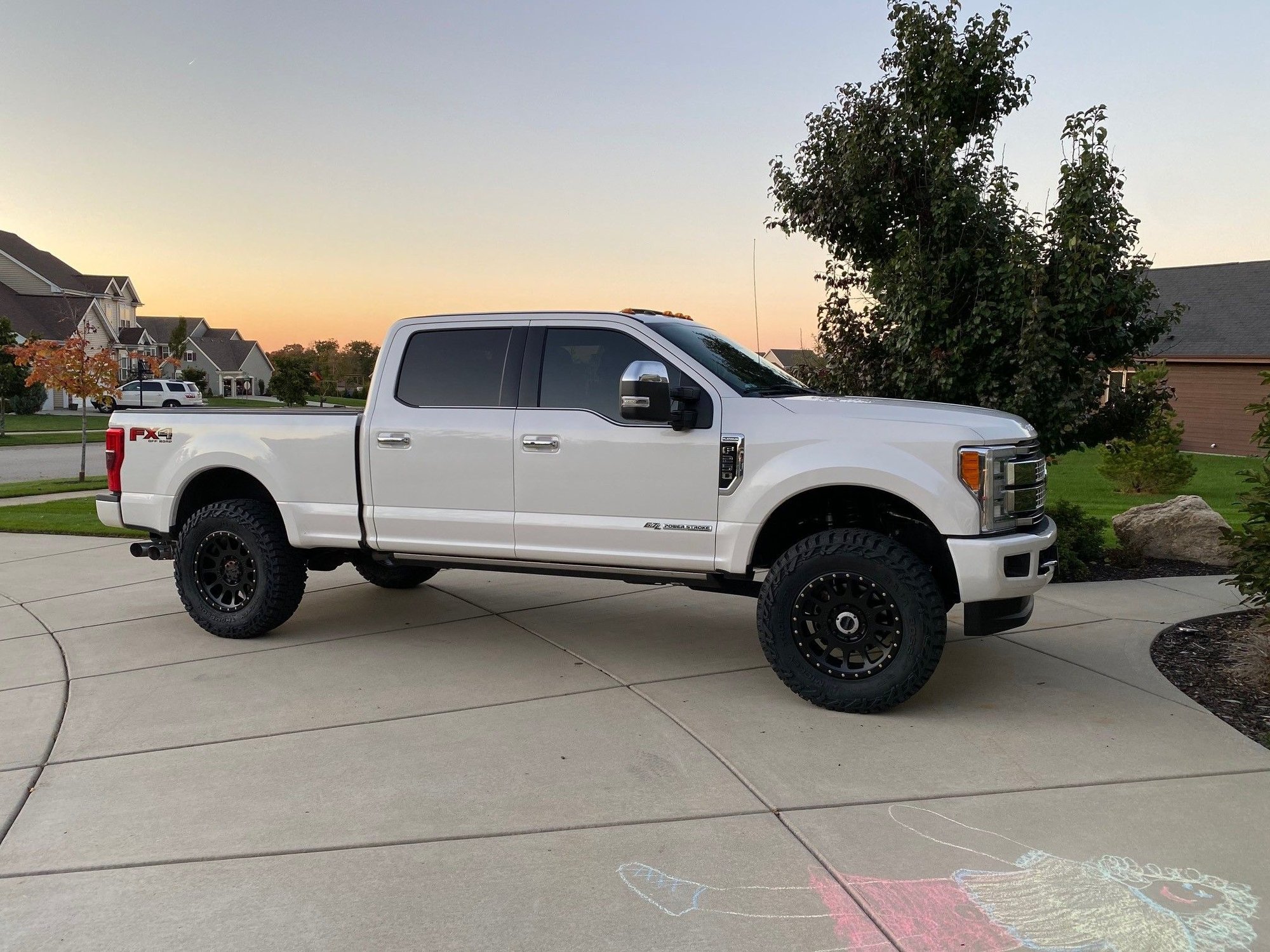

carli 2.5" method nv +18 r20 on 37x12.5

looks perfect. do you have any shots down the side to show the tire poke?
do they rub? did you trim?

Wondering if this was answered? Love the way this truck is setup but I’m stuck between offsets and trying to figure out what i can run with a 3.5” carli lift, and 37’s with minimal trimming.

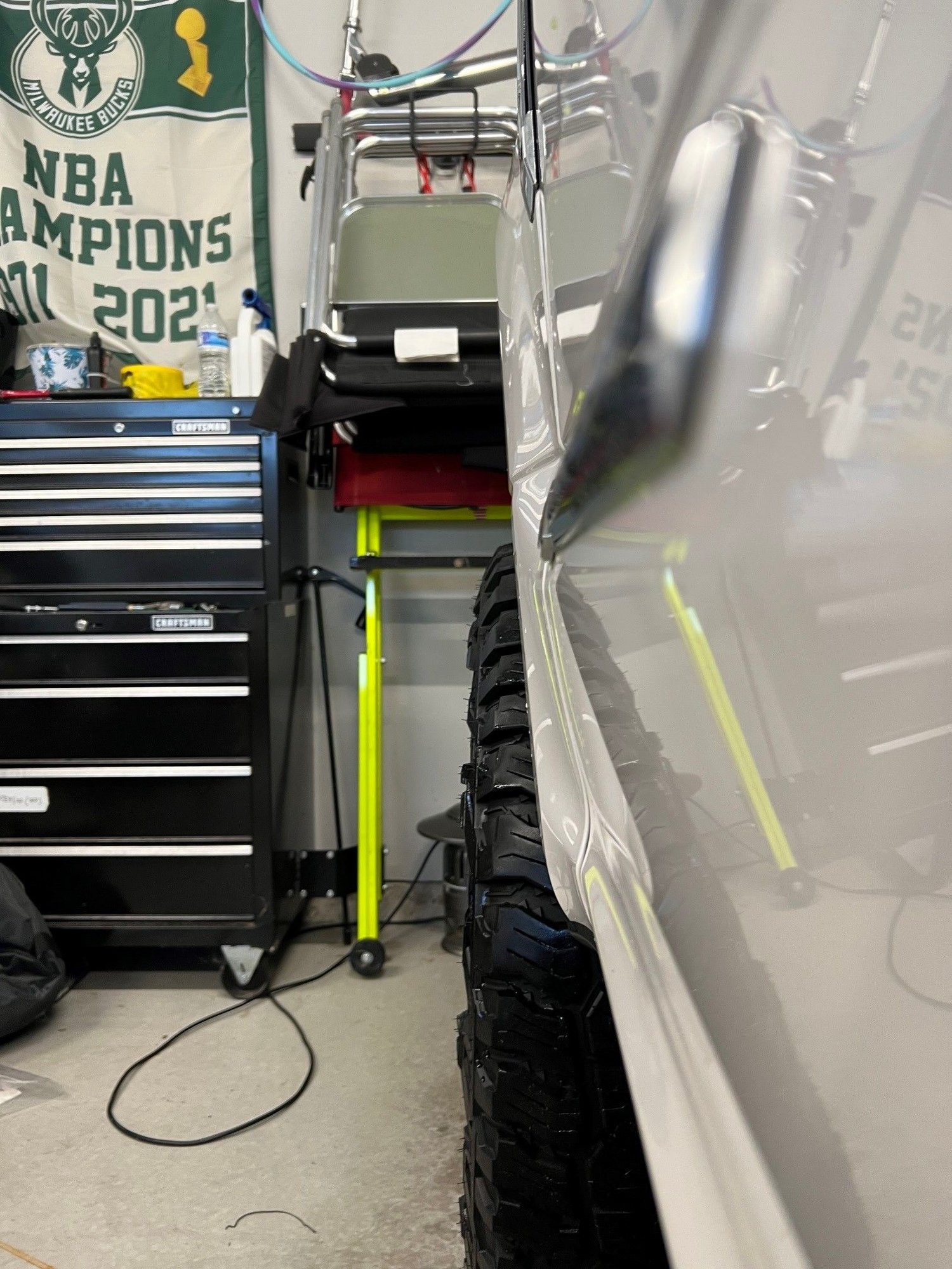

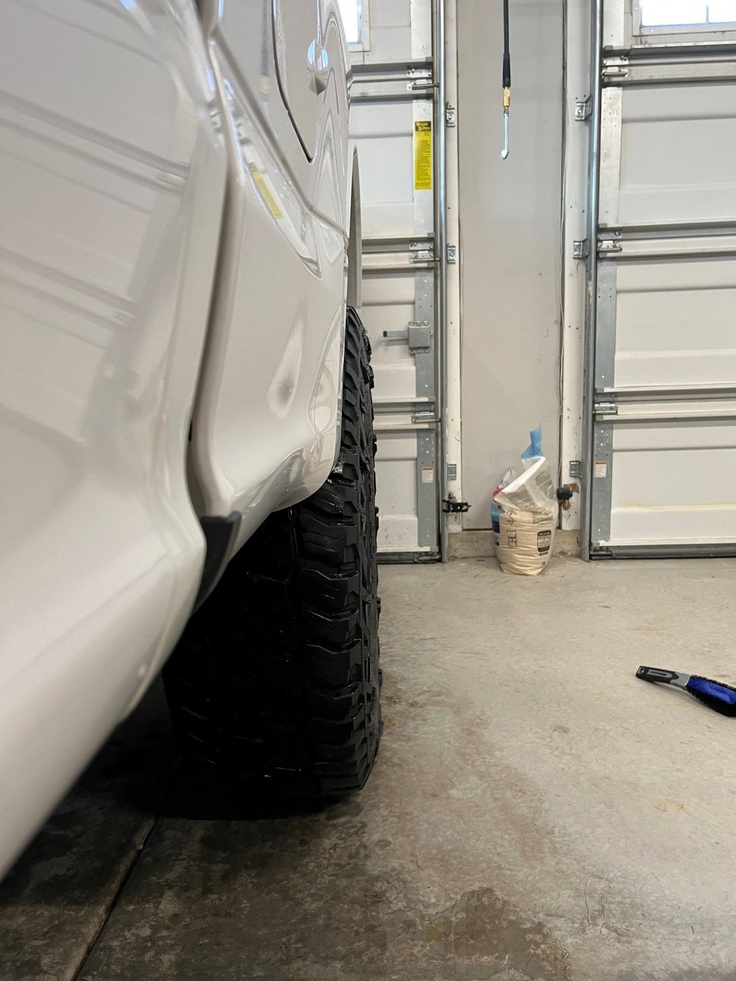

I"ll try to get a side shot. Extremely minimal rub on the drivers side at full turn in reverse, did not trim anything.

Not the best shots, but they stick out perfect. I am not a big poke guy and the +18 is awesome. I'll get a full outside shot soon for you

thank you. yep +18 is where it is at. 0 offset would be too much poke, even with a 11.5 wide tire. 11.5 might be good on the +18 as well

I like the look of +18 as well....Which would require more trimming, 0 or +18?.... I wouldn’t want any rub
