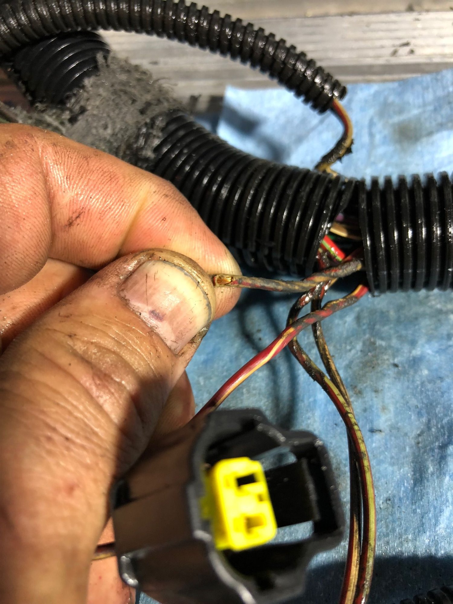

Well the P1316 suggest either the IDM or the harness. I recently rebuilt my harness and it requires removing it, unwrapping it and visually inspecting 100% ever inch of wire.
turned up 3 of these, Seems to happen where a wire run branchs off the main trunk right under the turbo. Most likely from resting the turbo on the harness during removal.

Sneaky little buggers...

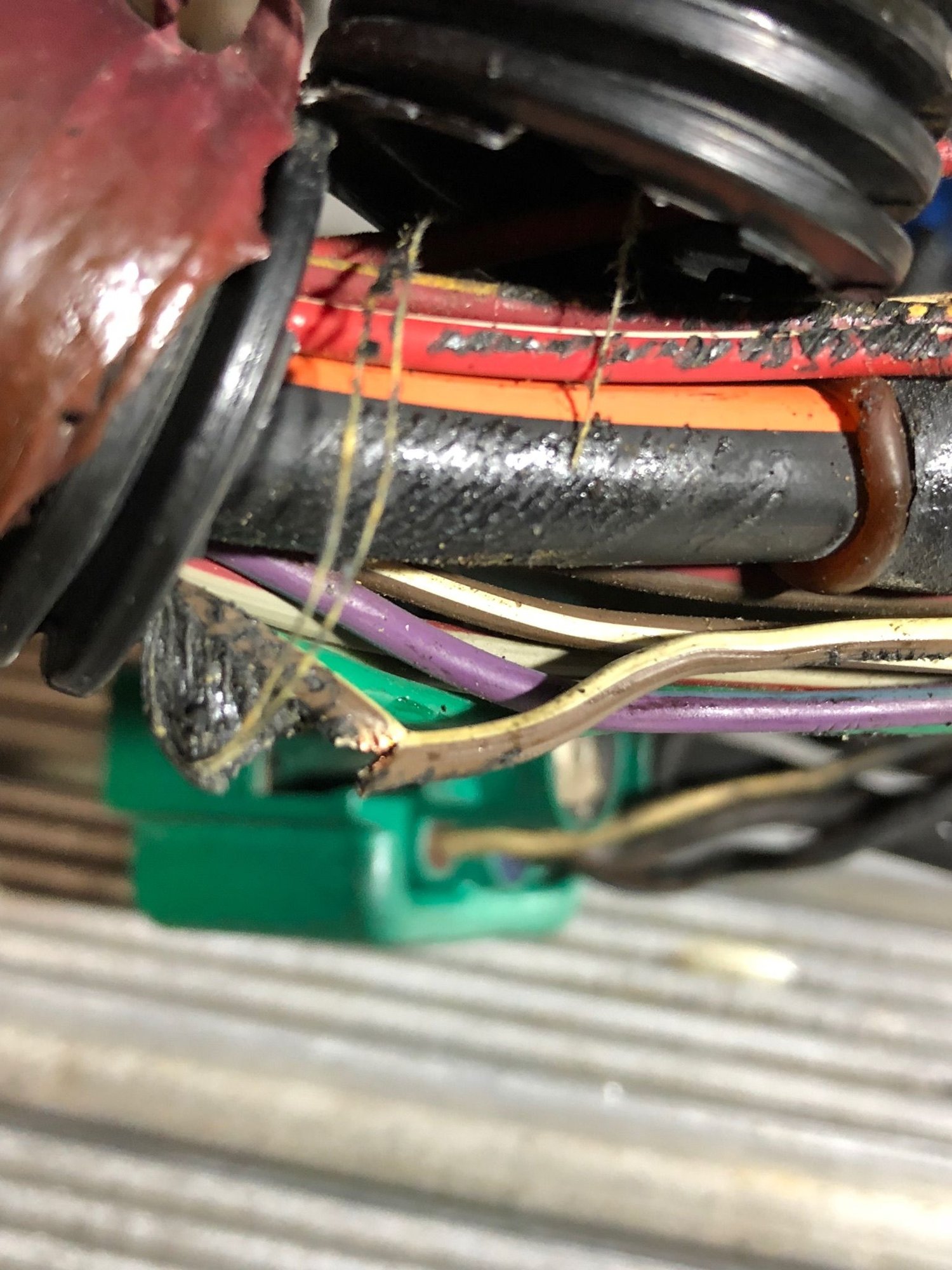

good job, in the second pic it looks like the wire is chopped in half, is that right?

Yup....classic intermittent short depending on how it was vibrating
