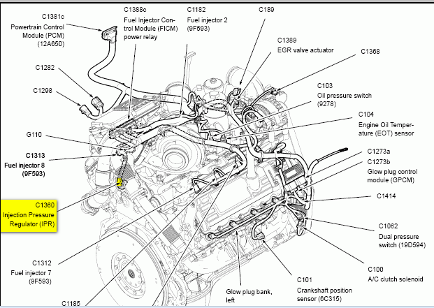

Ok. It's either IPR (under the turbo in the back) or the VGT solinoid plug on the turbo. Probably IPR.
Here's a diagram.

Thanks. I did not have any luck loading the picture, but I think the diagram is what I needed. Either way it looks like it is going to be a chore to hook it up.

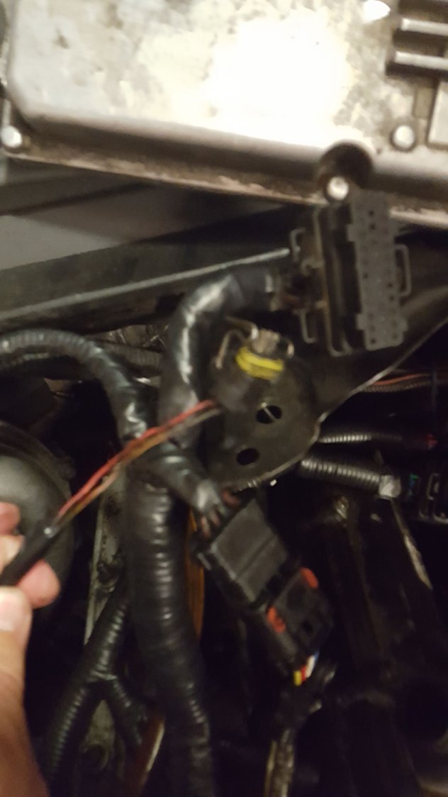

Here is the plug alongside the plug to the FICM. How do I get it back where it belongs.Thanks again..

I maybe out in left field but check the IAT2 sensor behind upper fuel bowl,
Never mind I see the wire clip on it now.

Looks like the IPR (b/c of the wire clip):
From the front, get some small hands and stick the wiring connector in:
Silver sensor with black plug is the ICP, IPR is the white-ish connector on the brass solenoid right behind the black connector:
I don't know if the ICP will be there on your truck or not, not sure when the ICP moved on the Ex's. The IPR will be there for sure.

04 late build. ICP on valve cover. So must be IPR. Thanks!!!
