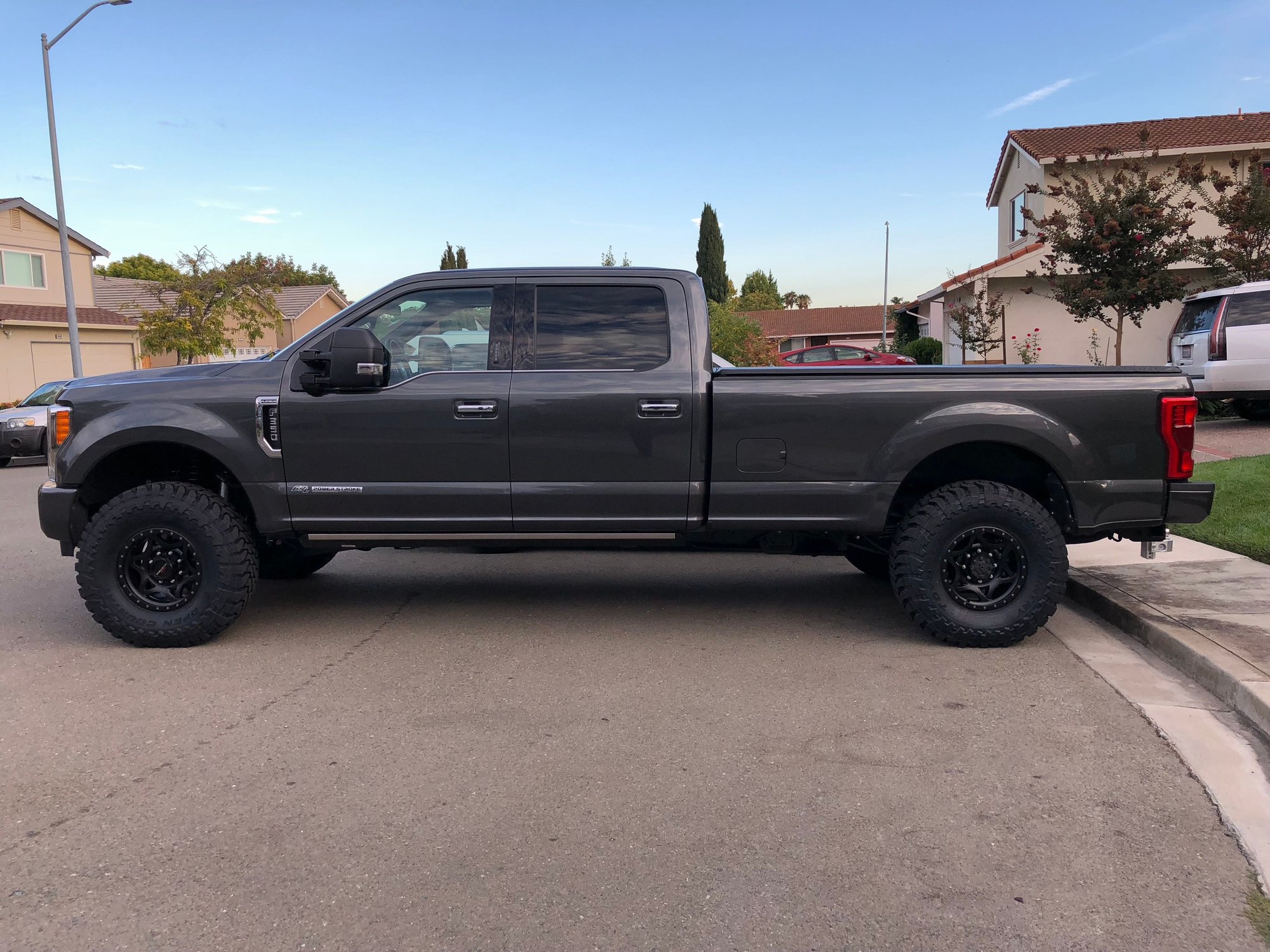

Originally Posted by wicked 2018
No this is:
My frankenlift setup:
2.5" Fox Shocks with DSC (all 4 corners)
Lewis Built Adjustable Track Bar
Lewis Built Adjustable Radius Arms
17" Walker Evans 501 Rims
37" Toyo Open Country MT (12.5" wide)
Carli 2.5" Springs
Carli Brake Lines
Carli Bump Stop Drop
Carli Sway Bar Drop
Fox ATS Steering Stabilizer
.5" metal lift spacer
All wheel wells measure within 1/4" of each other
No rubbing or trimming
Stock springs in rear
Very cool!
Are the ride and handling still good?

Originally Posted by sky Cowboy
Very cool!
As mentioned a few post back - rides better than stock. Bump steer was 100% improved with the lift and now adding the Fox ATS its virtually gone.
