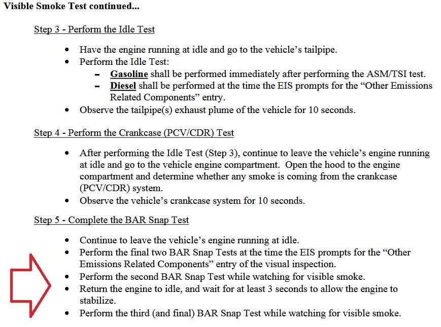

Originally Posted by brian42
My tech revved the crap out of my truck for almost a minute becaue it was "close". He was running the engine up and down the tach so hard that the truck stalled.
Since this distressing minute for Brian42 has become a touchstone of this thread, FTE readers in California might be interested in comparing how the California Smog Inspection Procedure Manual instructs smog techs to conduct visual smoke testing.
From the very inception of the diesel smog testing program, the Visible Smoke test at elevated RPM was always to be, and still remains, a SNAP elevated rpm test, patterned after the PSIP (Periodic Smoke Inspection Program for heavier duty diesels that had already been in place for a decade prior), not a sustained elevated rpm test. Since I think Brian42 hails from the San Diego area, I picked a power point presentation coauthored by the BAR and the CARB on January 9, 2009, that was presented in San Diego on January 20, 2009. Here are the two relevant slides from that presentation of the proposed diesel smog check program:
Moving beyond what was initially proposed into what was eventually implemented, we have the same language "push the accelerator pedal quickly... then immediately release the accelerator pedal" carried forward unchanged in the third and final revision of the first Smog Inspection Procedure Manual that covered diesel vehicles, as published by the CARB and BAR in August 2009:
Even in 2013, when the BAR and the CARB revised the Smog Inspection Procedures Manual, we find that the language describing the BAR Snap Test remains the same, unaltered from the originally proposed procedures:
Therefore, the Visible Smoke Inspection Snap Test, as originally proposed, as presented in San Diego, as written in the initial Smog Inspection Procedure Manual, and as revised in the most recent Smog Inspection Procedure Manual that is in current effect, all remain consistent and unchanged. As such, there does not appear to be any reason or excuse for a smog tech in San Diego, or any where else in the state, to deviate from the snap test procedure as outlined.
In fact, the state specifically prohibits smog tech inspectors from sustaining an elevation of the rpm, or increasing the engine load, during the 3 minute idle period, and during the tailpipe emission inspection period. The state interprets sustained high idle during testing as an unlawful means to artificially "super heat" the catalyst (if equipped), and as such prohibits such actions.

This was a new tech I had never seen before. He was a younger guy that knew more about the stock 7.3 than I have seen in the past. He said they get training on the older engines to keep their knowledge up.
I don’t think he was malicious but he was not gentle. I know many other diesels redline higher than ours (my dad’s D-Max is around 4800 RPM IIRC) so I don’t know if that played into it.
His visual inspection was about 15 minutes (truck idling the whole time) and then he did the Snap Test. I didn’t count them but he probably did it at least 10 times before the truck stalled.
I’m sure he probably didn’t want to get himself or the shop in trouble.
I only mentioned switching shops as the guy that normally does mine is one of the owners. If he has retired from doing the testing and I’m left with a bunch of guys that think everything redlines at 6K RPM then I will go elsewhere. It’s not about the test itself as much as what they put the truck through during the test.
Originally Posted by Y2KW57
From the very inception of the diesel smog testing program, the Visible Smoke test at elevated RPM was always to be, and still remains, a SNAP elevated rpm test, patterned after the PSIP (Periodic Smoke Inspection Program for heavier duty diesels that had already been in place for a decade prior).
The Snap Test has been in effect here in San Diego since the testing started in 2010 so it’s old hat down here. As you said it has remained unchanged also so is not a new concept to the shops around here.
