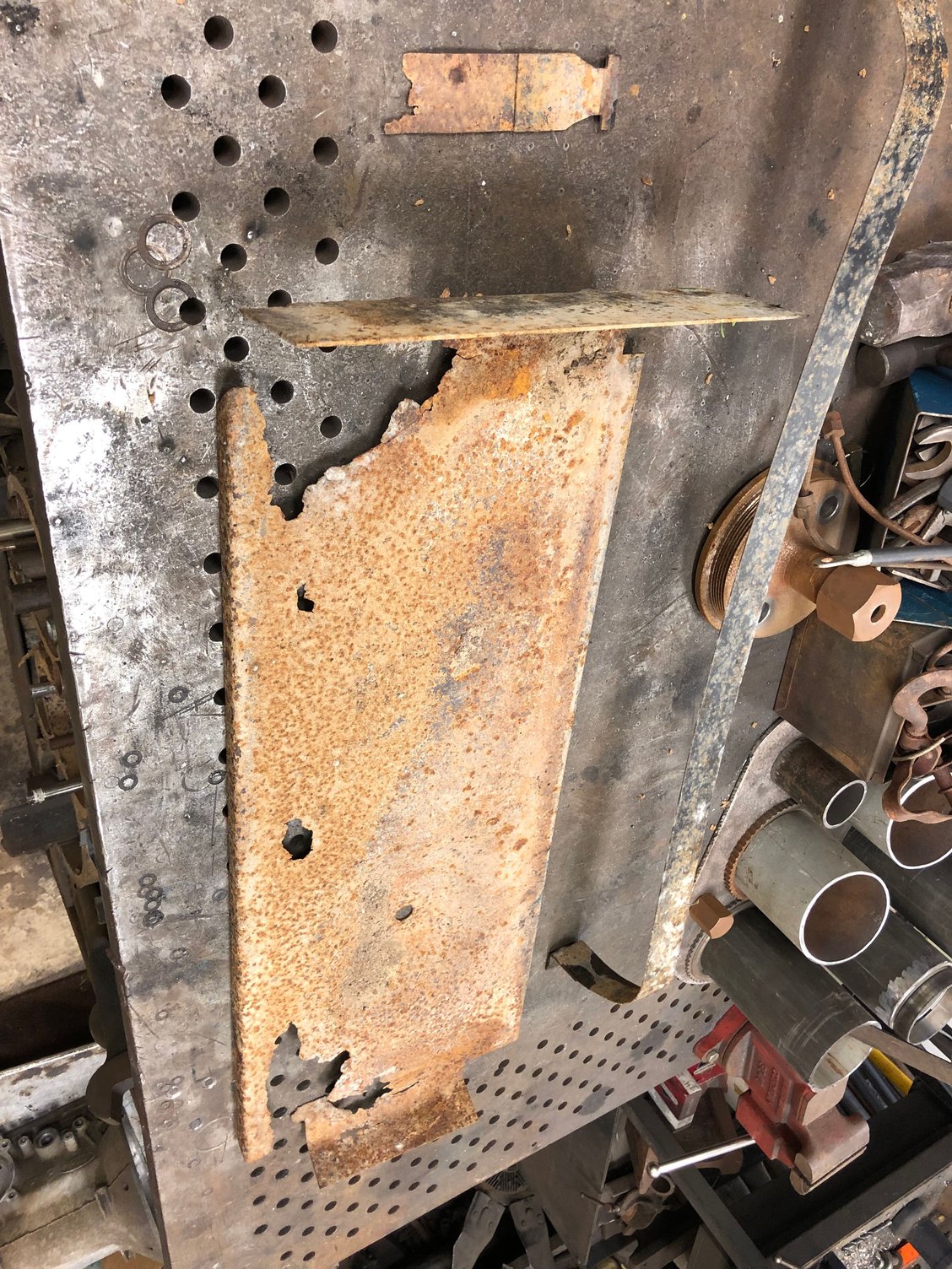

One strap is rusted away and the inner is perfect....no prob. Fabbed a new one out of 3/16. Thanks god for plasma cutters and press brakes!
Still need to add some 1.0 to the sides but it beats buying one......what fun is that anyhow?

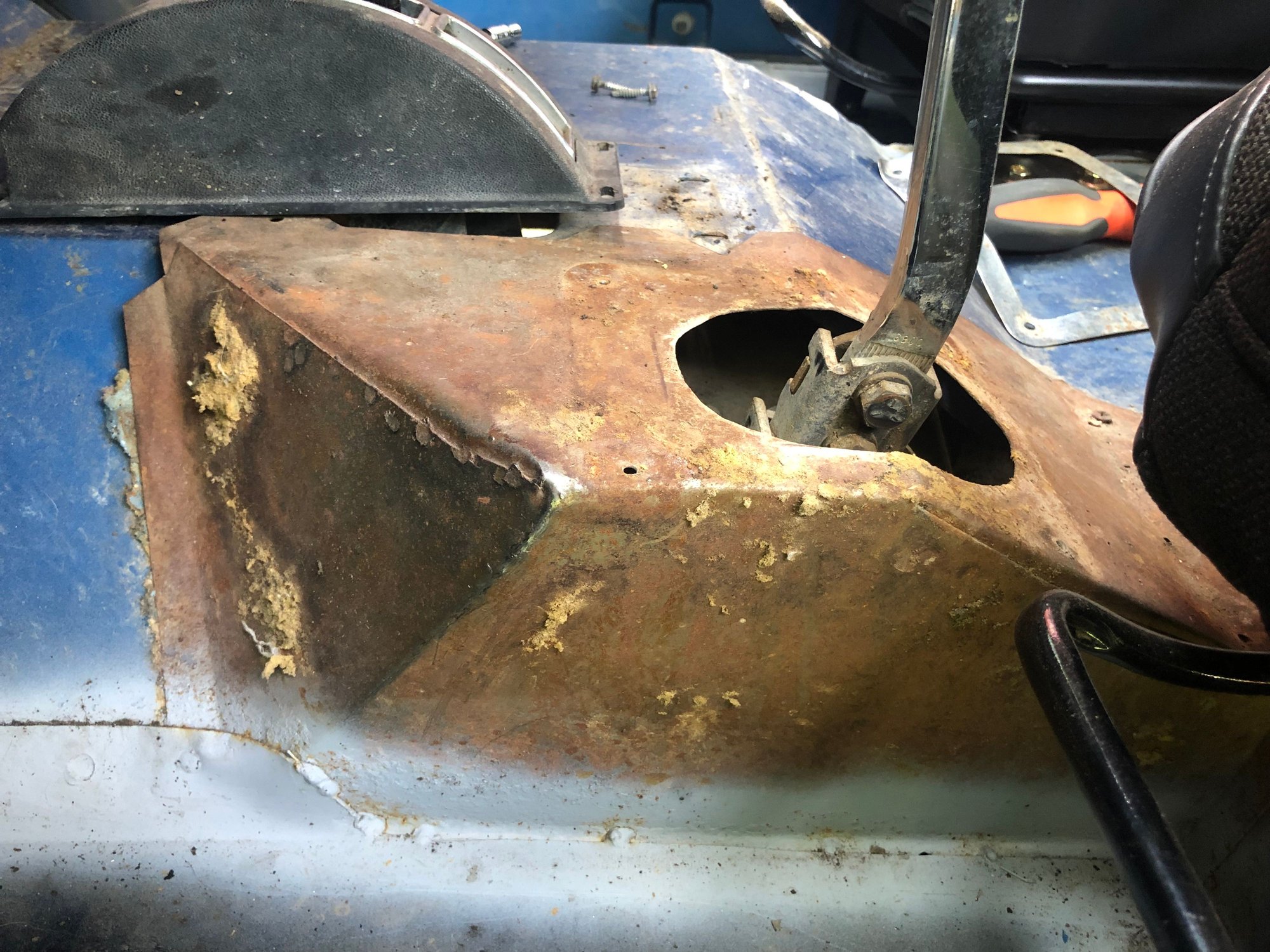

What is the problem here. It's not the rusty stuff or the crews missing from the t case shift cover.
Old Aug 26, 2019 | 02:54 AM
  #103
77&79F250's Avatar
77&79F250
Moderator & parts slinger
Posts: 50,186
Likes: 5,792

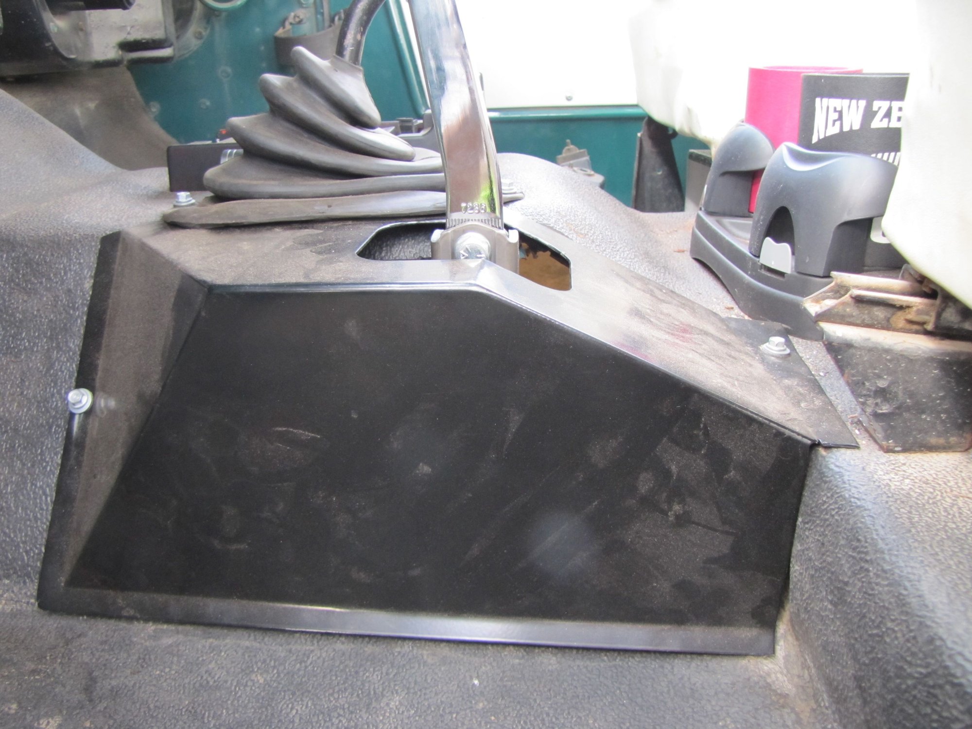

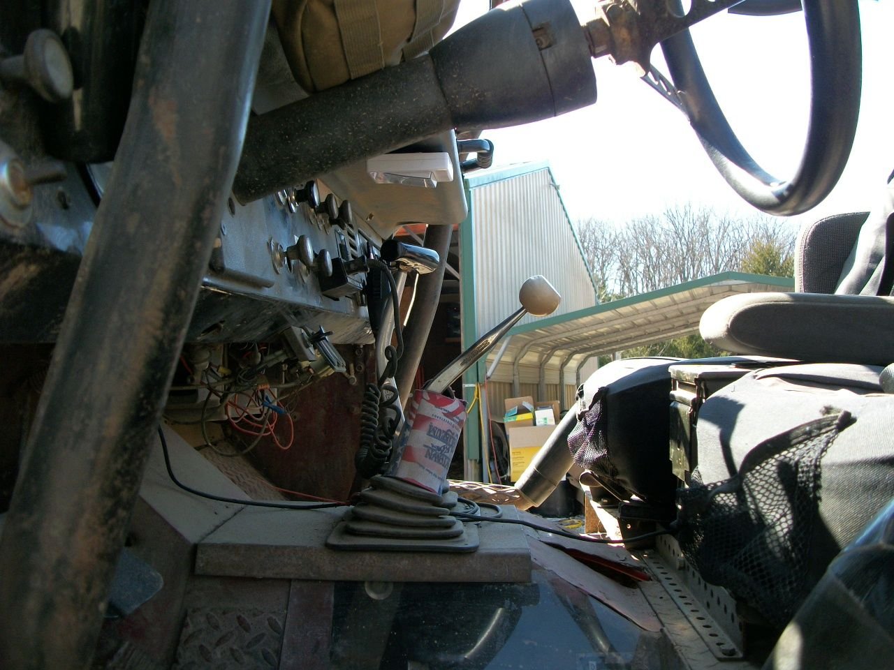

With that black half round cover, I am thinking T shift Dana 20 (the easier and better one too). And with that large cover added on, you have a floor 3 spd correct? 1st pic 3 spd on column and T shift xfer case. The problem I see you having it the dvrs side floor pan was replaced and put in ON TOP of the trans shifter cover (and tack welded) so that cover is not easily removable....
