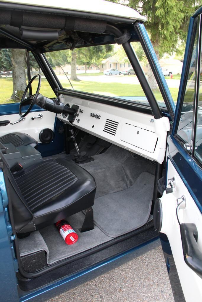

Old Feb 11, 2020 | 06:28 AM
  #184
77&79F250's Avatar
77&79F250
Moderator & parts slinger
Posts: 50,194
Likes: 5,793
Nicely shaped cover up tubes and to get a lower front cross tube I believe NO dash pad? And pretty sure I do not see an upper cross tube? I can see w/s wiper connecting arms, but no upper roll cage cross tube.
