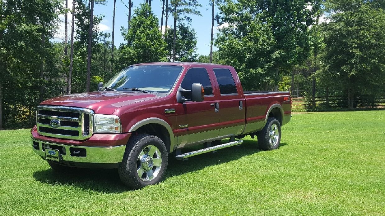

I bought a 2006 F350 6.0 today and after a quick inspection of the batteries and cables I found the + cable/connector on the passenger side is eat up pretty bad. Question is: replace or repair? New cables are around $75 on ebay. I'm leaning toward replace but just looking for repair options/opinions.
