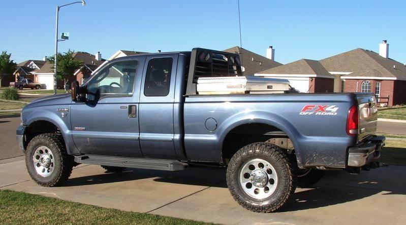

I ran 295/70R18s on factory 18"s and they fit fine, never rubbed. 6000# front springs with a heavy replacement bumper. I don't know what the absolute biggest you could stuff under is, but 295mm was the widest Nitto specified for an 8" wide wheel. I came down from 35x12.50s that rubbed even with a 2" leveling kit because the 17x9" wheels were backspaced out further than factory rims.
I had Nitto Trail Graplers, they wandered pretty bad when new, long solid M/T tread lugs will do that though. They pumped up to 4080# rating at 80spi though, they were very stable when towing after the first 10k or so. Disadvantage is an effective reduction in your gear ratio. If you have factory 20s you probably won't notice, but coming from 31.5"/265/70R17s I could tell a difference. Realistically anything that fits a factory wheel won't have significant disadvantages, so long as you get the correct load rating.

I was happy with 295/70R18s. Pulled fine once they wore a bit, not very different from factory 20s really.
295/70R18s:
265/70R17s:
275/65R20s:
