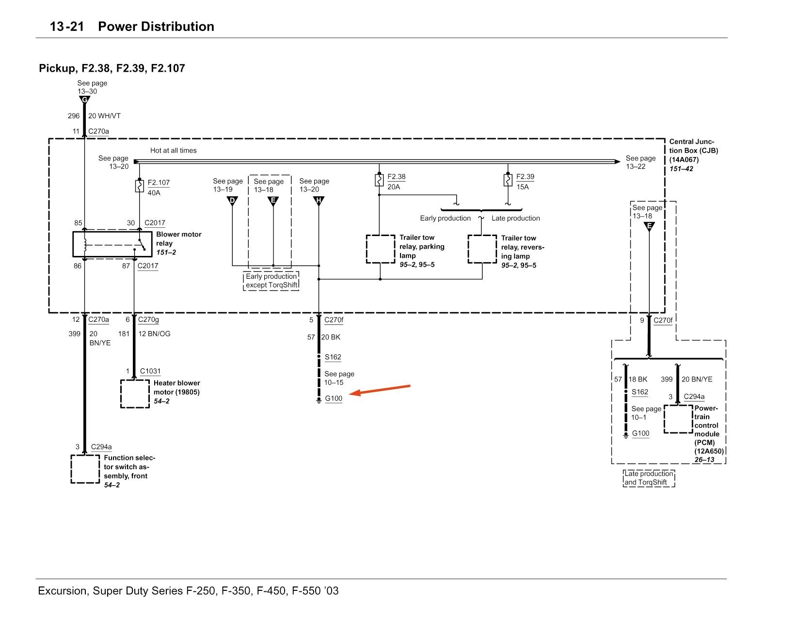

So basically you run a 1/0 from positive battery terminal to the other positive battery terminal and then you run 1/0 from driver side frame to the negative battery on the driver side. I'm going to be adding the 230 amp lease Nevelle alternator do I need to run a positive wire off of the alternator to the passenger side positive battery

Yep, you do. There are tons of threads around about this alternator. Here's one about cabling for the alternator.

Driver side grounds to ficm pcm
Okay do I need to add 2 8 gauge ground wires from negative driver side battery terminal too the ficm ground and the PCM ground locations at the firewall and the on the driver side fender and how long do those cables need too be

The easiest, least complicated is to go 8ga 24" 1/4" eyelet to 1/4" eyelet between the pass negative terminal and the FICM ground screw by the hood driver's strut, and 8ga 18" 1/4" eyelet to 1/4" eyelet from that connection to the firewall PCM/CJB ground screw. You could go up to 6ga, but I wouldn't necessarily do 4ga. Been there, stresses the bonding cables more then I care for at starter engagement.

I thought the ficm ground screw was on the driver side right by the steering wheel I'm confused LOL thank you very much for responding to I'm about to order all these cables

Okay cool beans it is on the driver side. Thank you for all that you've done in these posts you really have helped a lot of people out
