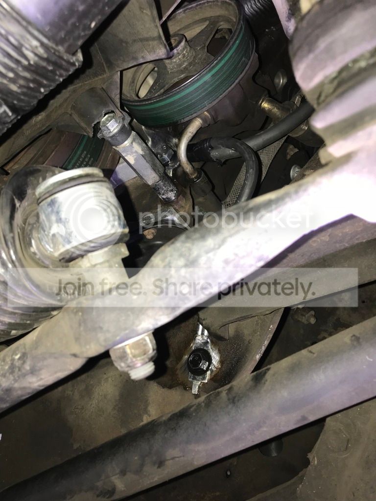

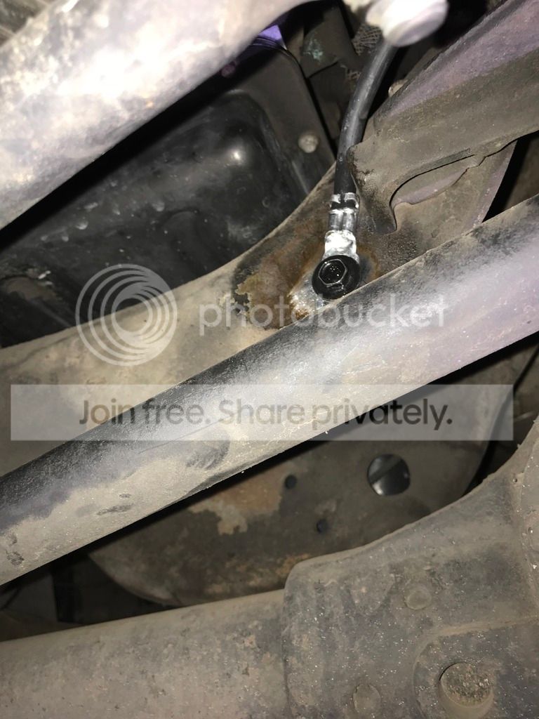

I bought the cable y’all listed and installed it yesterday. Attaching to the frame was a little different than I expected with the short length of cable. Attached to the block just above the stator stud like pictured. Then attached to the frame at an existing hole next to the Trac rod mount. Also attached to the ground stud behind the driver side headlight. Definitely noticed better cranking rpms and about .7v higher on the FICM. Seems to work okay for now. As an option for those who have the cable already.

Thank you sir. Great pictures and description, and affirmation of its benefits. I think this captures the original benefit of the jumper cable to the block and the 8ga cable driver neg to ABS most recently in a combined effort.
Good find on that crossmember hole.

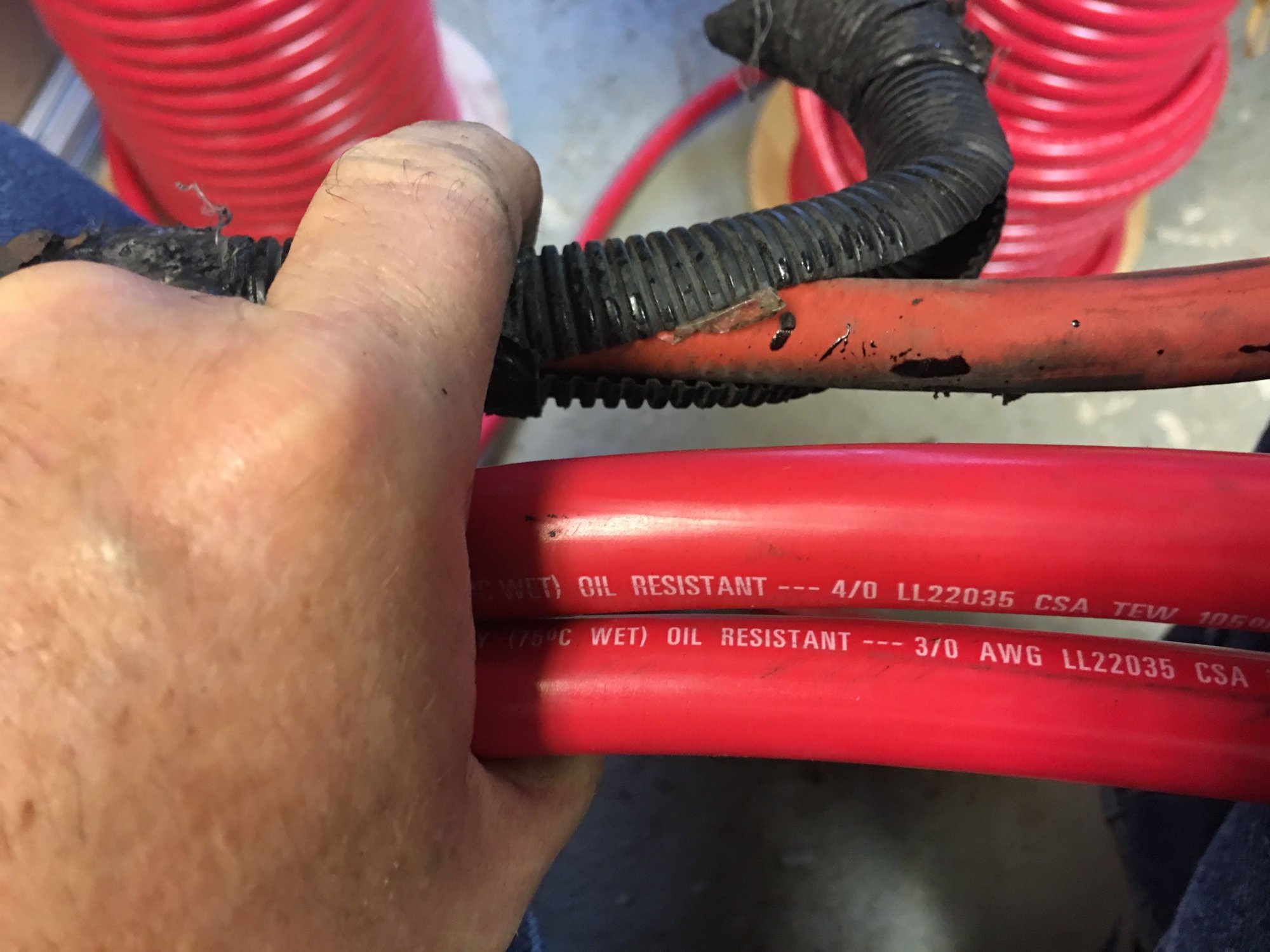

are these the same sizes yall are seeing stock. I'm a F450 but these seemed larger than I expected.

Expected then what? Relative or by the Ford service manual designations?
Sometimes the cables can funky to tell because of the insulation.
On my truck they fit into the scope of things.

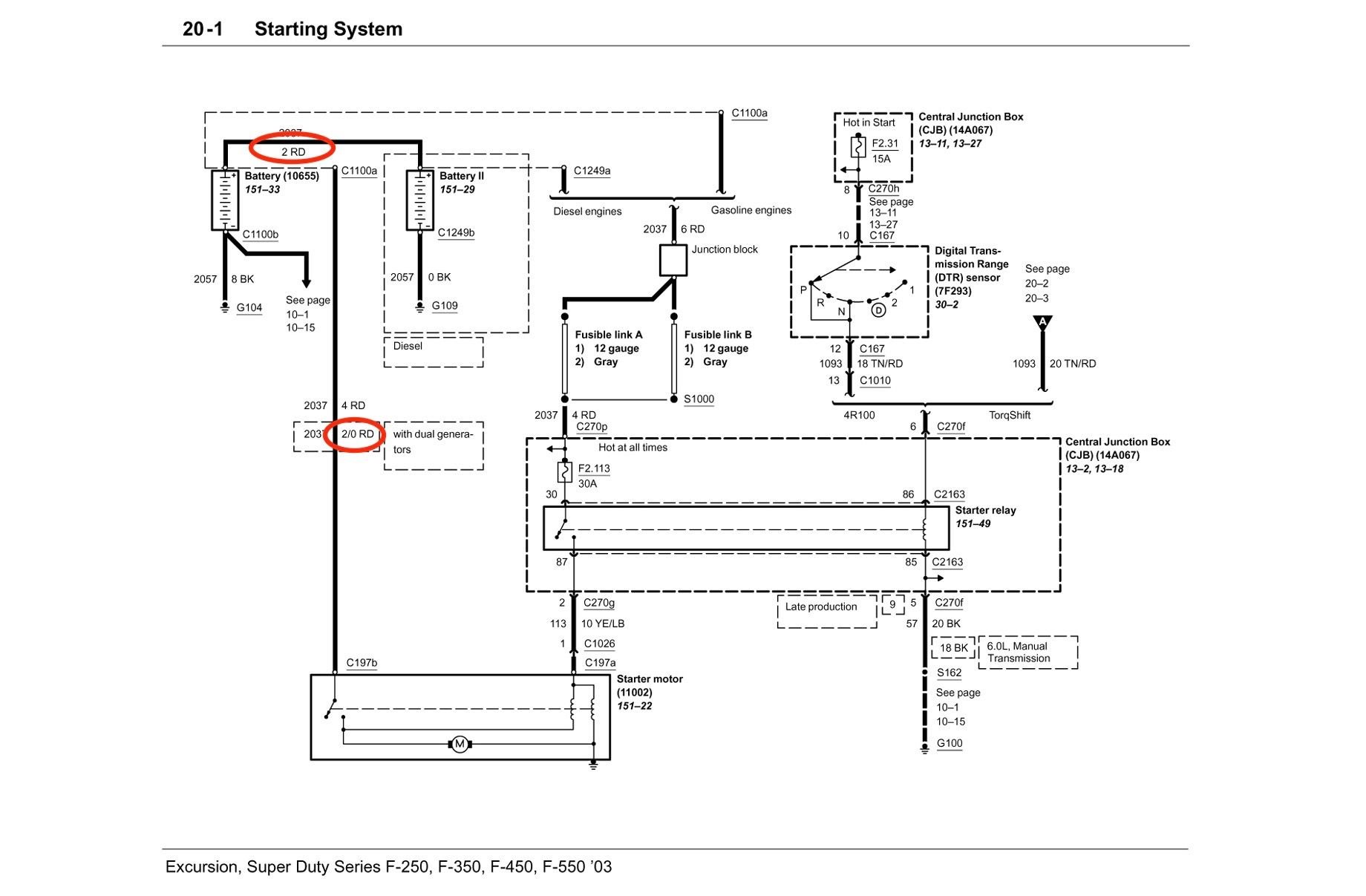

Thanks for the comparisons. I guess I didn't realize a 4/0 was that much larger. I have some partially stripped and corroded so I figured I'd just redo the bunch. I'm pulling the starter anyway to flush the coolant and going with a 6.7 starter at the end. Would a 4/0 work to do the battery to frame grounds, starter, both pos to alternator, and pos to pos. I was going to add a driver battery neg to engine as well.

i dont think you need to go that diameter and expense. I’m going to go up in size but not sure what I’d recommend at this point. I typically only recommend something I’ve proved is OK. I don’t want to feed the starter all it wants but diminish the voltage for the FICM during the starting event. Any other vehicle I’d feed the starter all it wants, but my opinion is we’re a little starved with most aftermarket batteries in the cold weather.
And yeah, I tend to be cautious.

I'd go up more then that for the battery to battery crossover which is now a 2ga, probably 1/0 to 2/0 minimum.
It sounds like you are going to use military terminals, and those typically use 3/8" bolts for the connections to lugs.
