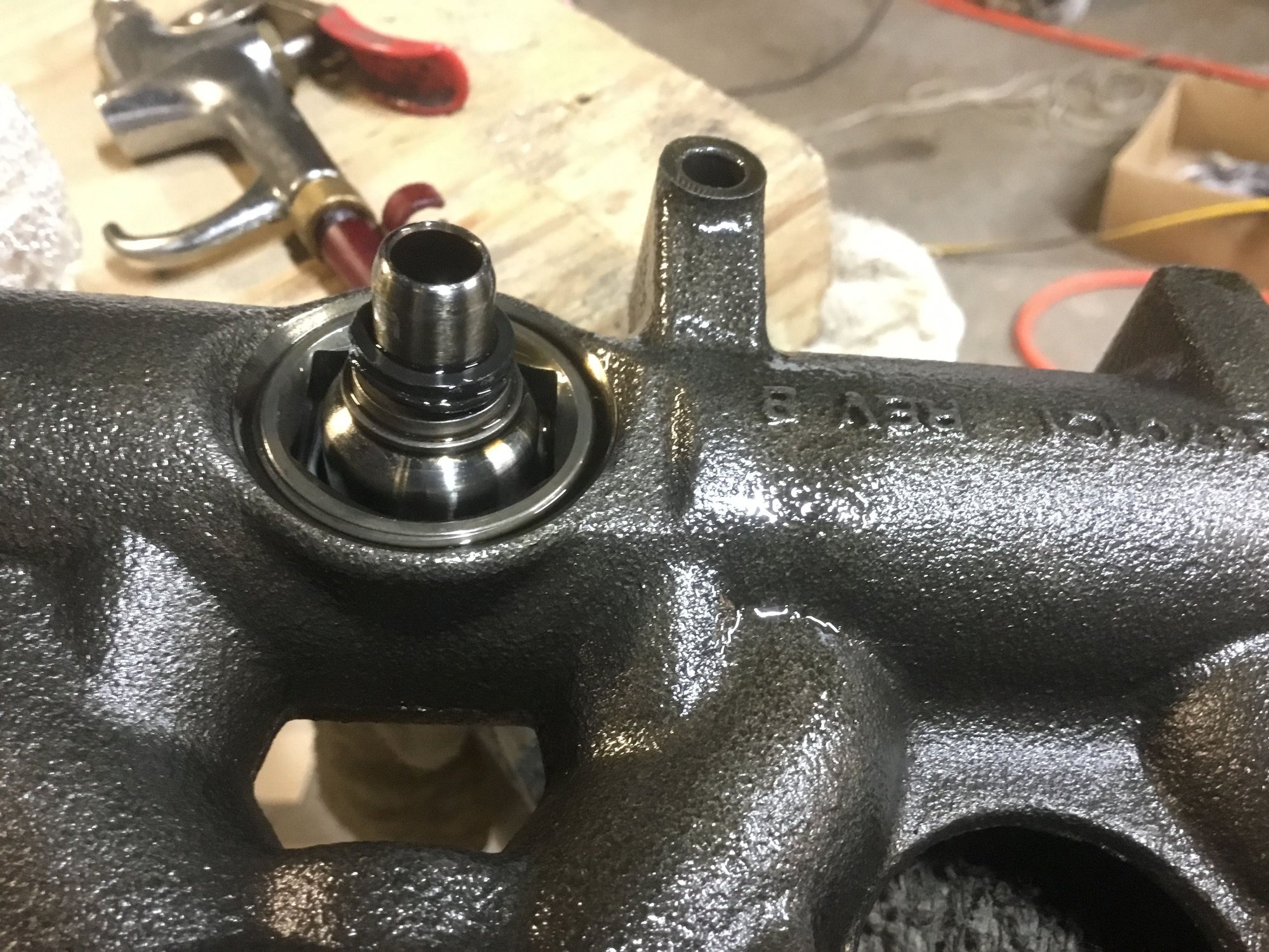

After fooling around for better than a week and ignoring that “slight” air leak under the drivers side valve cover I decided to take it off. I found my leak. This is what I get for ignoring the step by step process (and that slight leak). I had convinced myself that the HPOP was bad and I ignored everything else. (Hard Headed). I have never seen or heard of the top “C” clip and the “D”? ring blowing off. I didn’t trust that injector not to do it again, so I replaced it and resealed all injectors on that side. That was it . When I first pulled it off I nearly had a stroke when I couldn’t find the clip or the ring. I just knew that they had fallen down into the head. Gave up and walked over to the oil rail to check it out and there they were.

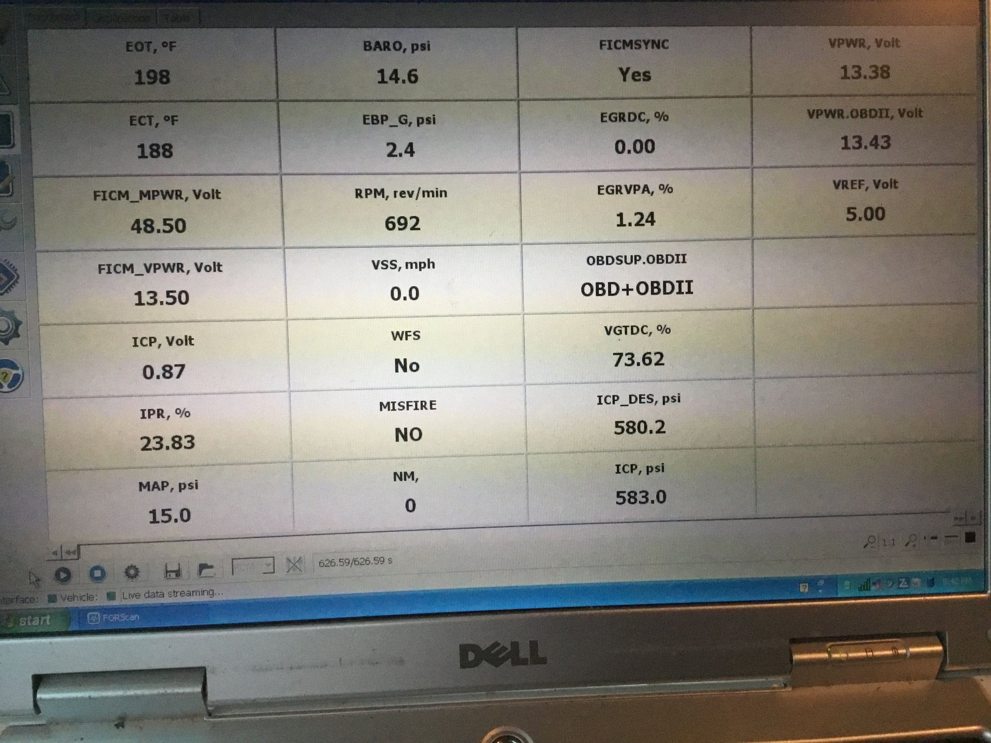

Put everything back together, and with very little cranking she fired up. The bright side is I put in my new wiring harness and a IPR gen2 EGR delete. As of now I only have the ABS code to deal with. It states left wheel sensor.
