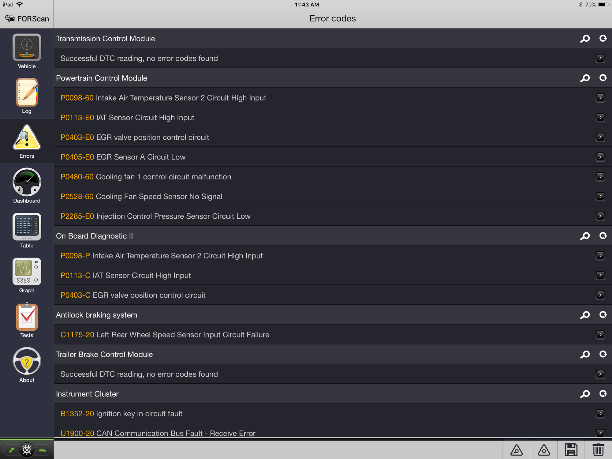

Got my hands full with daughters/son-in laws/grandkids. Would rather spend time with them than work on my truck. BUT did repair IAT wiring problem. Still shows up on DTC’s. Here is my last. AND if you feel like it is the FICM i’ll Replace it tomorrow.

Also had wheel sensor pop up that hasn’t been there before. Sounds like a wiring mess

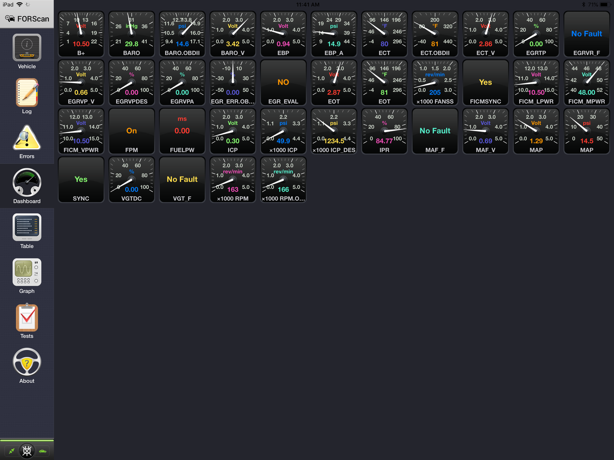

Changed FICM this morning with a known good one. Nothing. Cranked with ICP,EGR and Fan unplugged. Nothing. Relooked at fuel bowl filling and got diesel everywhere. Checked for bubbles none. First cranking I had FPW at 1.82. Next two crankings had no FPW. Images are with everything plugged in and last cranking.

1st cranking was with ICP unplugged and I got FPW. Other two was with ICP plugged in and no FPW.

Gotcha - looks like an air test is next, seems like the low pressure reading is real. Did you verify the LPOP filling the oil filter housing and that the drain plug works (closes) when pushed down? I figure it is fine, but you never know.

It is a "stumper" since the STC and dummy plugs have been changed. Usually a stuck open IPR will show a few hundred psi. It may be a rare HPOP failure also.
