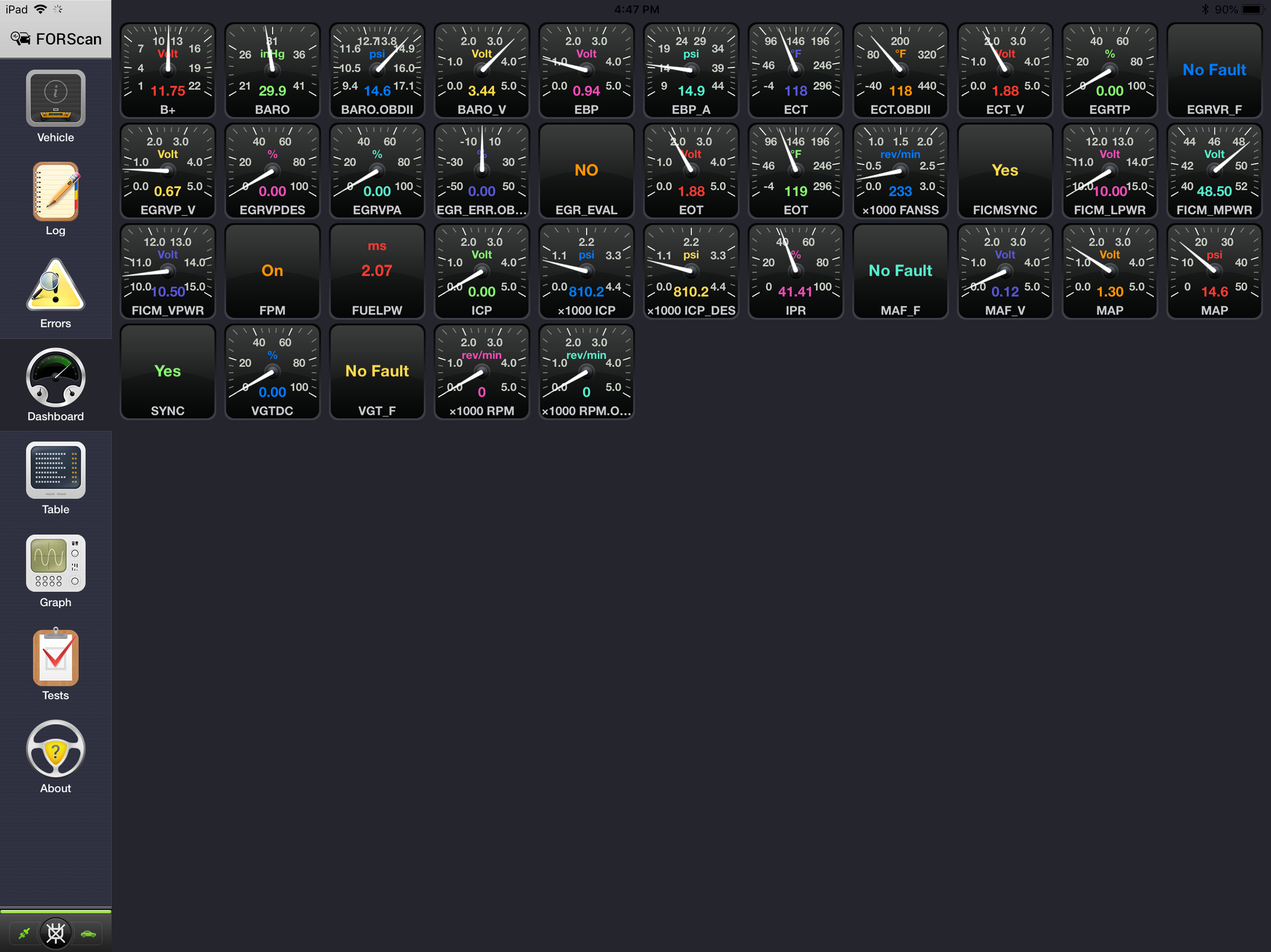

So, it looks like your FICM logic power is well below your FICM vehicle Power.
Also, are you not getting any rpm signal?
Here is cranking with ICP unplugged.
Thats when I had to turn loose of key to get a screen shot. I’ll have somebody here tomorrow to lend a helping hand on cranking and screen shots.

Also, vreference voltage?

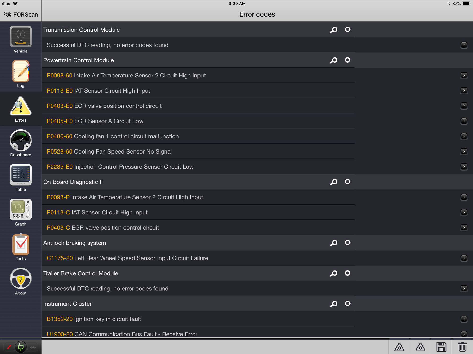

Plugged everything back in and here is this morning readings
