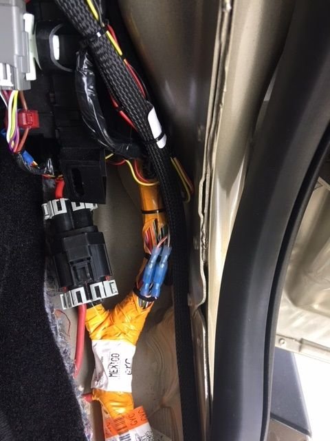

I tapped in to the factory wire at kicks (blue male/female connectors). I'm running 200 watts to each door on the factory run with no issues. Pic doesn't show 14 gauge plugged in. Pic was when I was verifying polarity and wire colors. I cut ends off factory wiring in door and did my own connectors for speakers. Same thing for rear speakers with no issues.
Shane

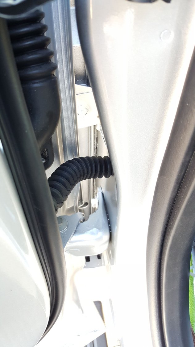

Ran all new speaker wires. Used the DSR1 for the install with maestro harness.

How'd you run the wires through the doors? That just looked like a total pain in the *** to me. 3 feet of stock wiring isnt going to give you any noticeable differences so I just reused what was already ran.
took the boot off that was tight as hell and ran them through there. It was a pain in the a$$

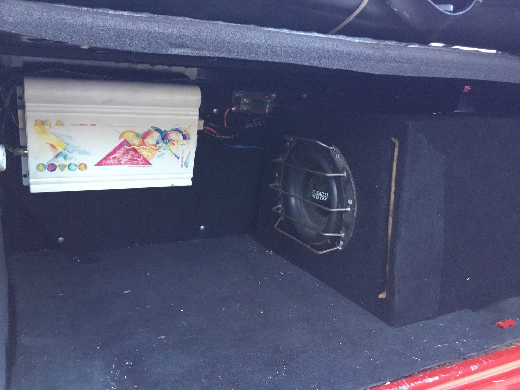

Love the old PPI Art Amps! I’m running an A600 in my jeep on a SA-8 V2 duel 2ohm sub still.
