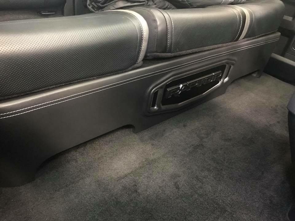

I've been working on mine this week. Preview pic. Waiting on some RCA's to route but it's playing. Still have to install speakers but that's all that's mainly left. Enclosure will look like pic without Raptor logo. List of equipment.
(2) JL Audio 900/5 HD
(1) Masconi 6to8 processor
Tweeters (Morel MT-250 Front Pillars)
Mids ( Audio Frog GS 690 6x9 Front Doors)
Focal Flax PC165F coaxs Rear Doors
(2) JL Audio 13TW5v2 Subs in a MTI Enclosure
One 900/5 is bridged on 6x9's in doors and running a 13TW5. The other 900/5 is running tweeters and rears speakers and the other 13Tw5. Head room won't be an issue.
Shane
I wanted to do tw5 but the audio shop told me the tw3 sound better? The installer said the tw5 sound hollow? Have you herd both subs back to back?
