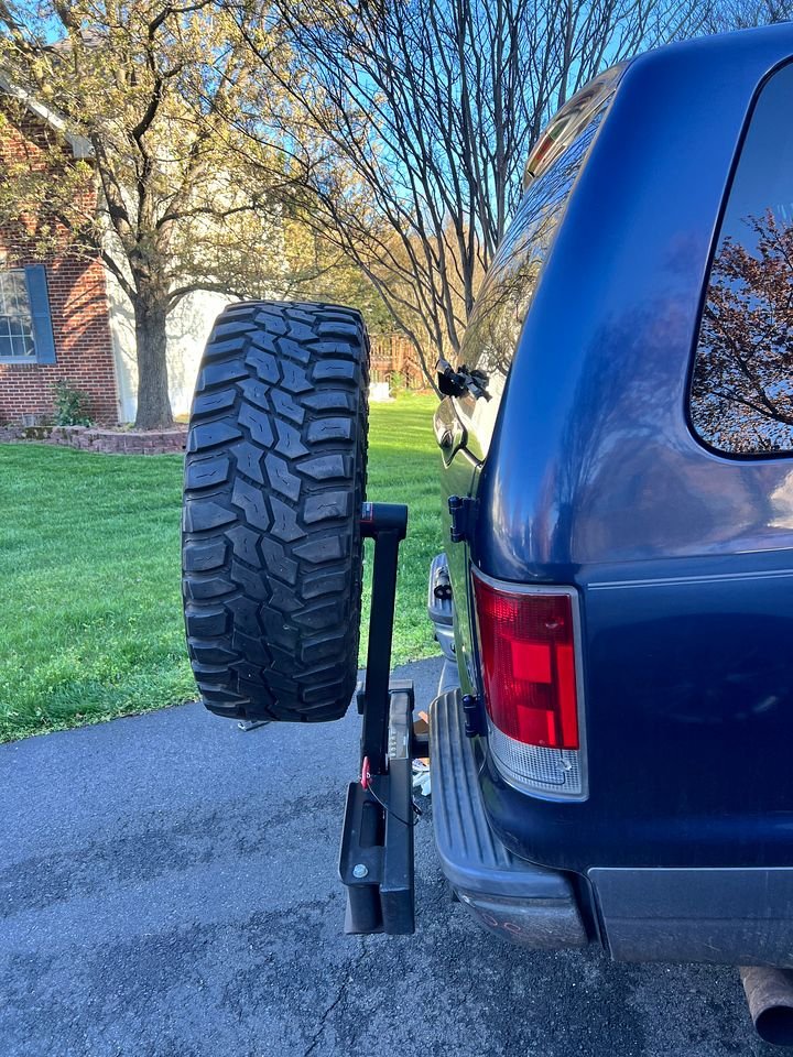

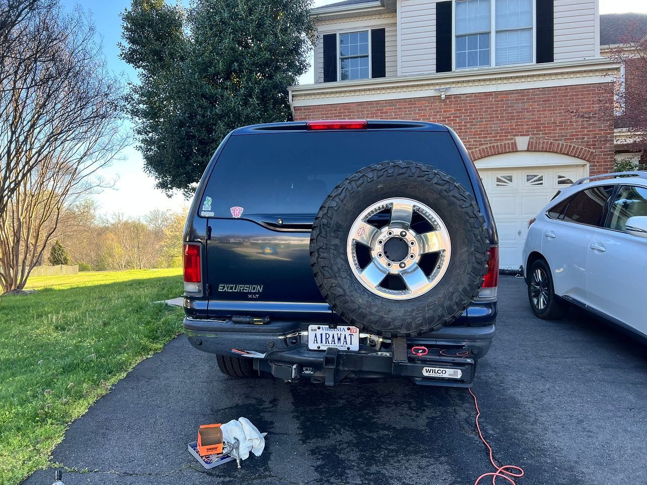

Mounted the 35" spare on an external Wilco swingout mount. Haven't driven it yet after mounting. I bought the wilco unit used on Marketplace. PO had modified the arm to be a bit shorter, but it definitely opens enough for the barn doors to open up to 90*.

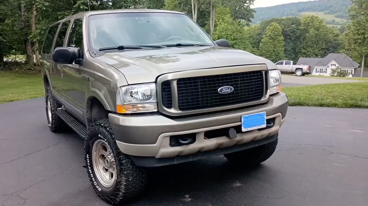

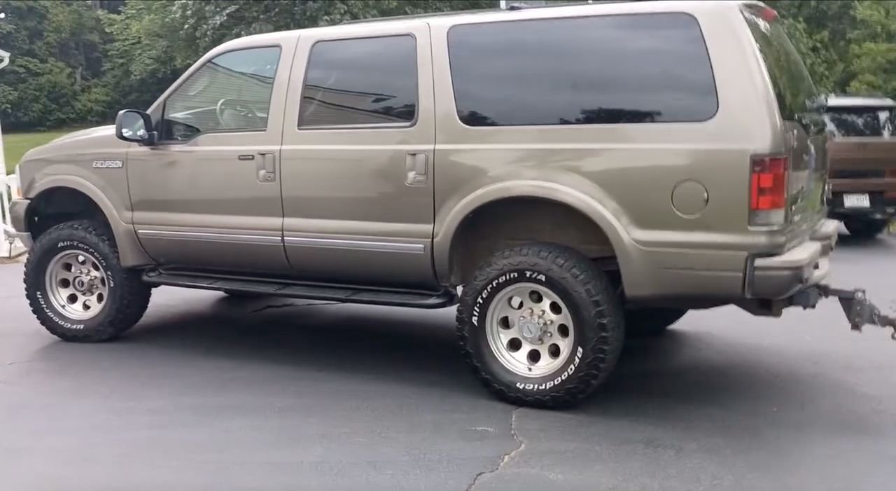

  • 7/11/25: Picked up my new-to-me 2003 Excursion Limited. This is my first v10.
  • Truck already has a 4" Rough country lift installed with ProComp 18" wheels and 35" BFG A/T KO2 tires. Speedometer has been corrected
