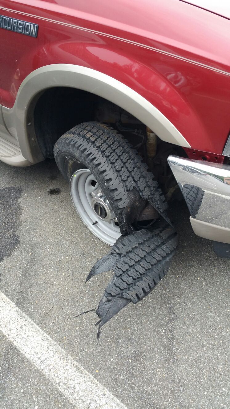

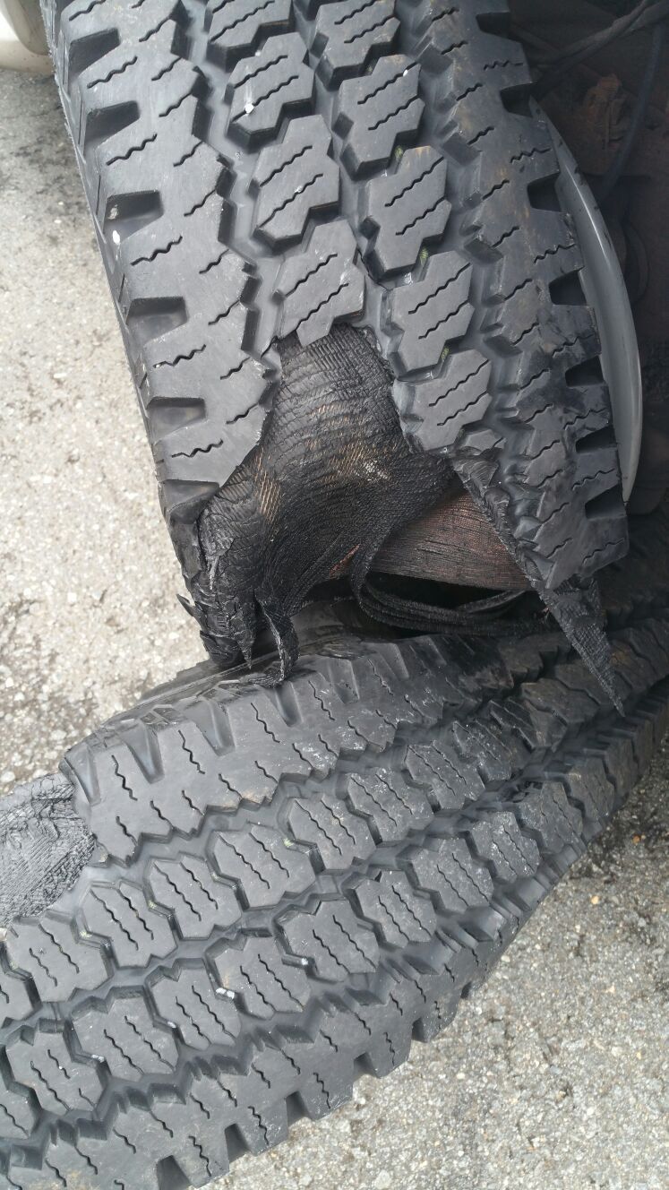

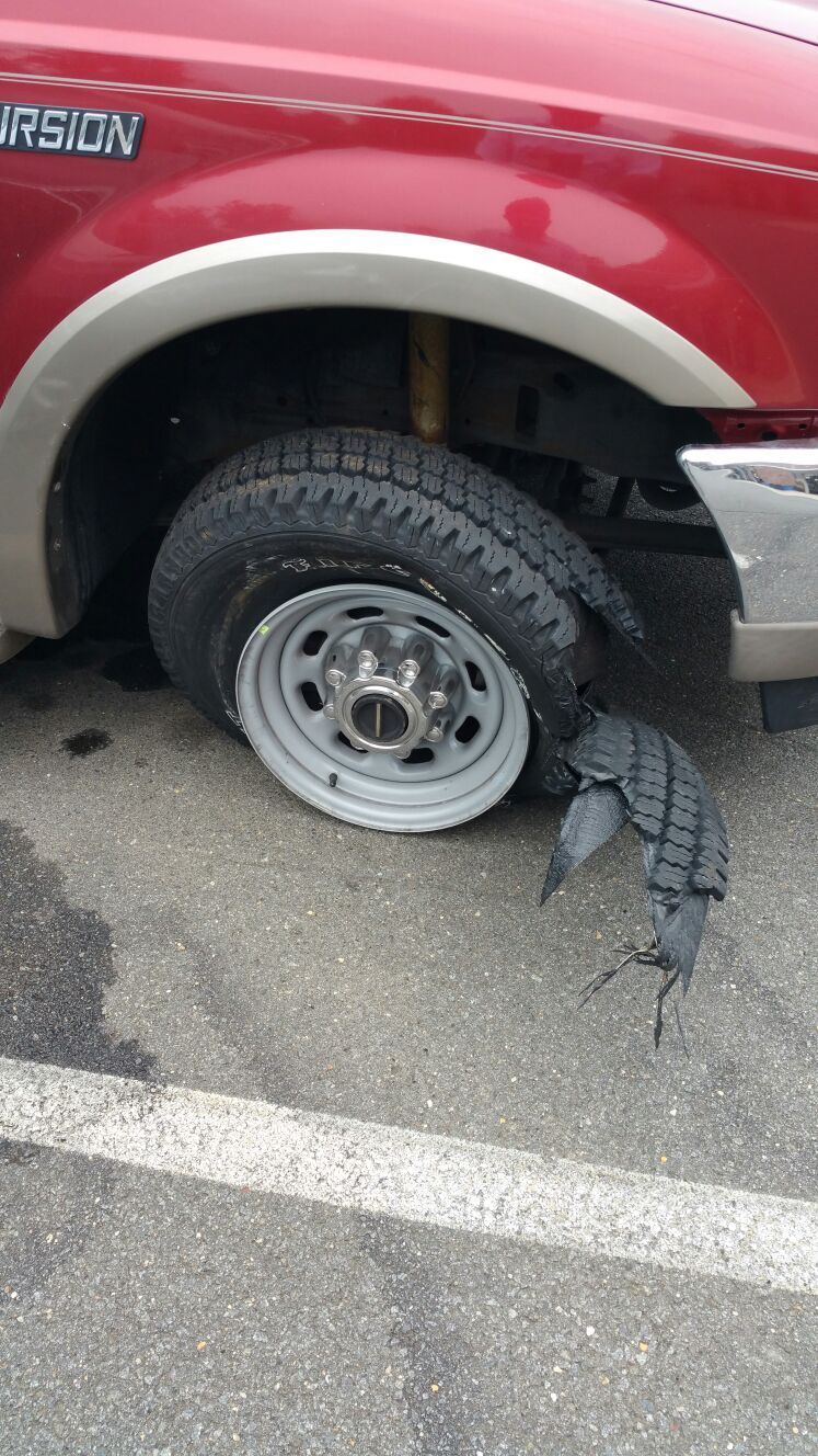

Well...what an afternoon. Back home safe now. Glad I was at a stopped at a light when the tire went boom!
This was the spare that came with the truck in '00. I installed this on the truck after the Michelin went boom about a month ago. The red & yellow stripes on the tire were fresh when I installed the spare and drove ~1500 miles.
How many techs does it take to figure out where and how to put a jack and lift up the EX?

Looks like a vintage Firestone Steeltex tire. Mine looked the same in 2002 when it grenaded too.
Sean
Yes. This was the vintage spare tire that came with the truck. It was never installed in its 17+ years of life. Found out that the RMA (Rubber Mfrs. Assocn.) says that a tire's shelf life is no more than 6-7 years. Guess it is better to rotate spare tires every once in a while
