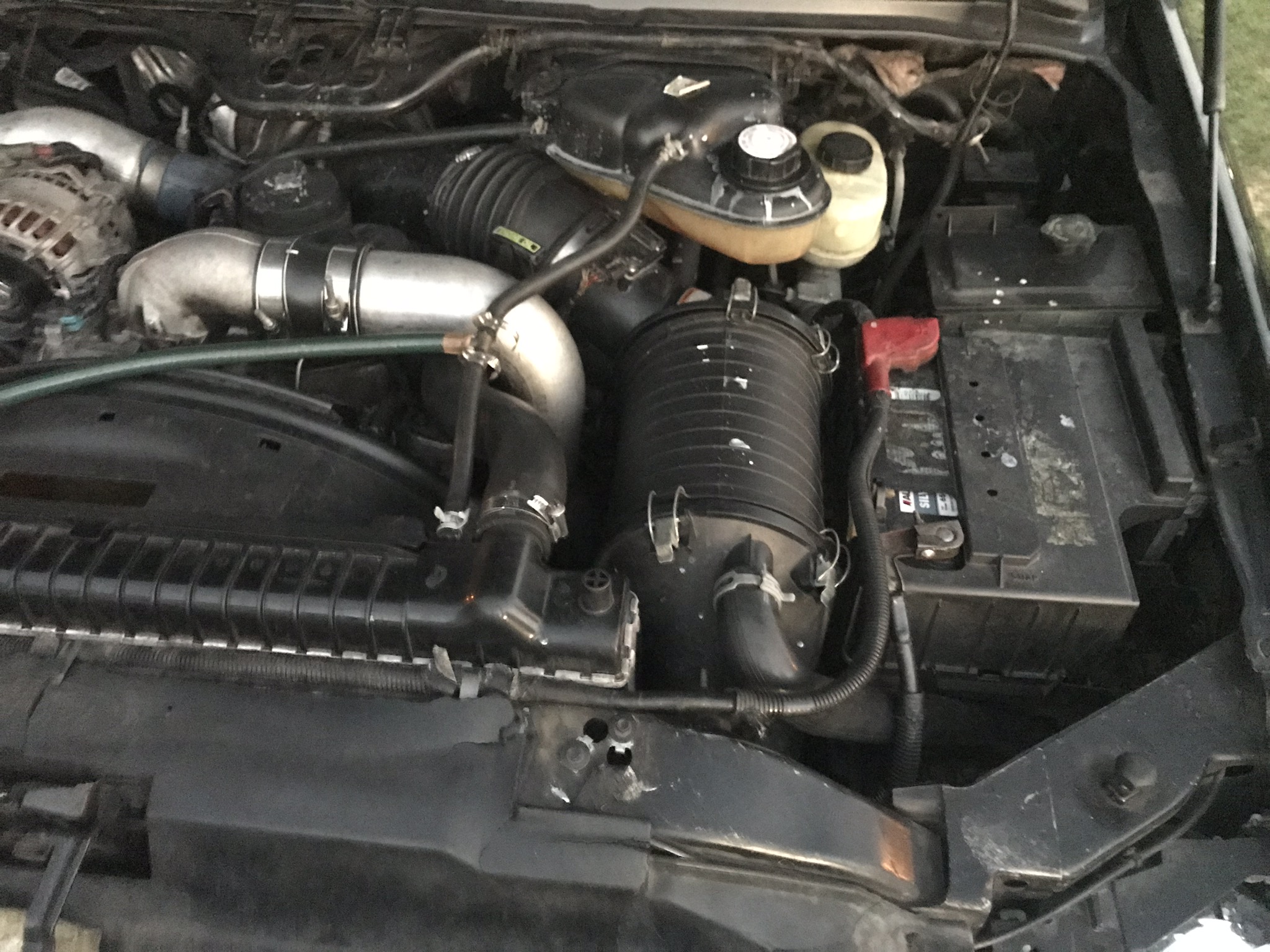

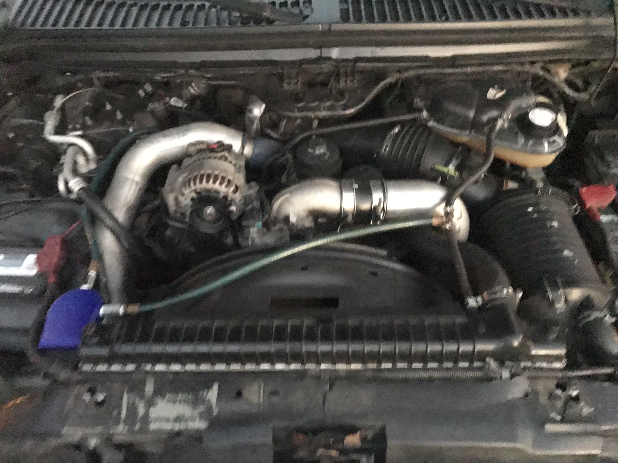

Originally Posted by boatn19
Going to check this now. But would you explain “heater box”? Where is it?
Attachment 248526
Attachment 248527
You do know that the radiator top mounts are missing in these two images ?
oh boy do I, kind of a sore subject but Pats automotive in Goose creek South Carolina removed them when they were giving me an estimate for repair and replace of the water pump I went back there four times cause they were never opened during working hours and they denied ever removing them I need to order replacements soon.
