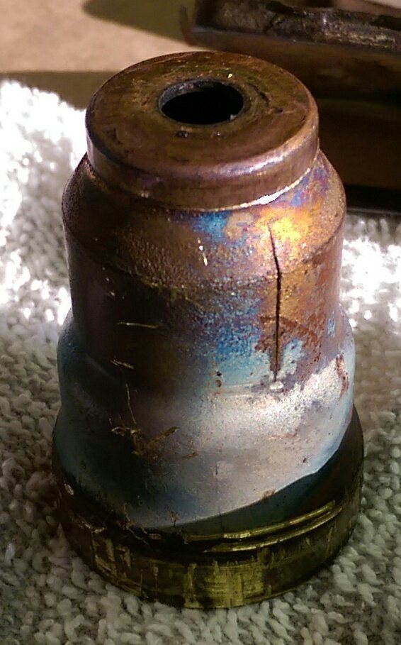

Good and bad news
Good news: #2 injector cup is out and I think I have the procedure figured out.
The discoloration is from the torch I used to heat the brass to help removal from the tap tool.
Notice the vertical "vent" LOL.
The Bad news:
I dropped some brass fuzz down the cylinder
I forgot to put the penny in the bottom first and my initial attempt at removal just stripped out like Rich's. I had to really crank the tap down in there to get a good bite on it (see the pic above)
I tried to fish out the brass stuff between attempts and knocked some down in the cylinder hole. I cranked the engine with the pulley to get #2 to TDC (used a piece of wire to feel the piston until it stopped rising)
My plan is to maybe use the Mighty vac and fish around with a tub down the hole....maybe use a shop vac?
Any tips or tricks to getting it out?
How big of a deal is the brass in the cylinder?
It was only one small coil that I knocked it, but no way of knowing if other small pieces get in there....
Thanks.
PS- I captured my ELC coolant. NO petrol products floating on top of it and no discernible diesel smells

Do you have compressed air? While vacuuming out through the injector hole, apply compressed air through the GP hole to "stir things up". I did short blasts, but I didn't have anything I knew of to clean out. I used a regular wet vac with the smaller (1.5"?) tube just stuck over the injector hole, so it was also sucking the oil, fuel and coolant passages too. But the shop air was the real mover of debris within the cylinder.
