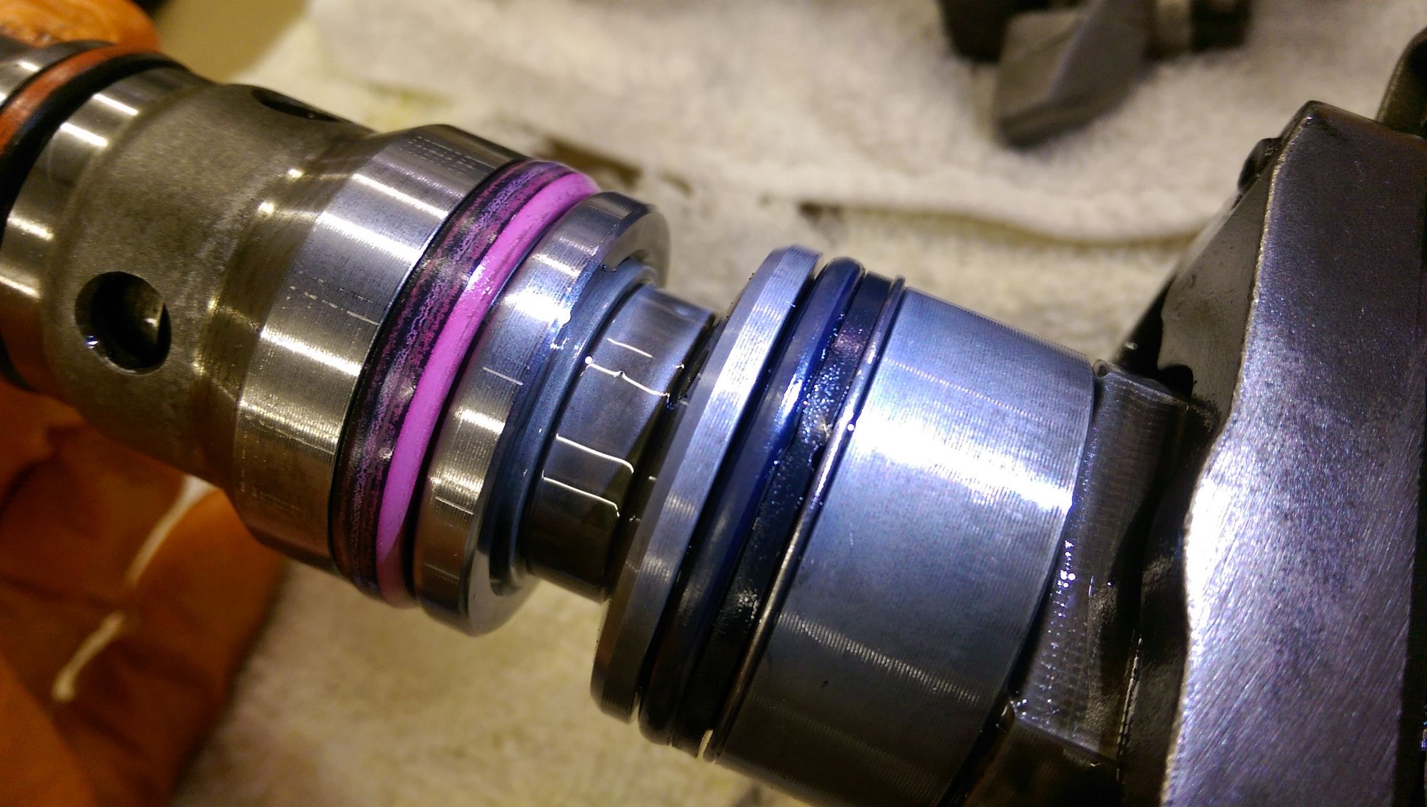

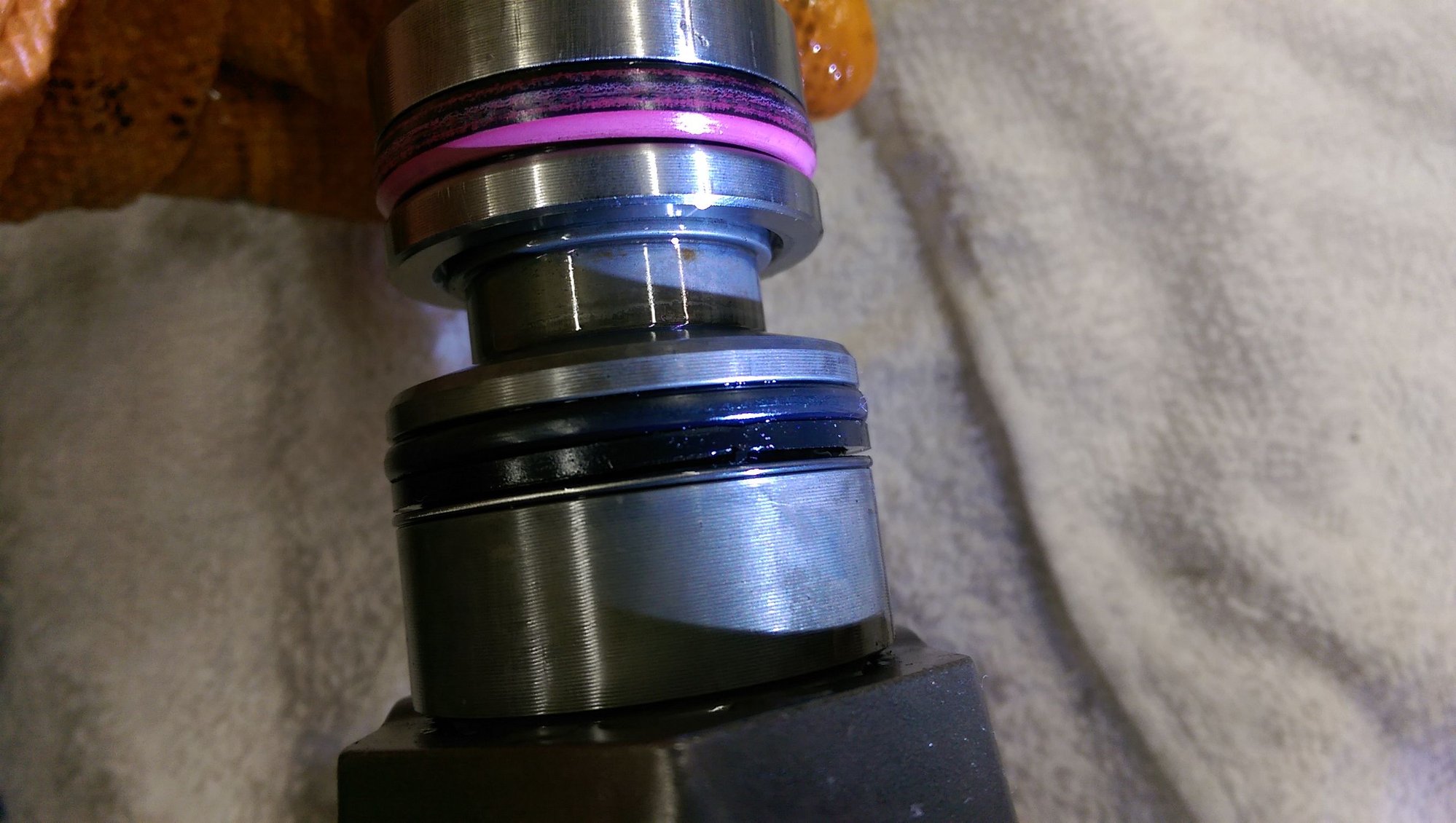

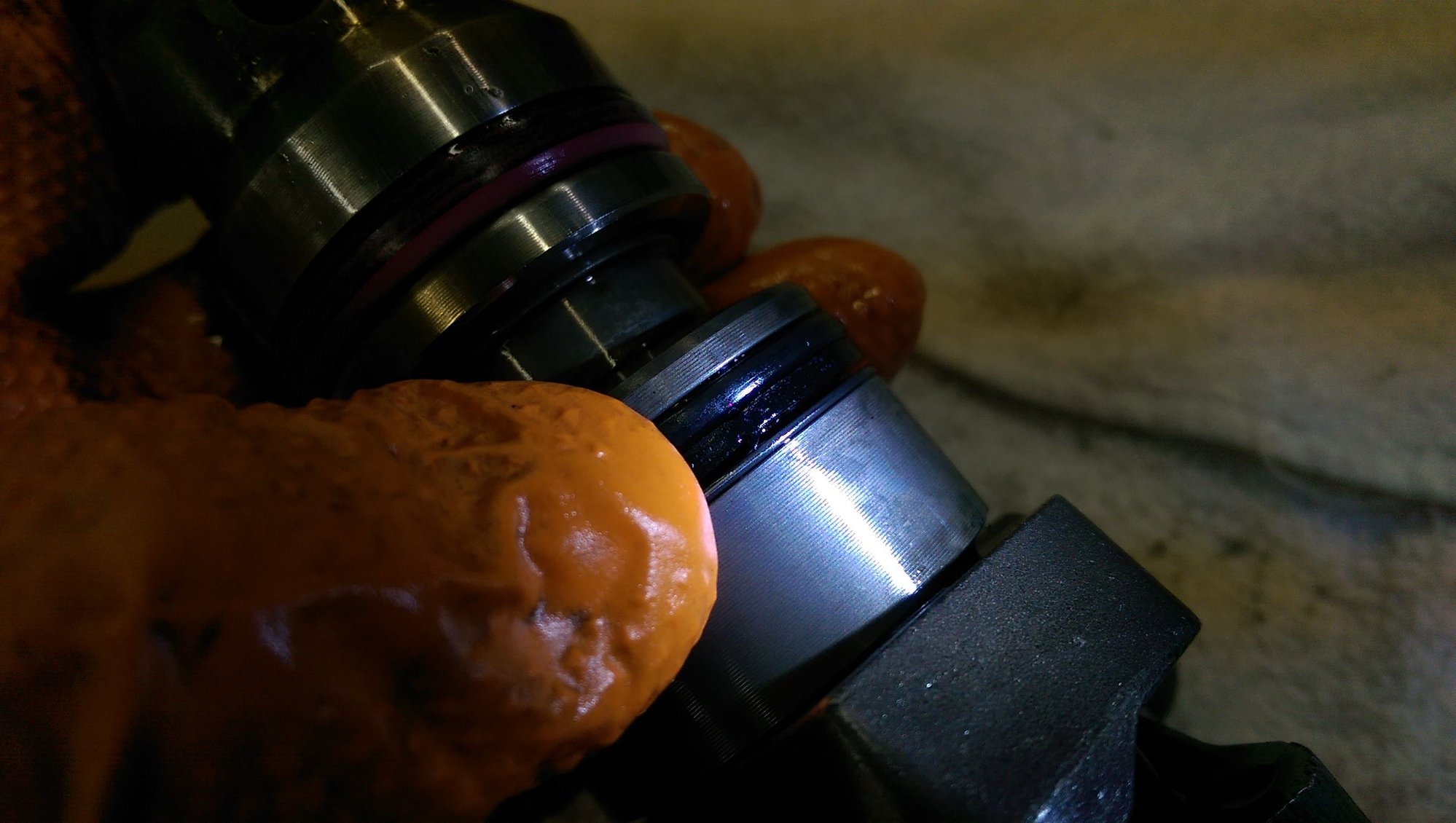

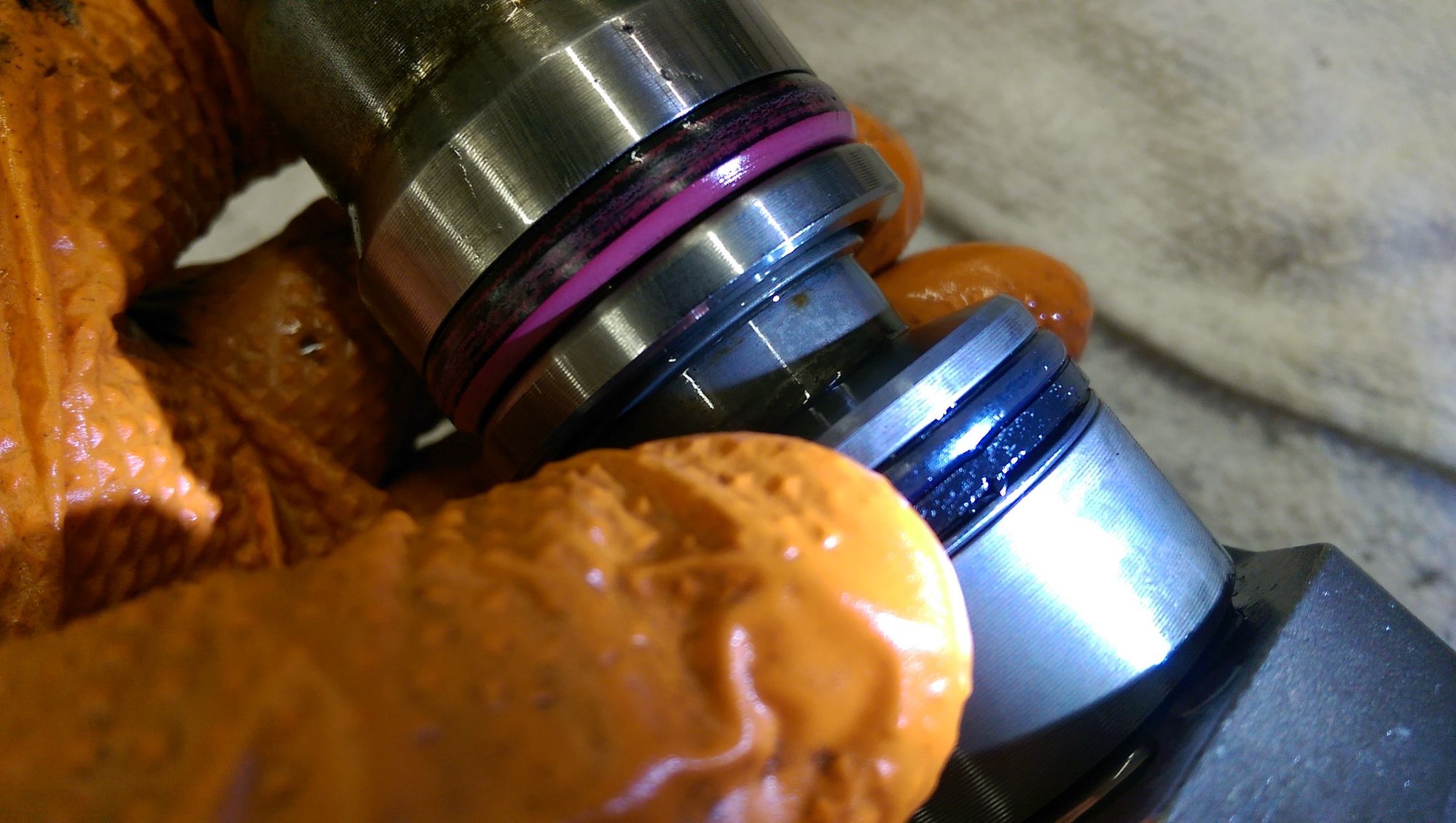

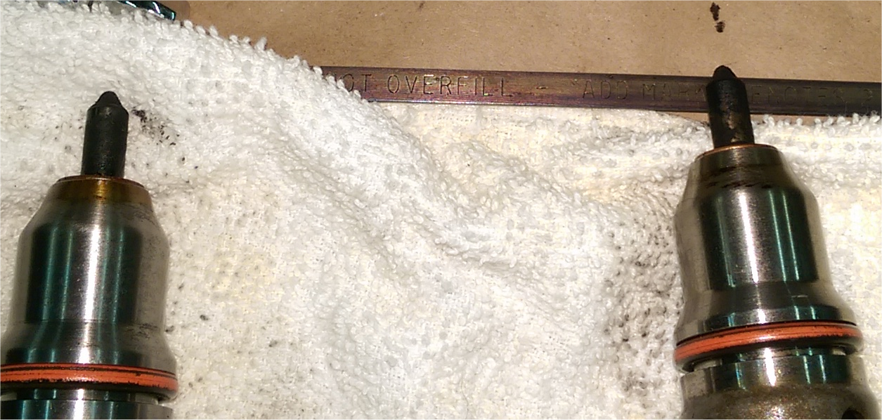

Injector oring failure pics

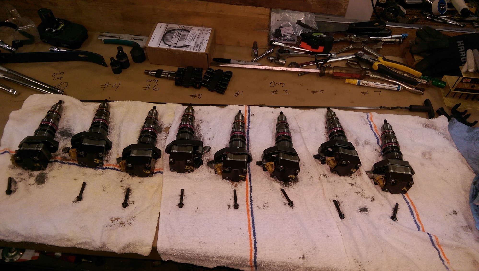

Overall results
So this is what we have so far...

What to do about the tips?
Should I clean them up, worry, do nothing? They pretty much all look just the same.

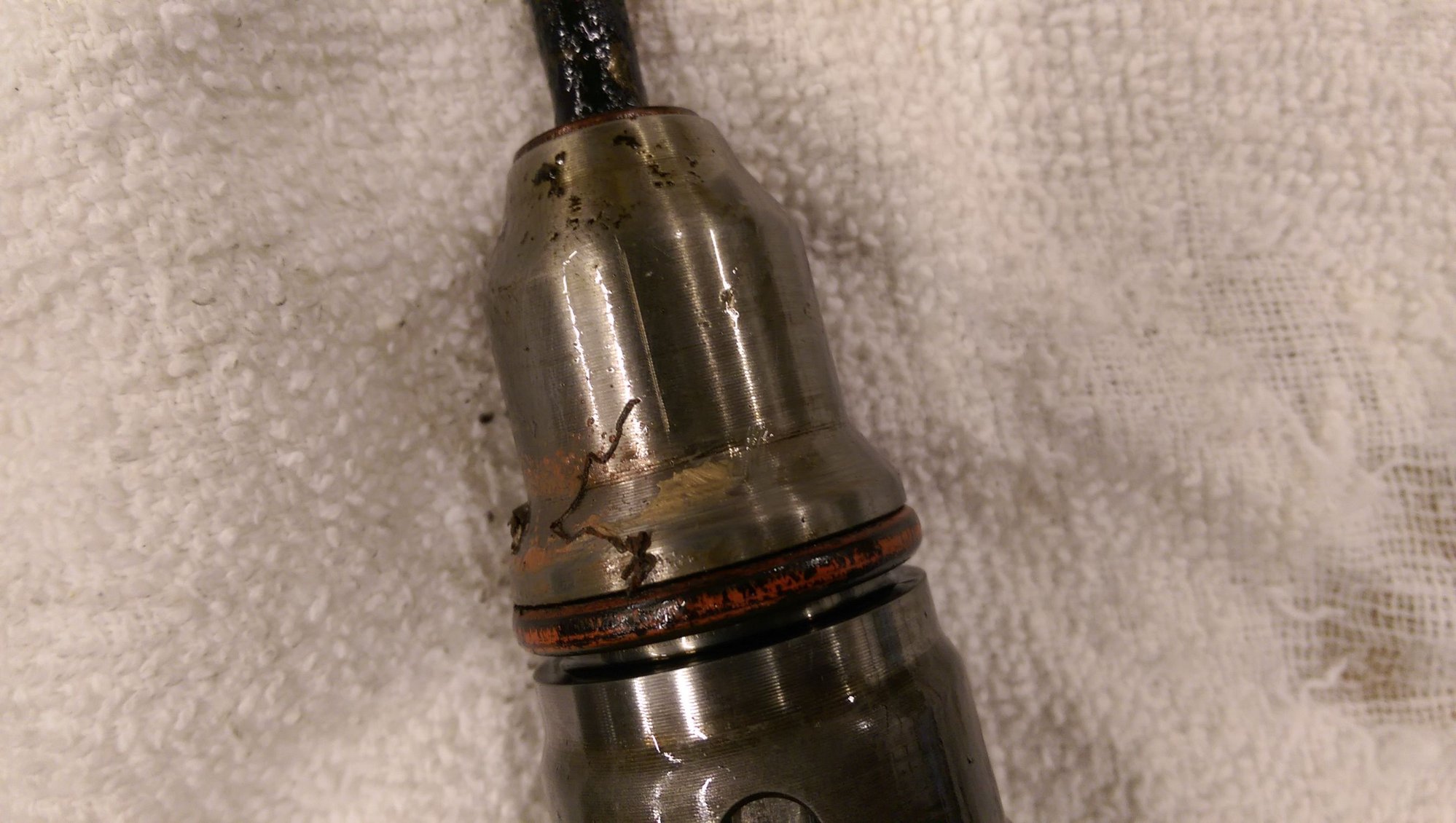

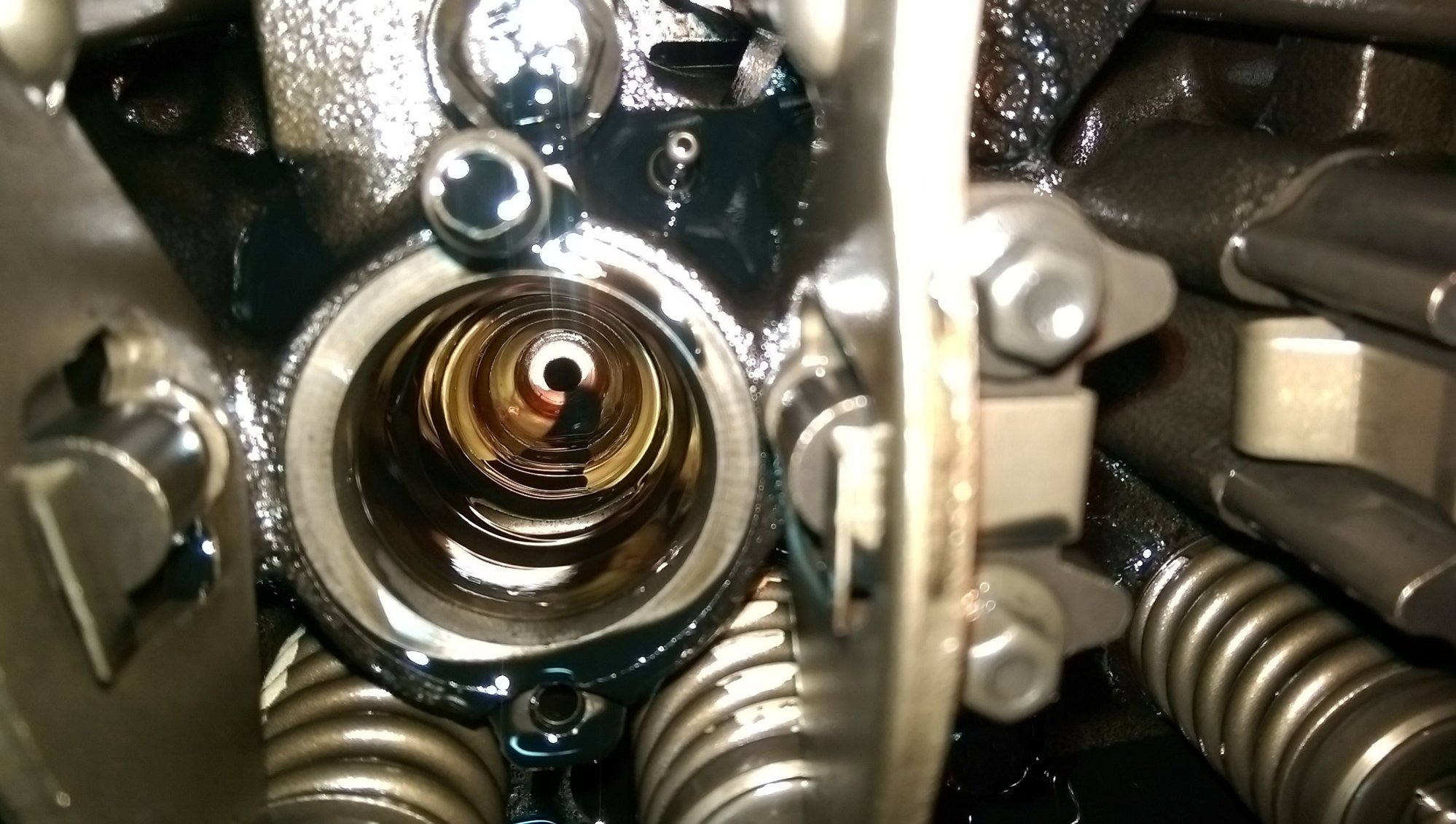

Bad cup
Pic of #2 cylinder with bad cup

Short video of coolant running into cylinder through tear in the injector cup of #2 cylinder.

It is early and everyday that goes by my eyes get a bit worse, but I don't see any blemishes or damage to the o-rings based on the pictures. I am sure if I were standing next to you in the garage I would see what you are seeing though.
Definitely a bad seal on the cup, as you already know. If it were me, I would not install the Dorman cups if you can help it.
If I were in your situation and presumably on a tight budget, I would replace all of the o-rings with Alliant, the bad cups with Alliant and put the stock injectors back in. Although, if you have $2000 to spend, look at getting some new injectors.

Injector oring failure zoomed pic
See if this helps.
No new injectors for me
I am going to scramble a bit to find some cups and stuff today...
