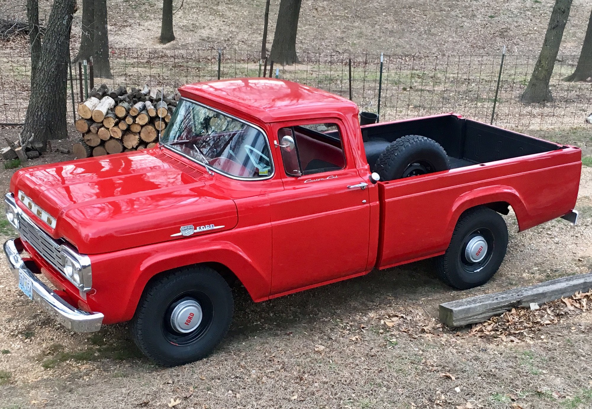

Old Mar 23, 2018 | 06:30 PM
  #64
Pobo's Avatar
Pobo
Joined: Apr 2017
Posts: 56
Old Mar 25, 2018 | 11:21 AM

Nice find, this truck is set up 10 years ahead of its time, not just the auto and power steering, you have the solid wheels as well ). A keeper! The Dana 60 was available with higher gears in the late 60's and 70's, a rear end shop should be able to install a 3.73 or ( 3.54 for flater terrain ) for higher road speeds.

Thank You! Reluctant to change anything - like to keep it as original as possible. Thing is low-geared though. We both happy cruising in the neighborhood of 50mph!
