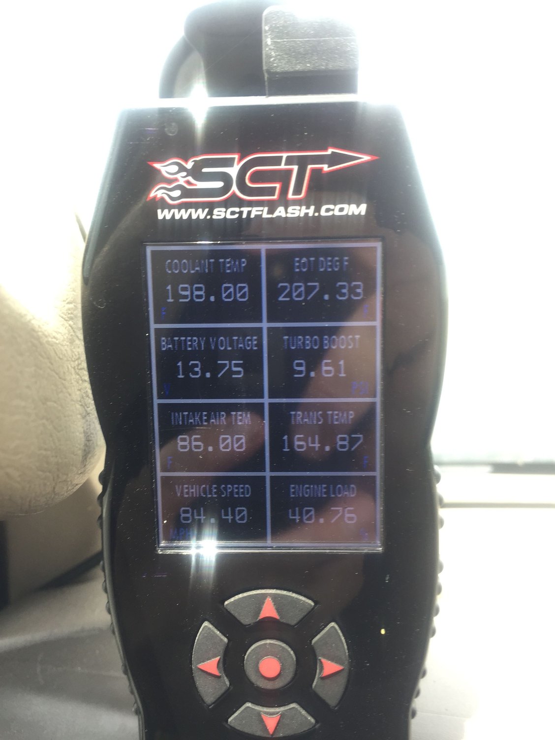

Never ran so cool...I am stoked to see how she pulls the boat Monday. I was running almost 210 ECT at 70mph when it was 79 degrees outside. The ECT/EOT delta levels off at 5-6 degrees, it was not leveled out in the photo. Much better!
