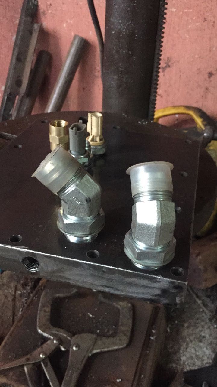

Originally Posted by SmackDaddy
Man that is almost enough to make me add a remote oil cooler...
I did the 7.3 fan clutch mod with the BPD fan clutch adapter and it helped cool my truck down much better than the electric 6.0 clutch. I also found an all aluminum Mishimoto radiator for less than $400 to get the plastic one out of there...
I just posted pics of my own remote oil cooler and adapter plate. Take a look!!!

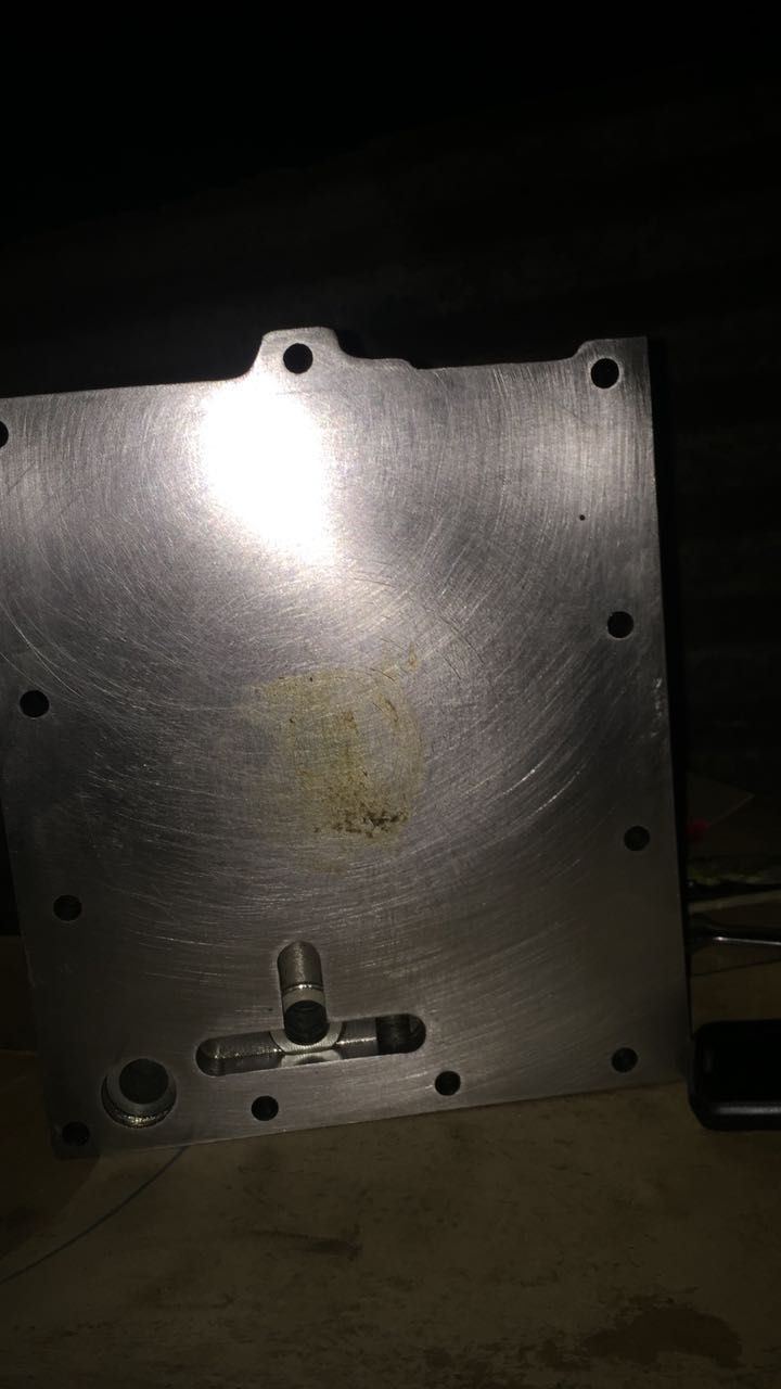

Chbin Chilla, I would like to know more about the DIY Oli Cooler and adapter plate. Please post pics. Do you have a drawing for the plate?
Thanks
Old Feb 25, 2018 | 11:34 PM
Chin Chilla's Avatar
Chin Chilla
Joined: Dec 2017
Posts: 12
I actually don’t have a diagram of the plate I built. Just got the idea from another guy on the web. I made a thread about it but nobody took the time to even look at it. The plate works as it should be: deleting factory oil filtration system and addin a more reliable. I’m already building them for sale locally in Guatemala and have 3 orders for some of my friends over there in TX. I’m not tryna make big bucks here but instead providing a less expensive way to take care of your truck.
