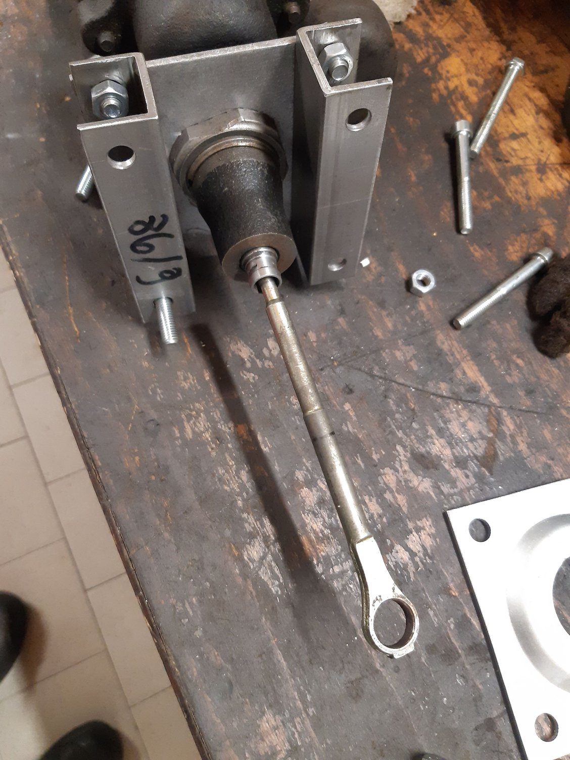

Originally Posted by ingo
As I wasn't happy with how my brake pedal felt when braking, I decided to upgrade to a Hydroboost brake booster....
I removed the good old piece from a friend's Chevy G20 Van.
As this neck was too long, I first had to fabricate an adapter.
after that i noticed the original Chevy retaining plate was angled and i couldn´t use it neither in one direction nor in the other, i had to make my own.
more to come...
I noticed that I hadn't finished my “Hydroboost” chapter yet.

The fabricated adapter painted and installed.
When I filled the old G20 master brake cylinder, the brake fluid leaked out again at the bottom. So I ordered a new one.

I had to have some of the Chevy hydraulic lines repressed or have suitable connections flared.
Later, I had the metal ends freshly galvanized.

Hydroboost comleted, before i start EFI
The Hydroboost Brake is ready.
And I have to tell you, that was one of the best decisions I made regarding this truck. It brakes absolutely fantastically now, like a modern vehicle, with excellent braking performance requiring very little pedal force and wonderfully controllable.
