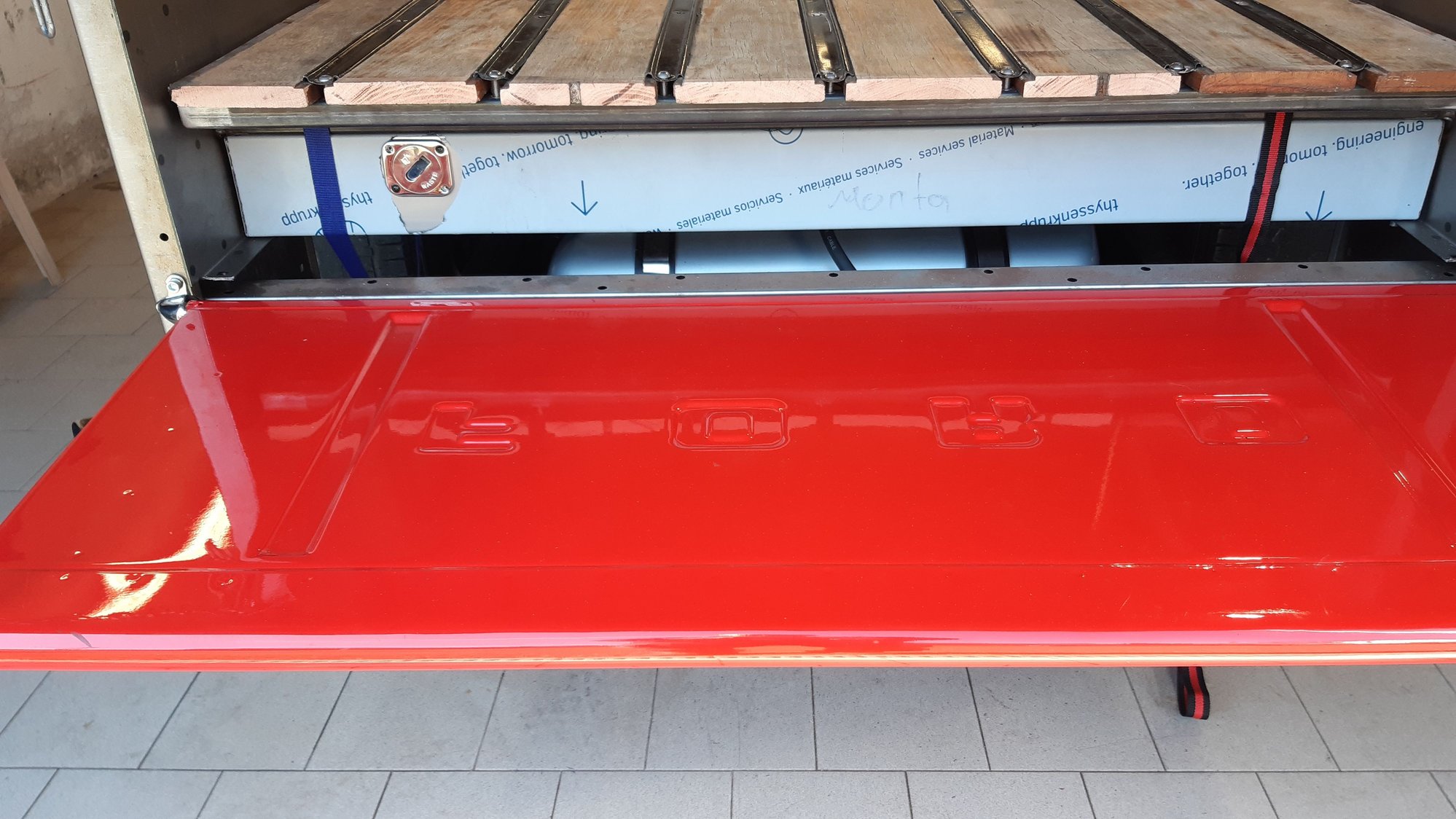

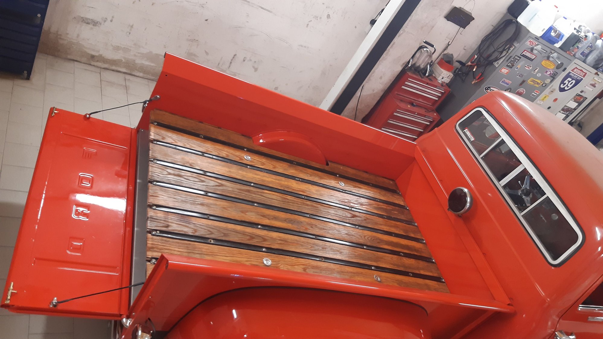

Since my daughter wanted to do some errands with the Truck for her 21st birthday, I quickly fitted the bedwood floor and the tailgate.

Nice finish color and I like the black bed strips.

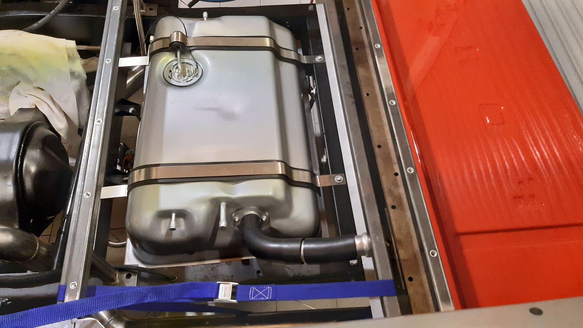

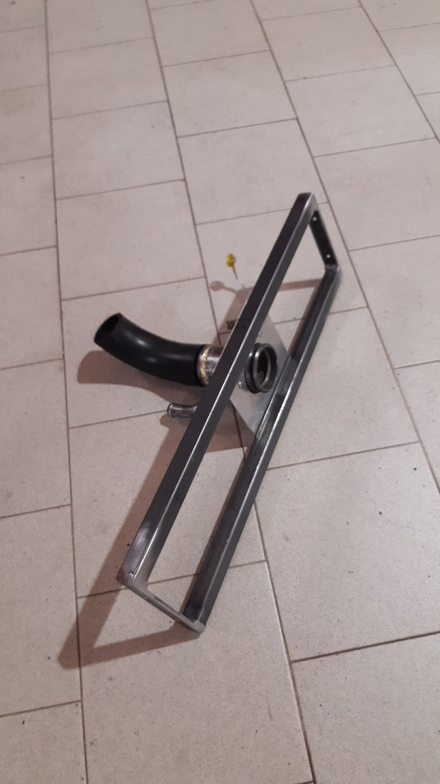

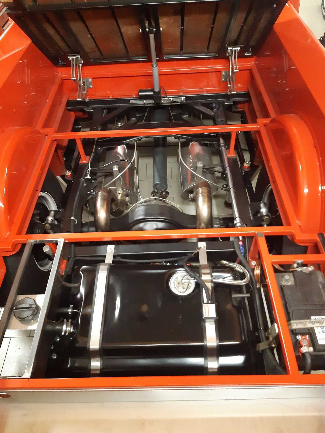

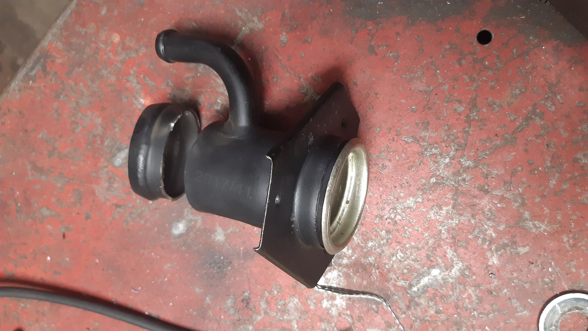

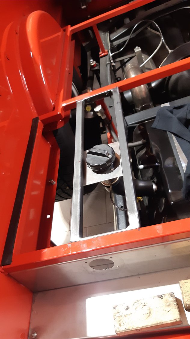

I was very unhappy with my original idea of the tank filler neck. It was too shallow, had too little gradient and the nozzle kept switching off when filling. I had built the tank filler neck into the rear panel so that I only had to open the tailgate to refuel. The idea behind this was that I was afraid I would have to fill up at some point when the bed was fully loaded. That's why I didn't want to make the filler neck in the bed floor and i did not want to cut one of the boards. But when do you ever have the bed of a truck like this fully loaded? So I decided to move the tank filler neck to the bed floor to make filling easier. Now I just have to cut a piece out of the board and make the cut-out piece foldable or removable and reusable.
before:
Fabrictated a little frame.

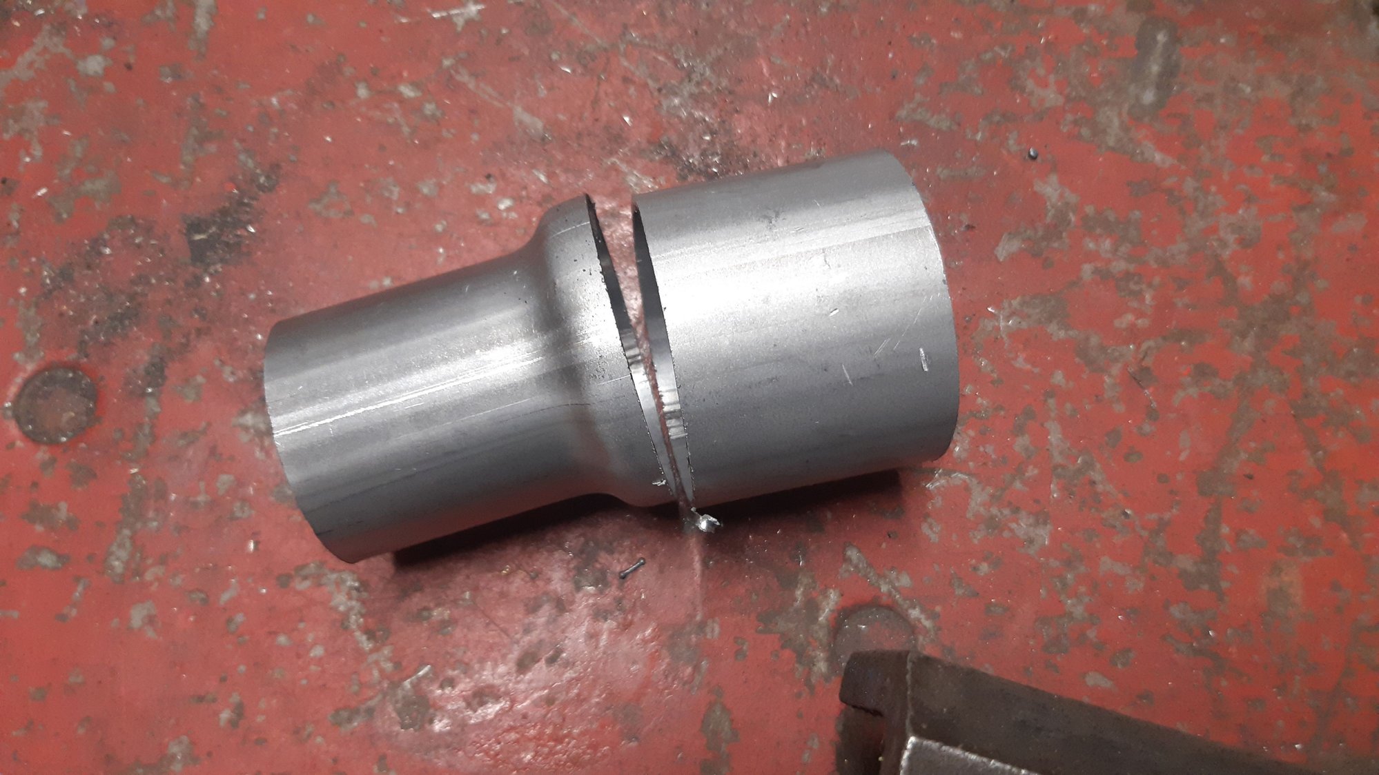

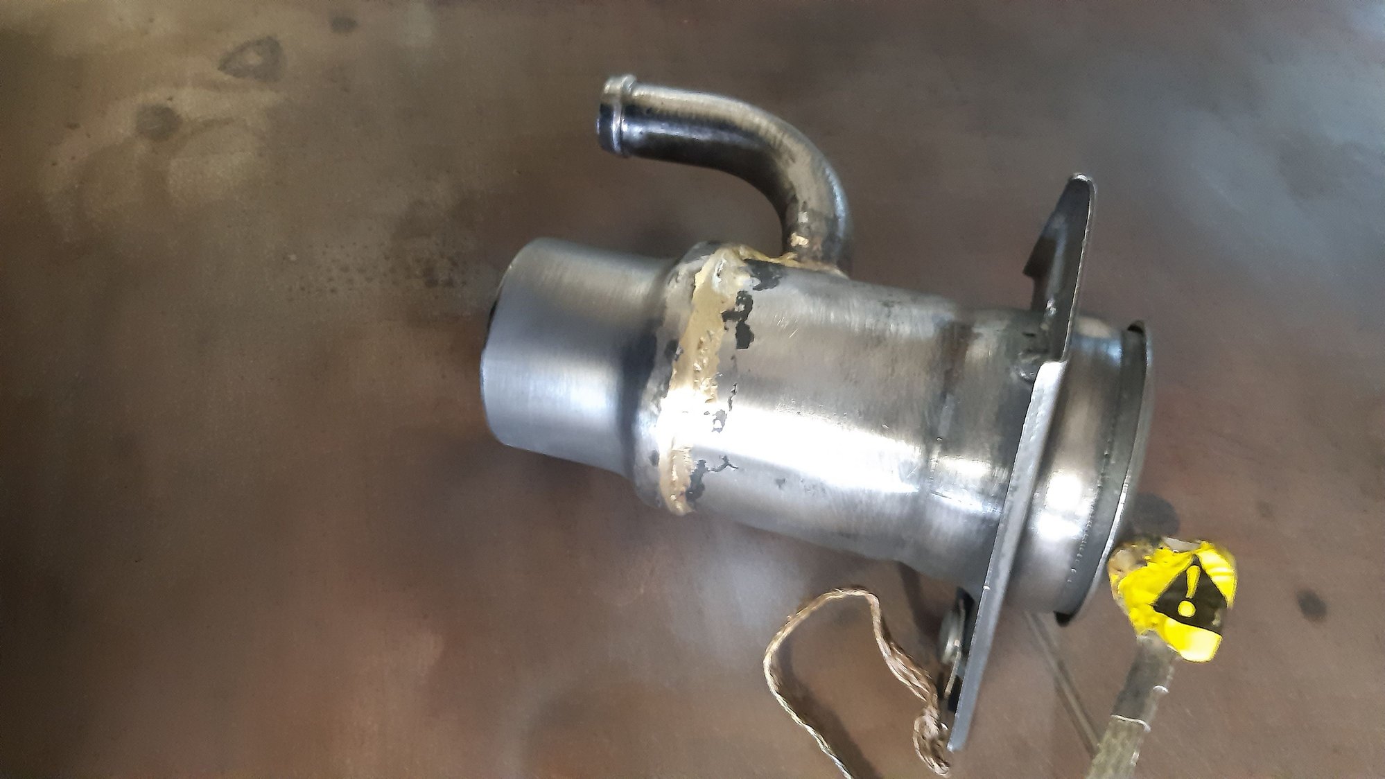

Bought a Fillerneck but the diameter was way bigger than the tube to the tank, so i had to get a reducer. I would have welded the reducer to the tank filler neck, but when I removed the paint from the tank filler neck to be able to weld it, I saw that the breather was soldered on, so I could have damaged the solder seam when welding due to the increased heat. So I had to solder on the reducer... yes, it's been a few years since I last did any hard soldering... not nice but it works.
and
after:

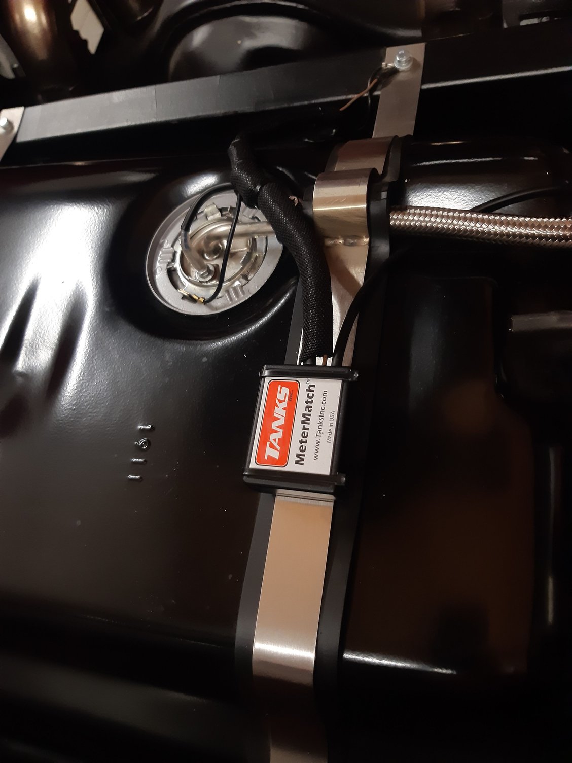

Since I have a Chevy tank with a Chevy Fuelsender, the fuel gauge showed full when the tank was empty and vice versa. After some research, I decided to order the Meter Match from Tanks Inc. I have now calibrated it, wired it up and mounted it here:
It was a little bit tricky to calibrate but it works fine now.
