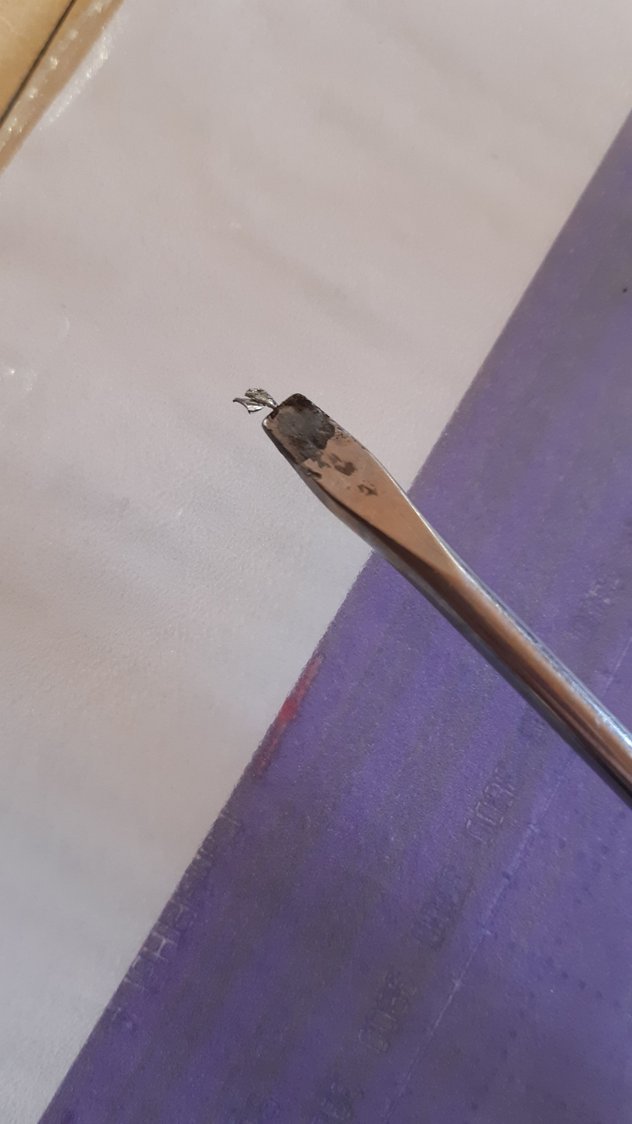

Originally Posted by ingo
In the meantime, I have driven the truck almost 800 miles and assume that the new engine has been broken in.
On Friday morning I drove off in the truck and after a few minutes I noticed an unusual engine noise. I immediately aborted the journey and drove to my garage. At first I feared a main bearing or rod bearing damage, but after listening more closely I assumed that it could be a defective hydraulic lifter. So I removed the valve covers to check this. It seemed to confirm that at least one hydraulic lifter was broken. So I dismantled the intake manifold to be able to remove the tappet.
I then dismantled the tappet and lo and behold... A valve plate was broken inside the tappet.
We still had a good smoked hydraulic tappet left so i just had to order a gasket set for the intake manifold. So I hope to have the engine running again tomorrow.
debris i found between rocker and pushrod
i checked one more lifter but it was okay inside:
Yesterday, I was on the way to a car Show with my Truck when, after accelerating a little harderl, I heard that unusual clacking sound again, just like about a year ago... and lo and behold, another hydraulic lifter has broken. Obviously, low-quality lifters were used here. So now I'm going to order a complete set of new hydraulic lifters.
Guys, what is your experience with hydraulic lifters? Which brand would you recommend?

I have never had a lifter come apart or fail other than wear .

I think his point here is that a failed lifter like you experienced is a rare occurrence. You could choose from any number of name brand parts and should be fine. It's entirely possible you got a cheap offshore copy in a house brand cam kit. Unless you know what brand yours was, you don't know what to avoid.

Sorry I should have worded it differently but you did ask for our experience also . I do run a repair shop and have rebuilt or repaired a number of engines over the years and have never had or heard of a lifter coming apart as yours have . Very curious also that your two lifters were some time apart . Happening immediately would make one think of simple poor manufacturing but yours is odd . Not enough oil flow ?
