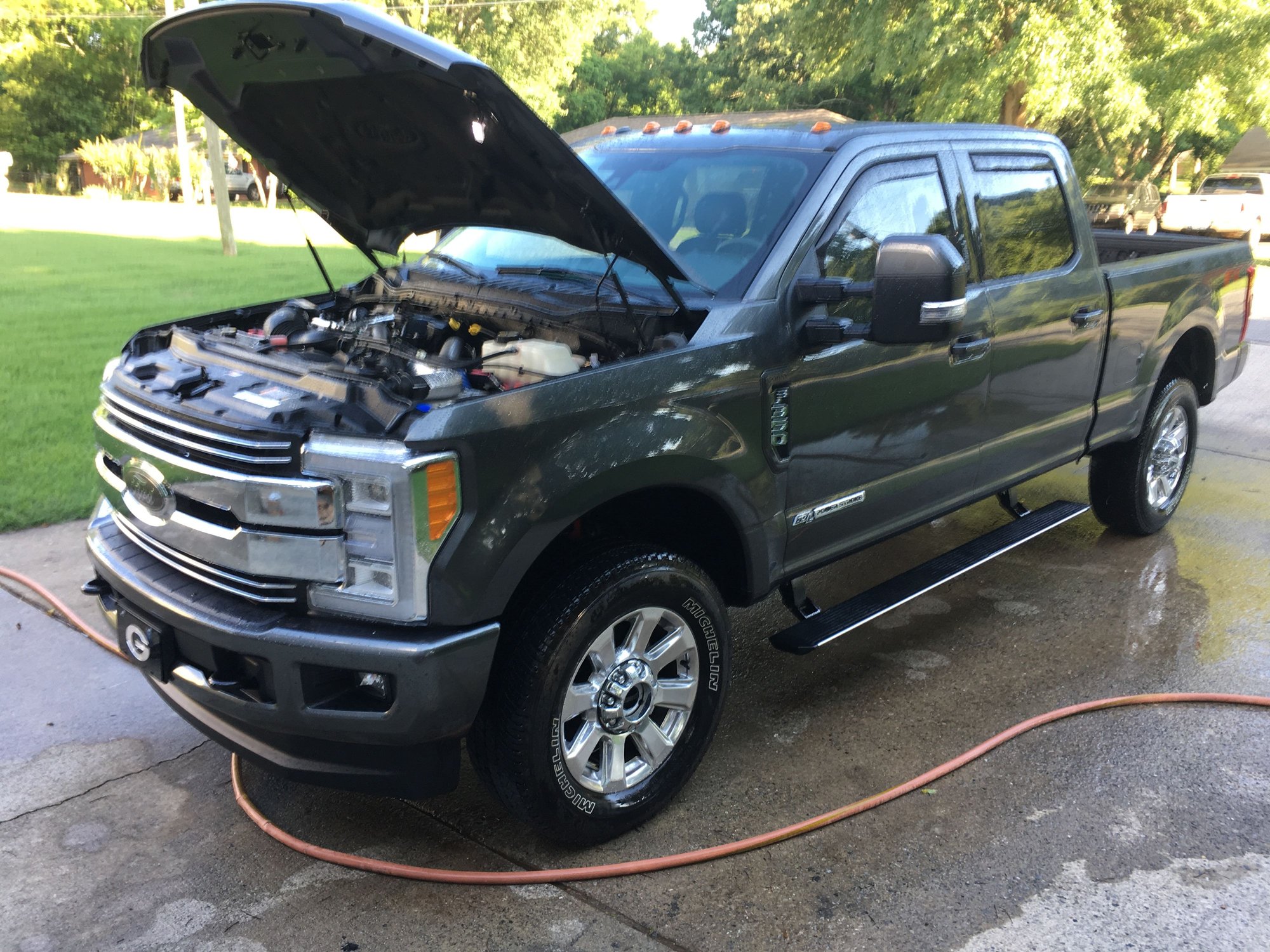

Flashed it last Wed and drove 100 miles this weekend while doing some heavy towing. All is well. There is a few guys running this scenario claiming better throttle response and no more limp mode. We shall see. I've got a No Limit blocker plate kit laying around I may experiment with. Maybe Kubota can chime in as I believe he is running an EGR delete.
Here is the truck working this weekend. 27,100lb GCWR. Pulled like a champ.

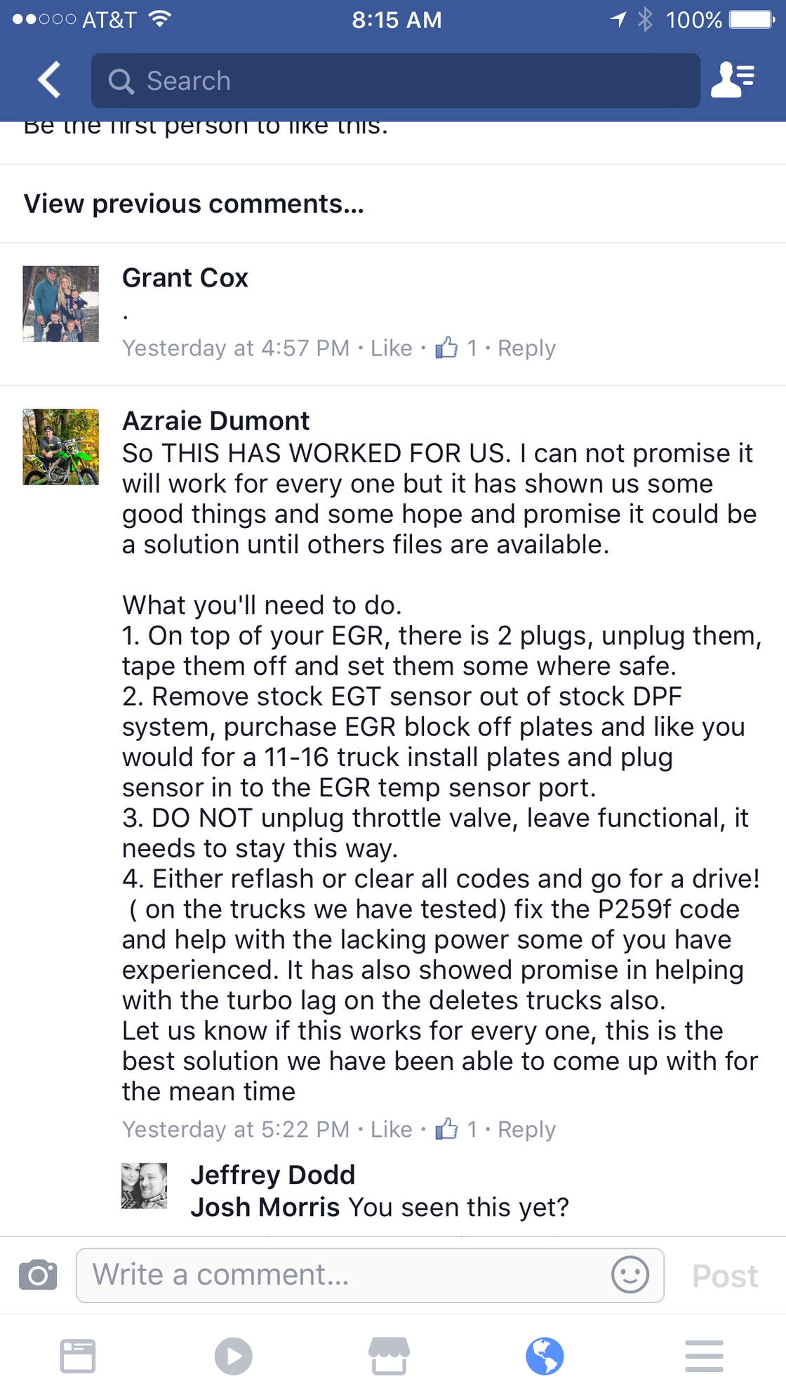

i have been running the to aforementioned egr plugs unplugged for almost 5k miles now. I have never noticed or felt a difference in the way it runs as far as power or throttle response goes.
I used the 1st pyro from the dpf in the blocker plate as mentioned, but when it is plugged up it sends the truck into limp(8 psi boost max) in anything past 1st gear. (no codes were thrown). Took me a few miles of pulling over plugging and unplugging items to troubleshoot that one.
I also found the throttle valve cannot be un plugged(as instructions say) by trial an error early on, it actually throws the code mentioned above and wont boost past 23-24 psi. Hopefully soon the kits will come with instructions that pertain to the 17+ trucks so guys wont have to go thru this. You also do not need the two large hose clamps, nor the coupler that comes in the kits, just eliminate one of the factory t's and you need 3 5/8" hose clamps to reuse the other.

edit, maybe these guys claiming better throttle response and no limp mode have been running around with the throttle plate un plugged?
