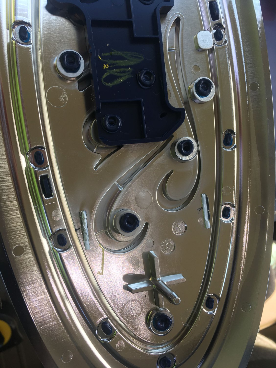

Originally Posted by Karl4Cat
Josh said that the emblem is destroyed when being disassembled for painting...
Correct. You have to break the melted tabs to get them to separate for paint. When done painting, you glue them back together.
For someone wanting camera equipped emblems painted, I would buy a regular emblem, break it down, have it painted. Then when the painted parts came in, take yours off the truck, disassemble camera, break the emblem down and then go back with the painted pieces from the cheaper emblem. Only time it wouldn't work is if you wanted the chrome parts painted also.
That would keep you from buying the expensive camera emblem since the blue parts break down the same on both emblems. Here is a pic of the back of the camera emblem and regular emblem.
