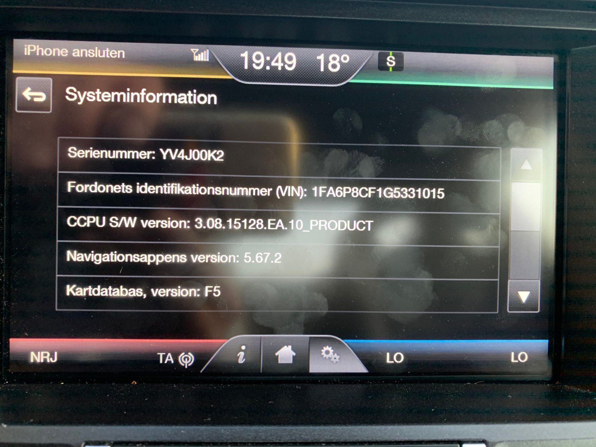

well I hope is same issue I have on my Ride Mustang 2016 its say same thing when I try to update early, I shall try so fast I can, And i liviing in scandinavia and we have same problem !! And when I talk to FORD support they cant help they say its SYNC3 I try to install, and can´t understand why my VIN:nr is located in SYNC updates ... HELLO I told them is SYNC2 update NOT SYNC3 update site...I cross my fingers
What version of Sync are you running.
Go to the about Sync screen in settings.
Screenshot.

I have 308 on SYNC2 and I have on USBmemory with 310 for SYNC2,in early tonight I trying again with installation and thats files in screendump I move to USBMemory, no hint what I an done wrong
OK thanks
Can you also shoot a photo of your actual Sync screen in the truck with the build number.
Can you post the contents of your autoinstall.lst

and I don¨t have install.lst in the rooth, as many ppl talking about ... insted I have install.lst in every filedirectorys
