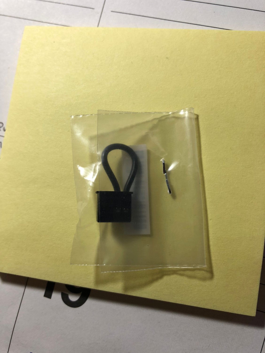

I know I read somewhere that there is a plug in/delete that will allow you to deactivate the exterior (perimeter or shock....don't know which one) alarm after the remote access is installed that seems to be sensitive to passing motorcycles, thunder and other loud noises.
Can anyone shed some light on this?

There should have been a tiny jumper in your kit. It plugs into one of the remaining empty sockets on the VSS. Looks like this:
