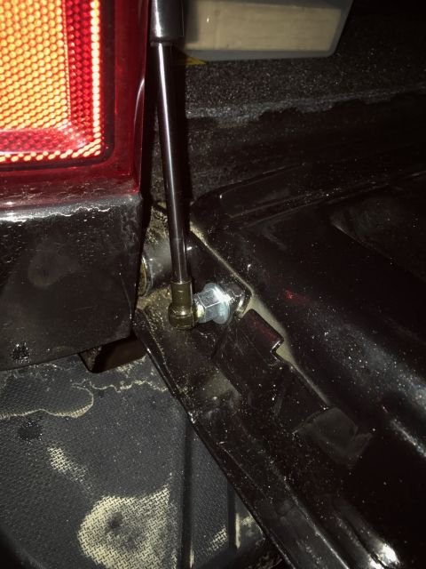

I finally got around to finishing this yesterday, sort of. On the Super Duty tailgate, I was able to tape a wrench to a long screwdriver and get the setup along the side of the tailgate to get the ball mount on with a nut on the backside. I didn't use the one that came with the DeeZee as it was longer than the one I bought. I figured lower profile would have less of an issue of hitting the side of the bed if anything came out. Problem is, you need the extra length so the shock clears the rubber bumper bracket on the side of the tailgate. So I had to take it off. I'll put the DZ one on tonight. But I did get to test it a bit last night, and I cannot wait to have this installed. Tailgate came down so nice and smooth and slow.
Old Mar 28, 2017 | 08:23 AM
  #118
steveg_nh's Avatar
steveg_nh
Joined: Jul 2014
Posts: 337
ya hoo!
All done, and I love it. Installed the DeeZee ball mount with an M8x1.25 nylock nut on the back side. Solid as a rock.
And it works great. Nice slow decent. Not too slow, not too fast. Very happy and happy to not use that stupid nutsert/blind nut.
Here's a pic of the mount installed, and a video of the drop. Now on to the Pop and Lock tailgate power lock install.
