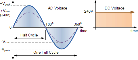

Thank you for the video -- something else I was unaware of about electrical systems. I think my shock with Rusty was 200vAC which really had me confused. I see now he probably meant 200 milivolts -- but again, I wasn't aware that you could get an ac reading -- but it is called an alternator -- I guess for a very practical reason.

My meter was set on a 750v AC scale and the reading was 230.0+ when it cycled up, so yes, 230VAC. You can see it in this thread here: https://www.ford-trucks.com/forums/1...batteries.html Benny made a post from Mercedes that discusses ripple (or AC) current in the charging system. According to that, the only way to accurately see the value is with a scope. I guess the problem with using a multi-meter is the design of its circuitry as far as if it's averaging or RMS by design. If you watch the video I posted my meter has a simulated analog bar along the bottom of the screen and what thats reading generally makes more sense than the numbers. Clearly the numbers are not right. I don't have my head completely wrapped around what is happening with this but I do believe my alternator is failing.

You ain't alone. I have some basic E training and still don't understand how it could read like that. Maybe a few volts but not a few hundred and definitely not with the engine off. It kinda blew my understanding of how things work, that's why I posted the videos.

DMM's do a conversion from analog to digital by sampling.
Sampling rate is just one of the things that go into what your
going to see as far as numbers go. Then there is the algorithm.
Like I said more mud.
