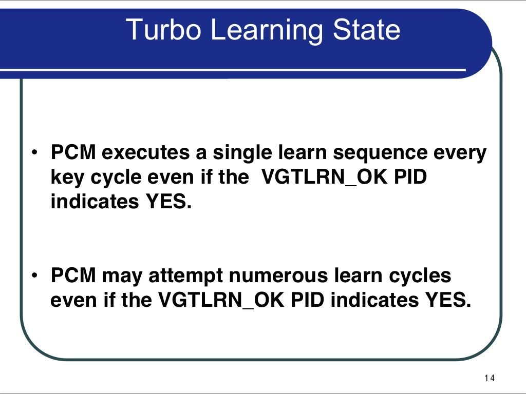

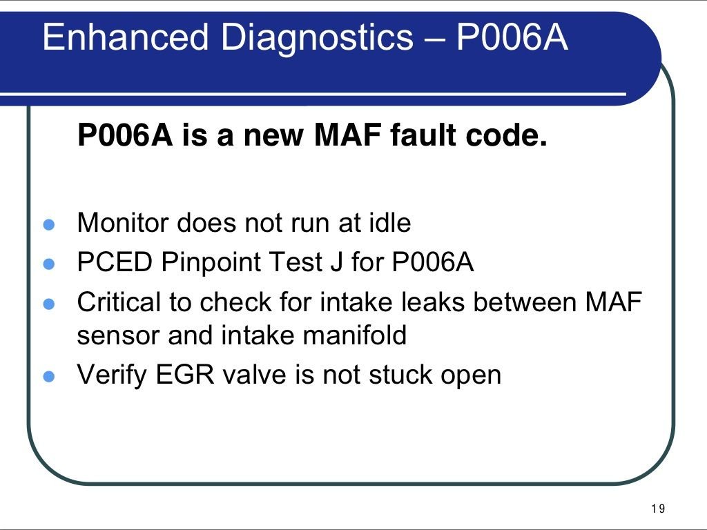

I did find a couple references to p123b (a and c also). Interestingly they were European and on RangeRovers and such and related to map/baro correlation problems. Here's a screen shot of one.

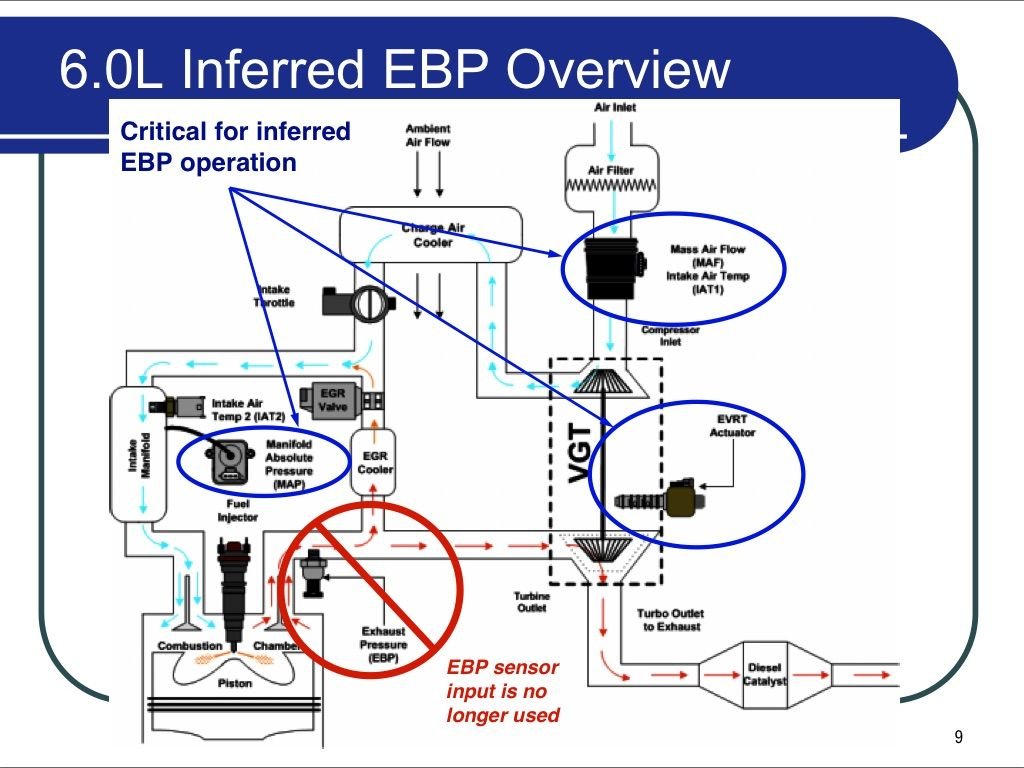

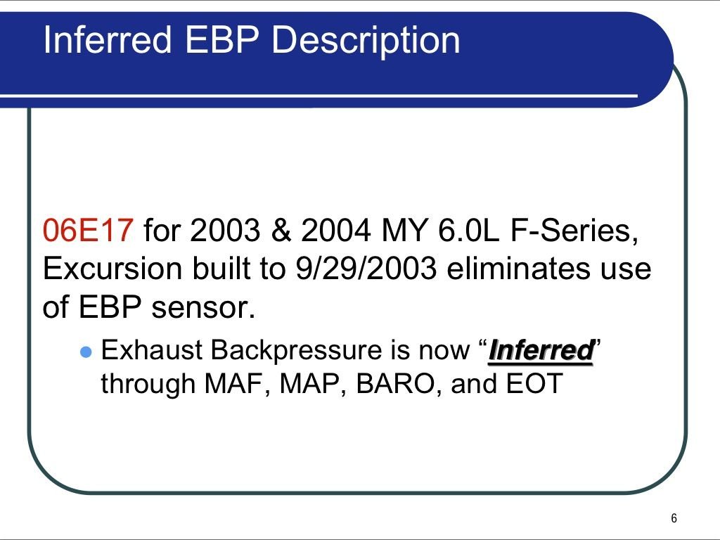

Here's some good info on the inferred EBP strategy.

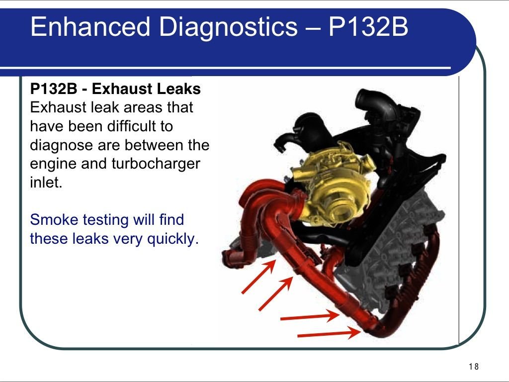

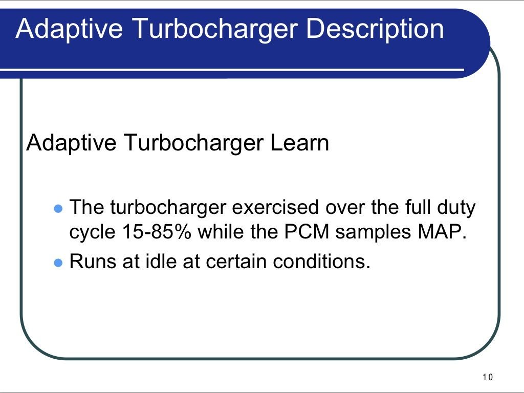

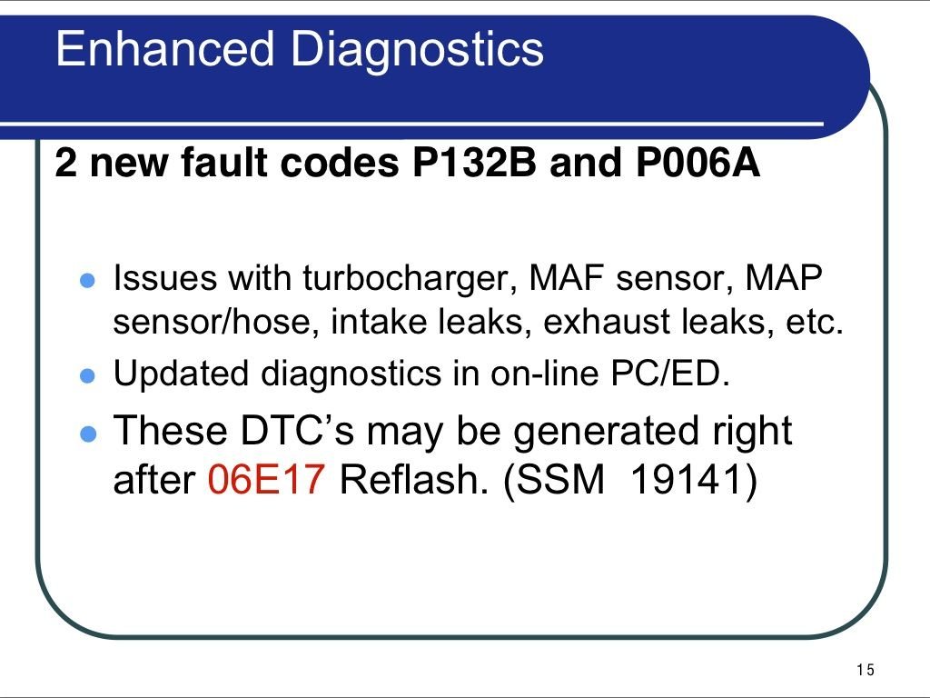

Old Dec 16, 2014 | 09:25 PM
Rusty Axlerod's Avatar
Rusty Axlerod
Joined: Feb 2011
Posts: 8,241
Likes: 155
From: L.A. (Lower Alabama)
Old Dec 16, 2014 | 09:26 PM
Rusty Axlerod
Joined: Feb 2011
Posts: 8,241
Likes: 155
Old Dec 16, 2014 | 09:33 PM
Rusty Axlerod
Joined: Feb 2011
Posts: 8,241
Likes: 155
Crap. Got these out of sequence. (Page 10-11-12-13)
