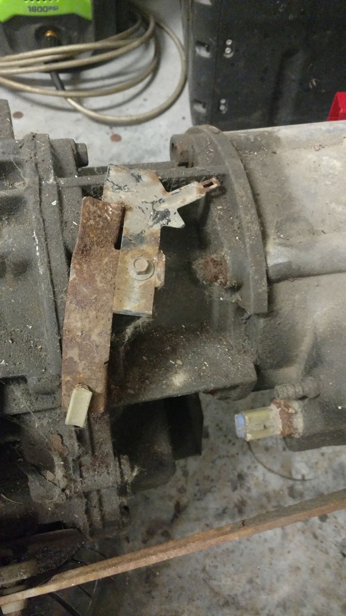

So I'm in the midst of dismantling my donor bronco down to scrap metal currently. Got to looking at the transmission from that next to my 2wd E4OD...
What's to stop me from unbolting the adapter (2nd picture) and swapping it in place of the tail shaft in the first picture?

You can swap them but you need to swap the tailshaft too. It's the first piece installed and last piece removed

So that requires me to disassemble the whole transmission. Guess we aren't doing that.
