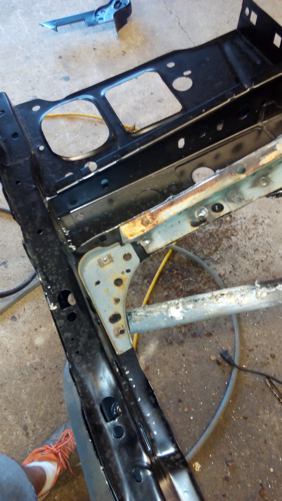

We have to cut the front loose on the old one. Drill the spot welds out

Wind up with the psd center part all on its own.
I measured and cifered. There are holes to line up on the verticals. Name:  IMG_20160904_171549_zpszgw1uqe6.jpg

Clamp it up, mark it, drill holes to plug weld the ol gal all together.

I removed the old upper corner reinforcements and plug welded them in. I also stitch welded around them. Name:  IMG_20160904_184007_zpsy3bqnkq4.jpg
Trim the center opening to match the radius of the reinforcements.

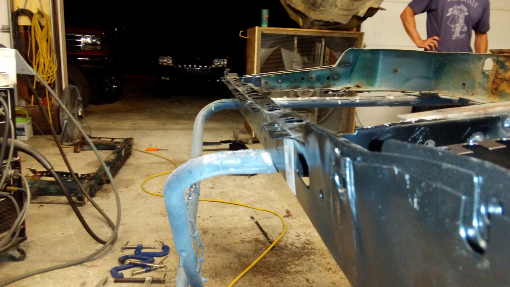

The last thing going is the lip. Gasser's it is horizontal. Psd it is vertical to mount battery cable tube
I c-clamped it with two thick flat bars. I had a buddy hold it down and I broke it over. Bam, 800$. Rad support for 115$ sick it to all these rip offs.
Any questions? I'm not the original person to do this, my idea it was not.
If I can help any one I am up for it Please ask. This took me about 3hrs to complete with, drill, grinder, cut off wheel and basic hand tools. My big special tool was my mig welder and spot weld cutter.

Actually I did it in the afternoon. Just posted later. Too many late nights lately. Need to pull back a bit.
I took what I thought were plenty of pics. After putting it all up I feel like I should have taken twice as many.
I plan to paint the inside of the fenders and rad support today.
