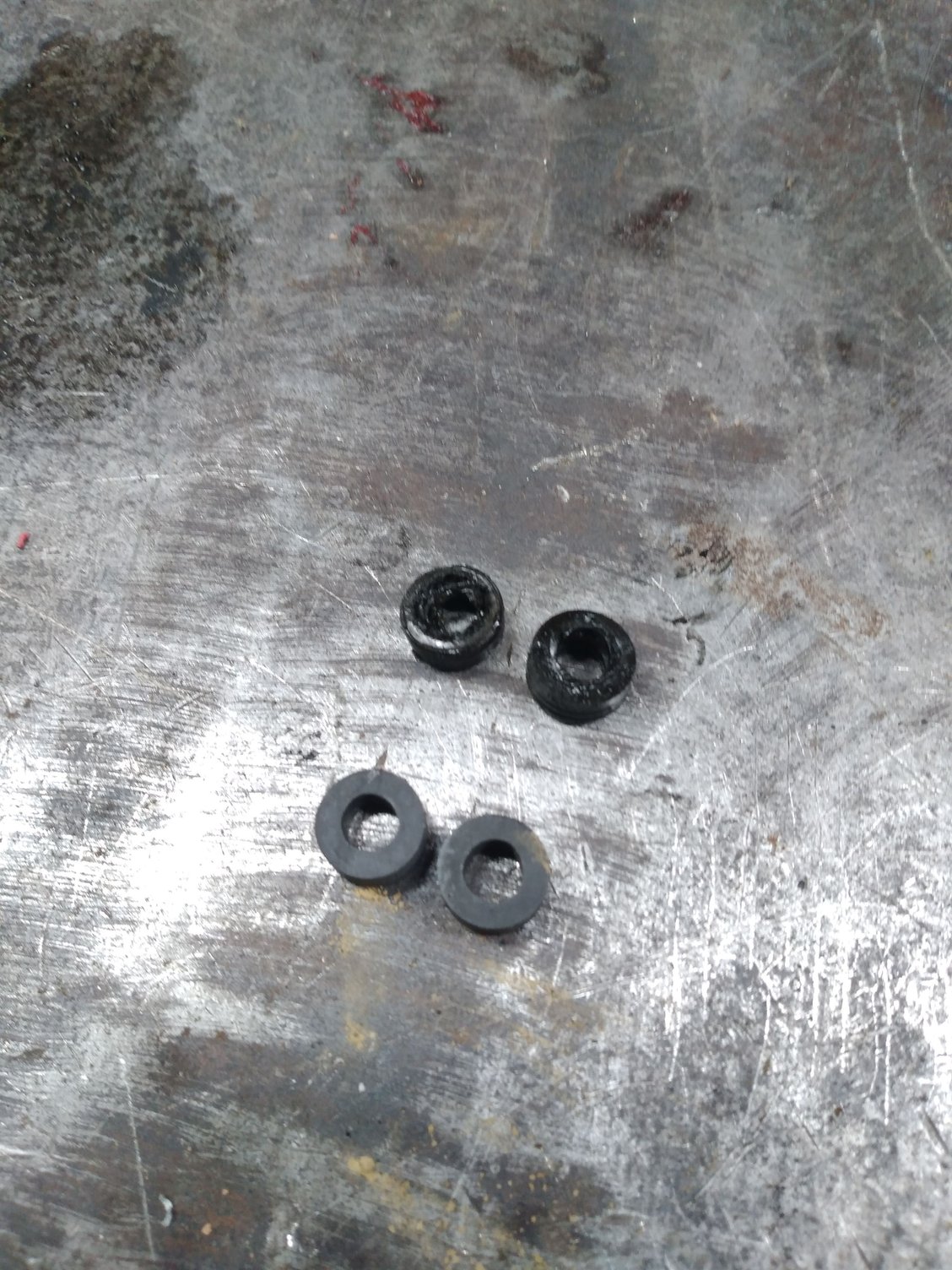

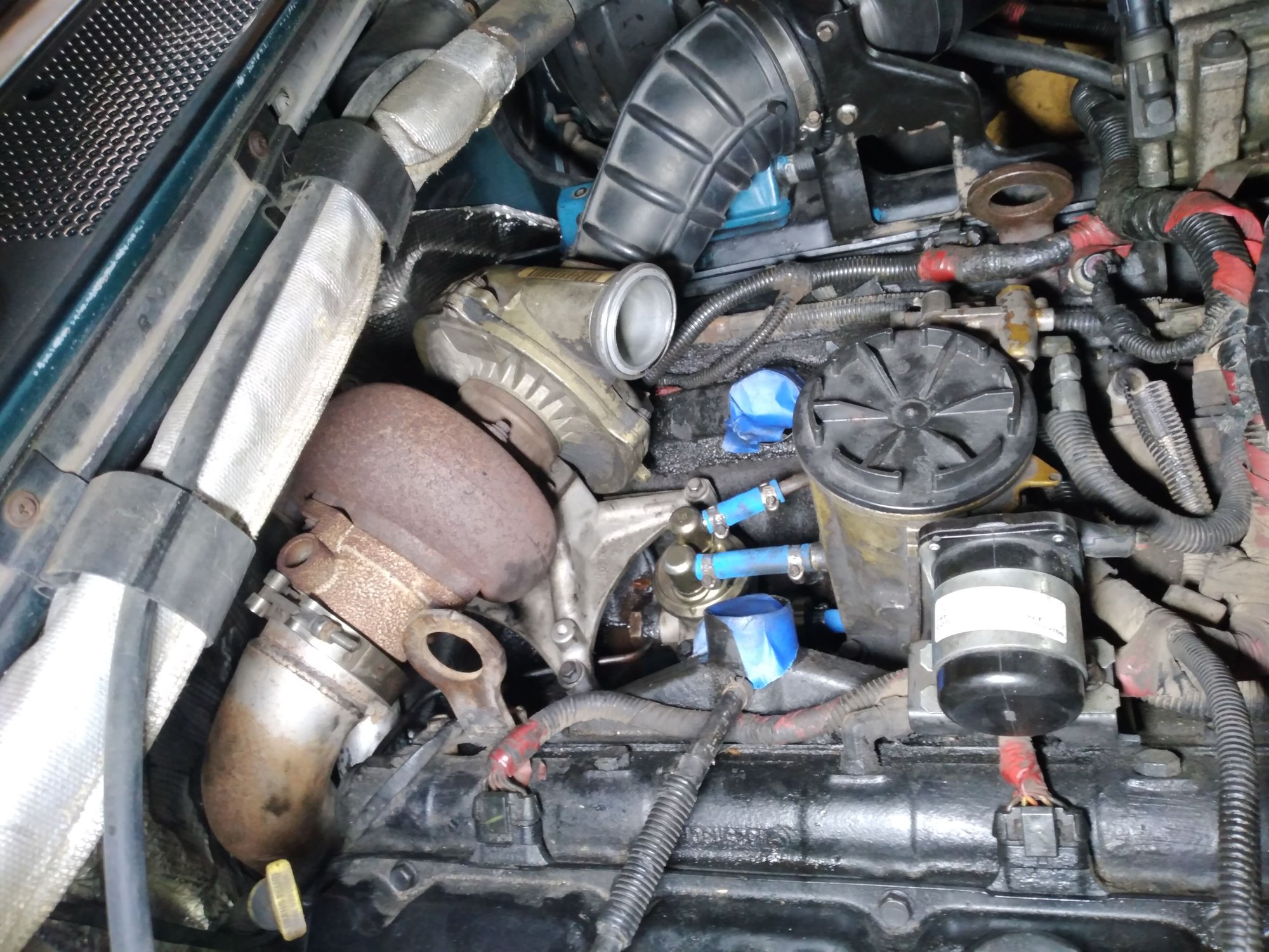

Old fuel pump and filter housing out . Did a lil cleaning then replaced vibra lock seals at heads. Filter hsng installed and ready for next. The IPR pigtail was nasty so I'll grab one after work and he should run again. Woo hoo

I had no idea those Vibra-lock guys were available separate. Rojo had the passenger one weep a hair.
And I feel that pain of three wheels only. I am trying to find the 4.6 cast alu one to put on my 5.4 truck, picked up three for $100. Those will look boss on an older truck like these!

Yea clay sells them. Diesel orings brand. Easy install with just a 9/16 open end wrench.
Yes!! Hope we can both find the 4th lol
