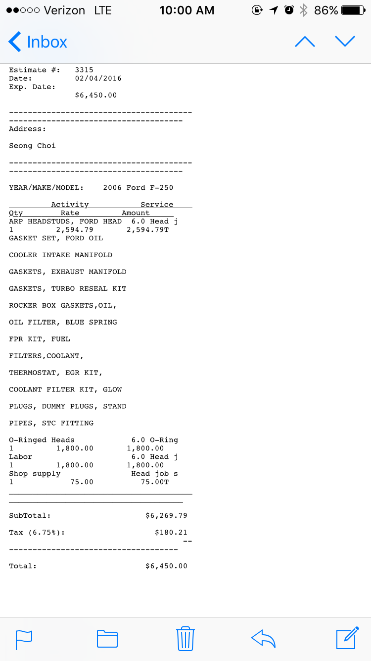

I bled the coolant down completely because I did not want the Restore to be sitting in there. I just left the petcock open at bottom of radiator. I did NOT drain the block.
Been asking around Raleigh NC for quotes preparing for the worst and got $6450 for complete head rework. Some of the things in his quote have already been done so it should be in the upper $5,000. Seem fair? Pay now and just enjoy from now on..
Dude mentioned an o-ringed head where they took a Ford head and reworked it so that head gaskets will no longer be an issue. Comes with 2yr warranty.

Seems reasonable.
If I ever have head gasket issues I'm hoping I can afford to send my heads off to UCF machine shop and have them worked and O-ringed.

Yes, I have had repeat occurrences now. And the large EOT/ECT difference kinda threw a red flag. Also, I puked coolant driving 30 minutes while flushing the cooling system. There is just massive pressure being built up in the cooling system. I took it to a shop yesterday to get diagnostics done. I am NOT doing the o-ring heads. Read too many posts about it not having true benefits for my application.
We are currently looking at $3200 range because I already have a tuner, EGR Delete, etc. I will be adding a coolant filter (no labor charge) and some front end work (loose steering feel).
I am awaiting the final diagnostic/estimate call, and a bit nervous that the head cannot be machined and will need to be replaced or something like that. I am paranoid right now, but I have a basic background on the 6.0 thanks to FTE forum and will be able to shoot down any obvious BS...hopefully.
