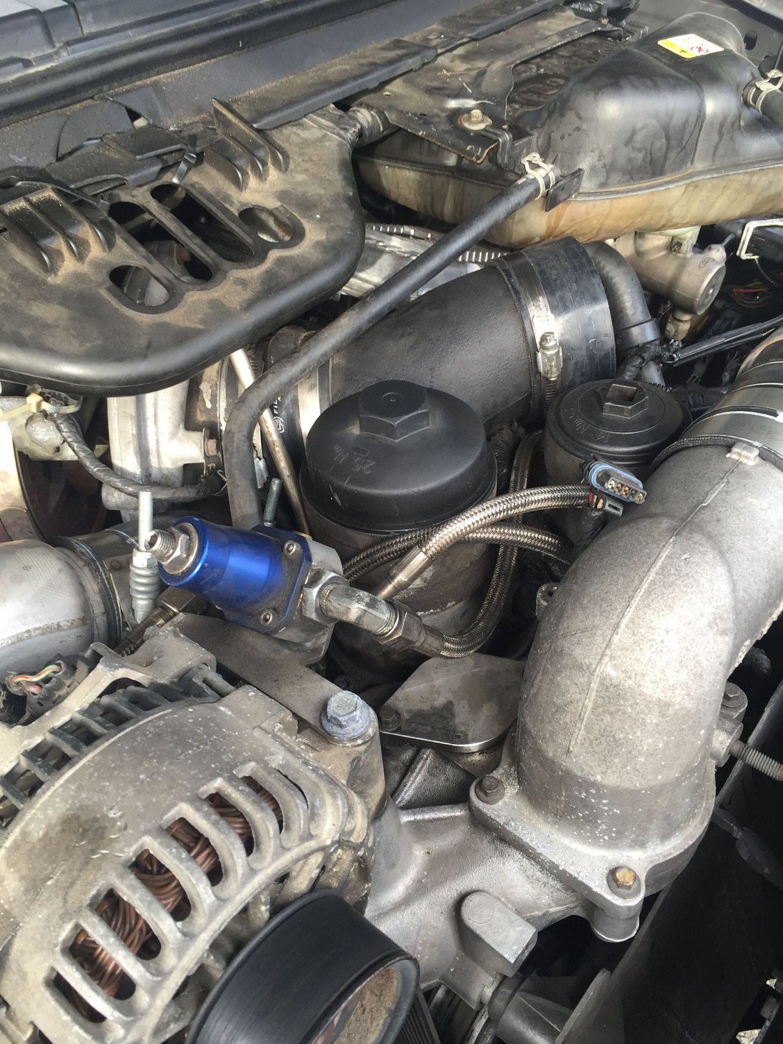

Looks like a regulated fuel return as well
