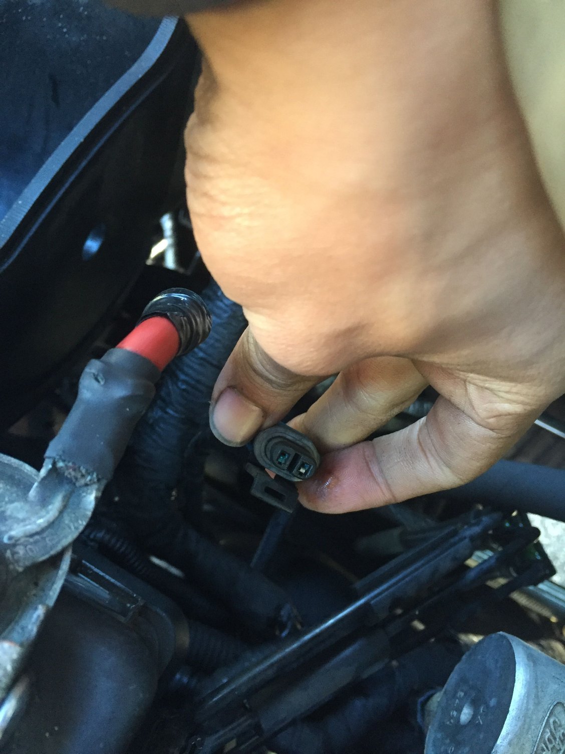

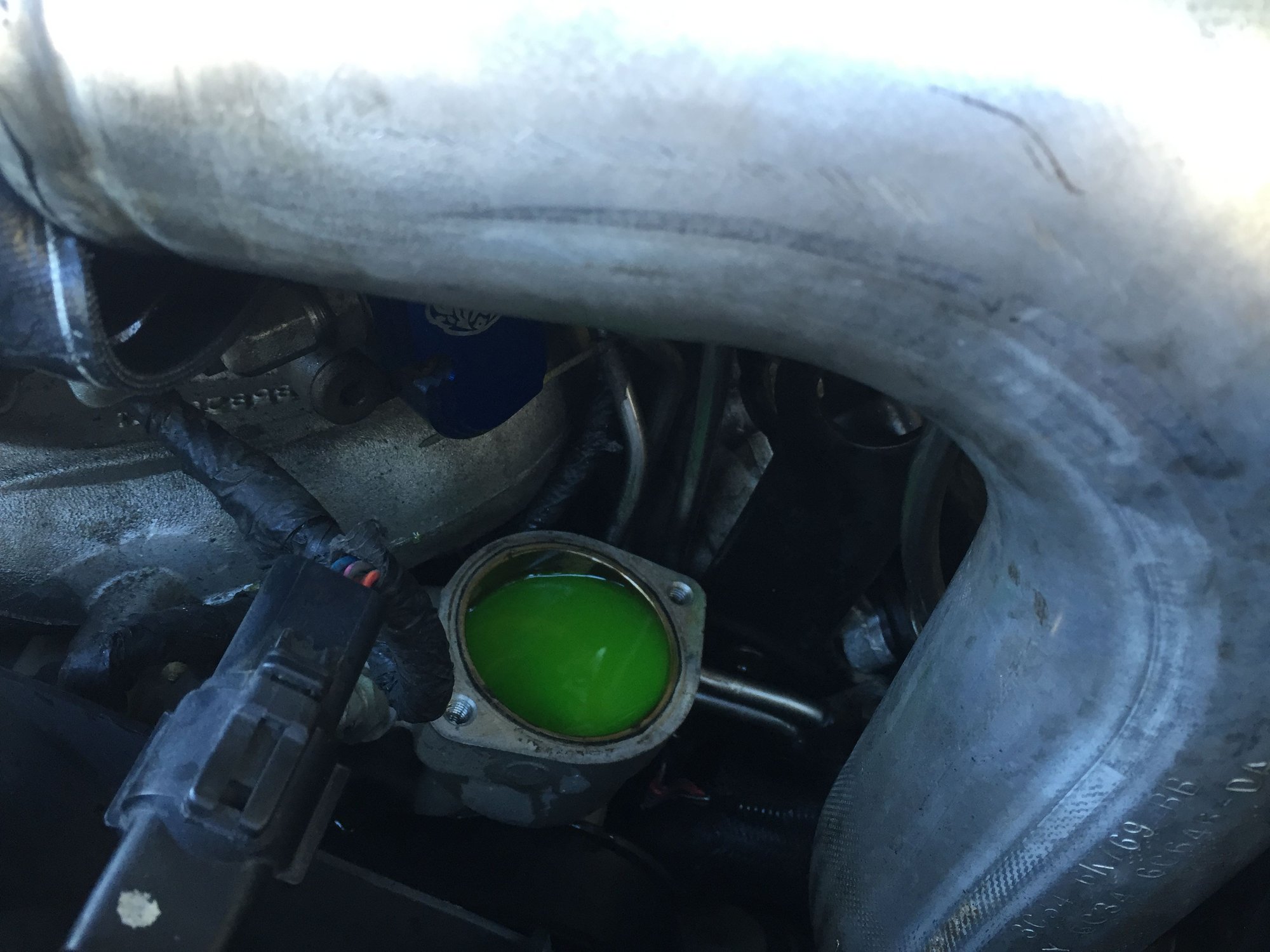

Took thermostat off and that is the 50/50 coolant just sitting there...is that normal? Also, the t-stat looked clean/fine. Doesn't mean it is fine though, right?
There was thick, black fluid in this, very little. Problem?
No idea what this guy goes to...
My poor truck...
I got the EBP sensor off and also took the tube off. Tube was sprayed down with carb cleaner and black fluid flowed a bit. Didnt seem clogged. EBP sensor definitely had coolant pooled up in the connector part. The connector itself seems a daunting task to replace (the harness??) so maybe it is ok?? Wires dont seem damaged.
Thanks so much guys/girls!

That is the wrong coolant you have in their just FYI. Also the thick black fluid is oil and that is normal to have in that tube and CAC.
Thank you so much for the reply! I know the coolant is not right. I am doing a flush once I get it running!
Is it normal for the coolant to just sit pooled up there?
