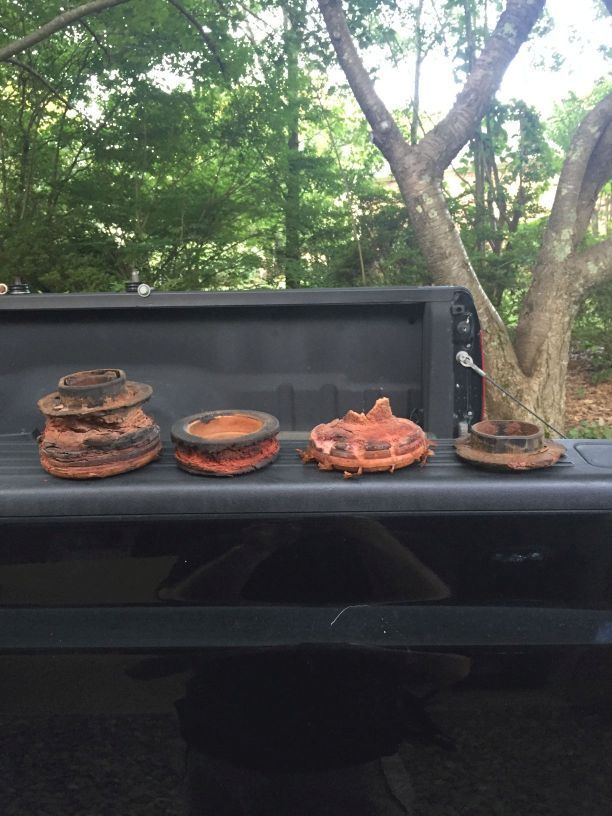

I finally changed them! After further inspection I decided to replace them all. The OEM ones I had cost me alittle over $250. They were just the fronts, rears and hardware. I went with the daystar kit which replaces ALL 8, cost $145. No hardware but the original parts were in fine condition to reuse.
A few notes on the job:
1) The whole job took me about 5 hours. It really wasn't that bad
2) Do yourself a favor and remove the front bumper. Makes it so much easier and it takes literally 5 min to do
3) You will need to completely remove the rear seat from the truck
4) As mentioned the ones in the very front by the radiator are the worst. I cut the rubber off this bushing and used a huge pair of channel locks on it while my father in law hit the bolt with a impact gun. Unfortunately in my case the passenger side would not come loose. I have to cut it off and replace the hardware as well. Just ordered the parts today.
5) For the others, I didn't make or use any type of puller or tool. I screwed the bolt in a few turns and tapped it on the top with sledge. My truck has almost 0 rust so this my not work for others.
The majority of guys give the daystar kit excellent reviews. I haven't ridden in the truck yet since I installed them but I will report back. Now for the pics....... I'm pretty sure ANYTHING will be an improvement over these......
If you have any questions or need more details feel free to ask.
These are from behind the rear seat
These are the ones by your feet
These are the centers
